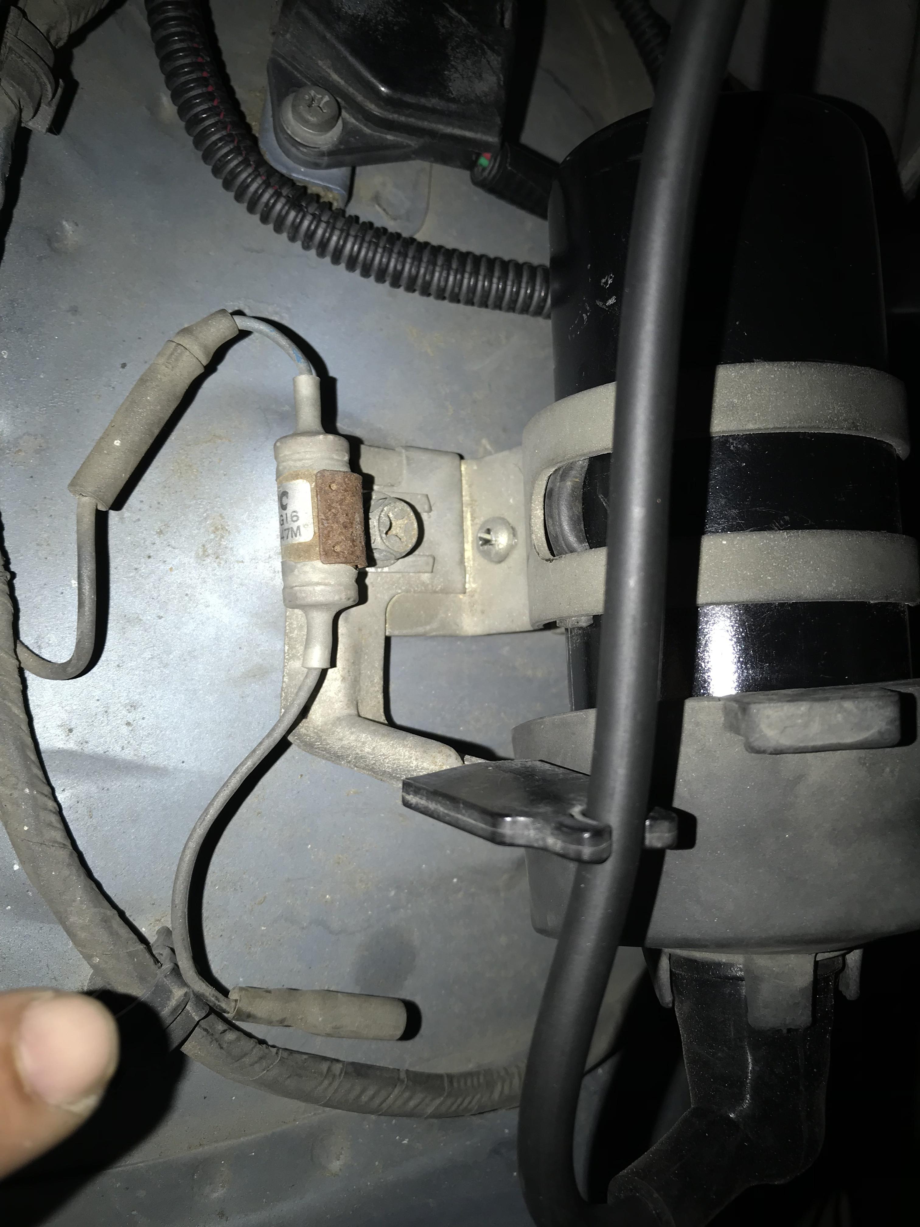

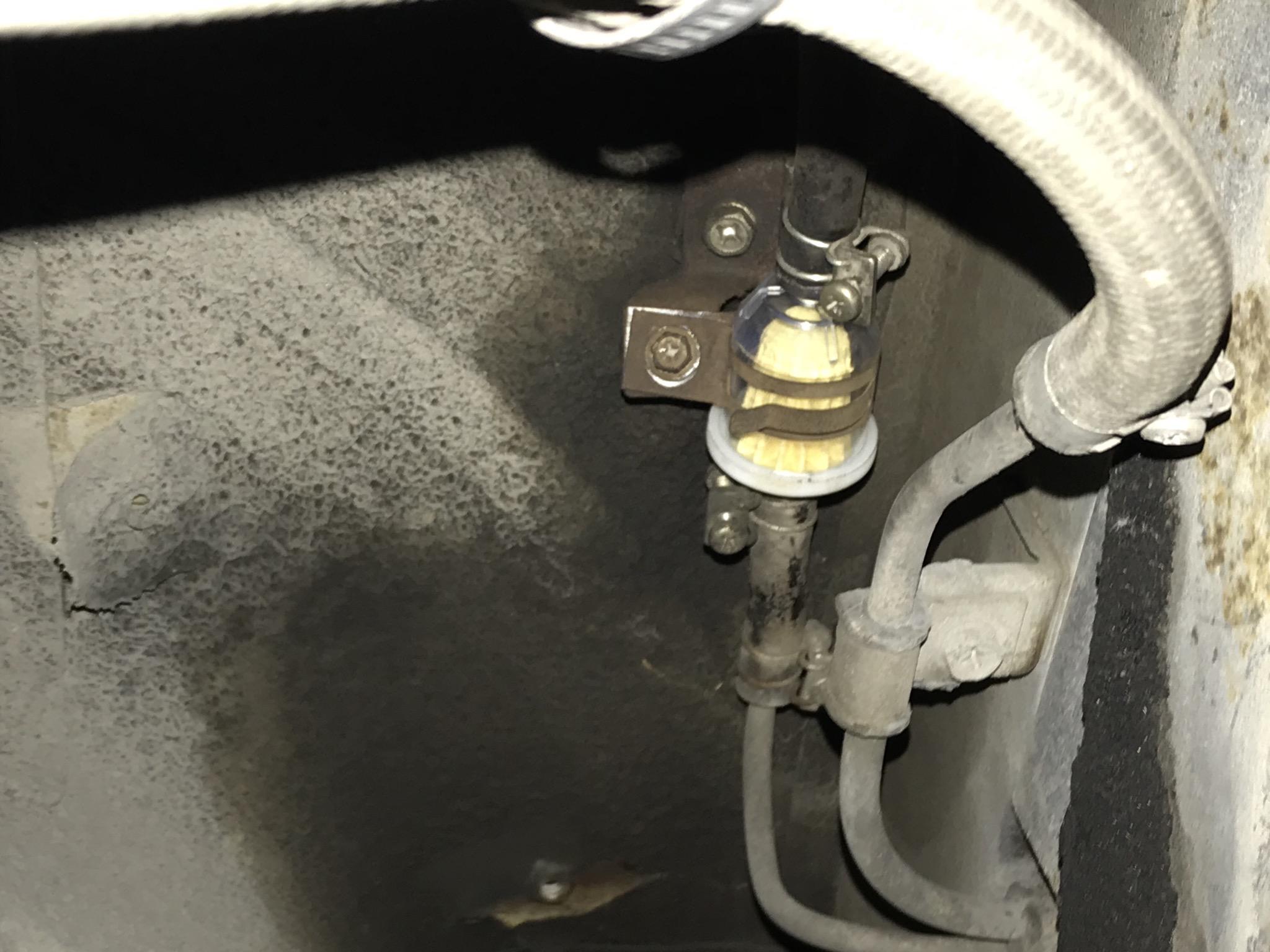

hello Av8ferg,
thank you for taking the time guving me advice.. i have drained the fuel twice now off the tank and it was clean .. i did replace the fuel filter .. and i opened up the old filter and it was also clean..
is that a factory filter? between the tank and the pump?
i noticed a small filter above the fuel pump.. it might be on the return line.. is that also a filter?
i know the dampner is different..
but theres 3 items underneath around the tank.. 1. fuel pump, 2. a black filter looking might be on the return line and 3. the dampner...
thanks!
