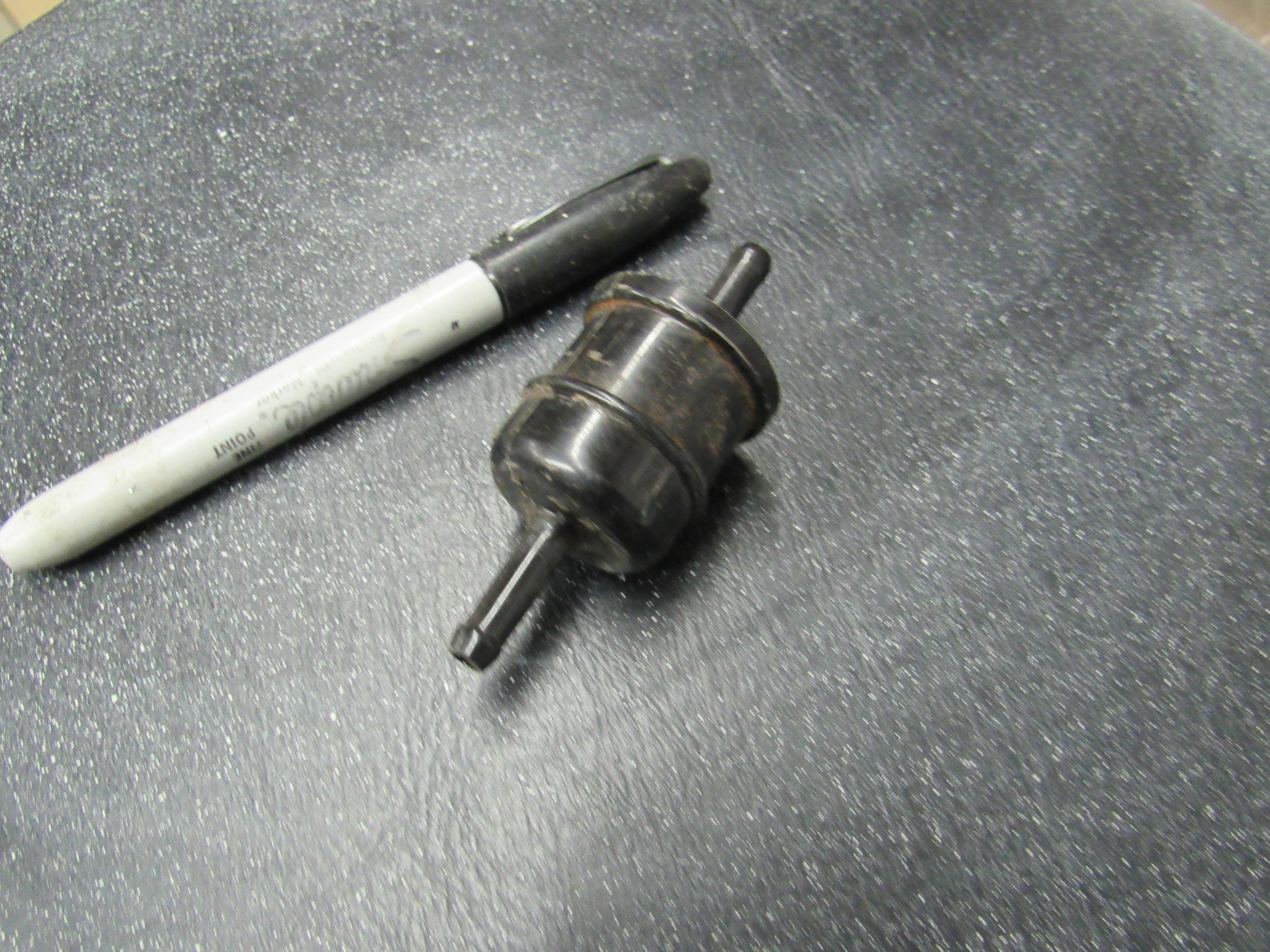

Posted February 19, 20196 yr comment_568841 Hello, I have a 1978 280z and i noticed this filter looking mounted underneath the car by the fuel pump.. when i disconnect the lines nothing comes out .. and the filter looks brand spanking new and it seems like nothing is going through it.. the filter doesnt look OEM but the mounting points look OEM.. Link to comment https://www.classiczcars.com/forums/topic/61634-1978-280z-what-is-this-filter-looking-in-fuel-line/ Share on other sites More sharing options...
February 19, 20196 yr comment_568849 Figure out where the line is connected. There is a supply line, a return line, and a vent line. The filter looks like it is on a smaller line than the one next to it. It might be on the vent line. p.s. you have too many threads going on too many different forums for me. Too chaotic and unfocused. Good luck. Edited February 19, 20196 yr by Zed Head Link to comment https://www.classiczcars.com/forums/topic/61634-1978-280z-what-is-this-filter-looking-in-fuel-line/#findComment-568849 Share on other sites More sharing options...

February 20, 20196 yr Author comment_568875 30 minutes ago, grannyknot said: But this where @Captain Obvious jumps in and sets us both straight, most of my 280z knowledge comes directly from Bruce. so is it normal that nothing leaks when i disconnect the lines of the filter i showed? also why is it mounted in the rear if its a pulse damper? and i cant to seem to find who sells this item.. can i just remove it? or leave it alone? Edited February 20, 20196 yr by cclxxxz Link to comment https://www.classiczcars.com/forums/topic/61634-1978-280z-what-is-this-filter-looking-in-fuel-line/#findComment-568875 Share on other sites More sharing options...
February 20, 20196 yr comment_568881 Fuel Link to comment https://www.classiczcars.com/forums/topic/61634-1978-280z-what-is-this-filter-looking-in-fuel-line/#findComment-568881 Share on other sites More sharing options...
February 20, 20196 yr comment_568882 Vapor vent Link to comment https://www.classiczcars.com/forums/topic/61634-1978-280z-what-is-this-filter-looking-in-fuel-line/#findComment-568882 Share on other sites More sharing options...
February 20, 20196 yr Author comment_568885 24 minutes ago, Zed Head said: Vapor vent thank you zed! i guess leaving that filter there for now is okay until i find one.. thank you! Link to comment https://www.classiczcars.com/forums/topic/61634-1978-280z-what-is-this-filter-looking-in-fuel-line/#findComment-568885 Share on other sites More sharing options...

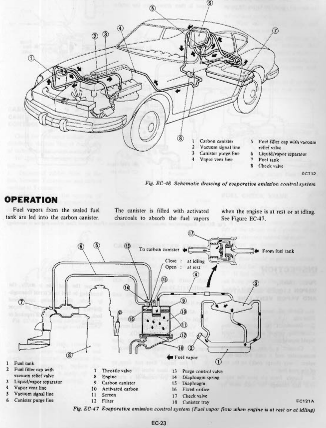

February 20, 20196 yr comment_568886 Captain O kind of explains that check valve in post #11 here. Link to comment https://www.classiczcars.com/forums/topic/61634-1978-280z-what-is-this-filter-looking-in-fuel-line/#findComment-568886 Share on other sites More sharing options...
February 20, 20196 yr Author comment_568888 24 minutes ago, gwri8 said: Captain O kind of explains that check valve in post #11 here. thank you that helps alot! i would have to find one until then i think the filter on mine would just be fine.. Link to comment https://www.classiczcars.com/forums/topic/61634-1978-280z-what-is-this-filter-looking-in-fuel-line/#findComment-568888 Share on other sites More sharing options...
February 20, 20196 yr Author comment_568893 https://www.ebay.com/itm/Newly-6mm-Aluminium-Inline-Check-Valve-Fuel-Diesel-Gas-Liquid-One-Way-Non-Ret-ST/163226705309?_trkparms=aid%3D555018%26algo%3DPL.SIM%26ao%3D1%26asc%3D20180306143914%26meid%3Deea6676cf6514bc5b48ca51dde69b3ad%26pid%3D100935%26rk%3D3%26rkt%3D12%26sd%3D282897263275%26itm%3D163226705309&_trksid=p2349624.c100935.m2460 i cant find an alternative.. would this work? Link to comment https://www.classiczcars.com/forums/topic/61634-1978-280z-what-is-this-filter-looking-in-fuel-line/#findComment-568893 Share on other sites More sharing options...
