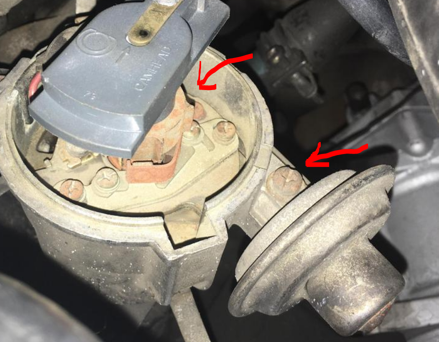

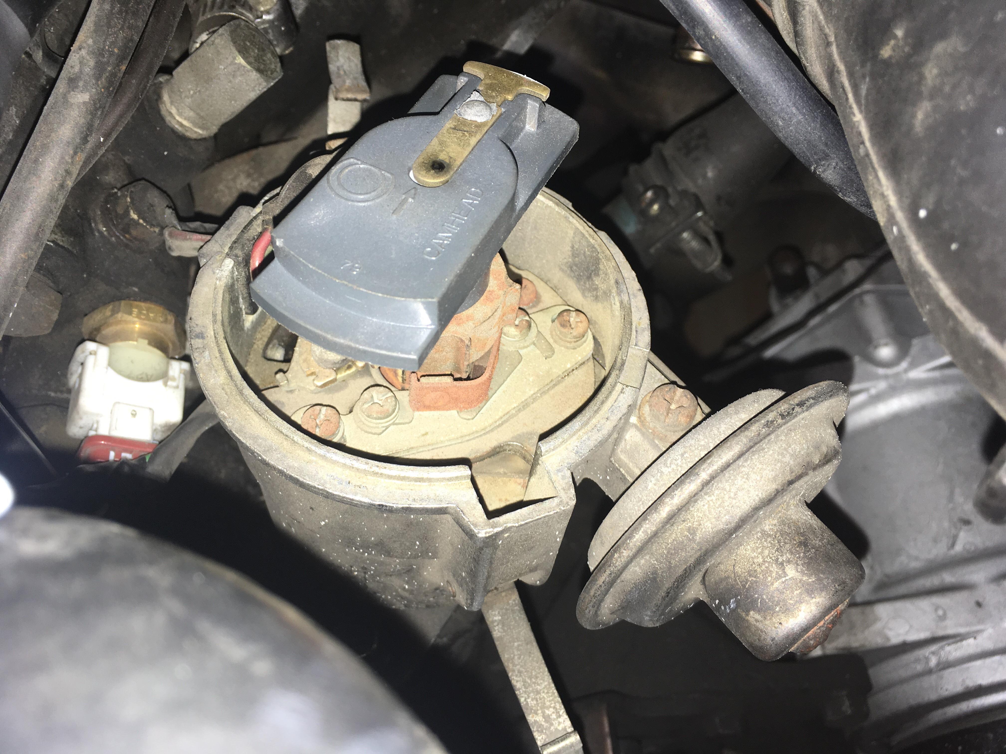

February 21, 20196 yr Author comment_569051 So I just popped the cap off the dizzy, here in here am i supposed to wiggle my finger to test movement? Link to comment https://www.classiczcars.com/forums/topic/61644-repair-distributor-vacuum-advance-pot/?&page=3#findComment-569051 Share on other sites More sharing options...
February 22, 20196 yr comment_569057 If you remove the big screw you should be able to carefully wiggle the canister free and very carefully pull it out slightly. As you move it the plate with all of the screws in it should rotate. Be very careful, if it doesn't move easily don't force it. The bearings are in a plastic cage that often breaks. OR. You can twist the pate with all of the screws in it in the direction of the vacuum canister. The rod should goin to the canister as the plate moves. OR. You can remove the tiny screw that holds the end of the rod on to the plate, then the big screw that holds the canister, and just remove the whole canister. Then twist the plate by hand. OR. You can do the above, then remove the whole distributor and remove the breaker plate, and look through the sides for rust. Loosen the big screw first, it's usually very tight. Sometimes so tight it takes drastic measures. BUT. There's a lot of rust visible there. I'd be surprised if your bearings aren't already rusty. They might be salvageable. You probably haven't had vacuum advance for a while. If I had that in front of me, I'd loosen the big screw while it's mounted then take the distributor out and go through it. Take the breaker plate out, check the mechanical advance, and the breaker plate bearings. Disassembly is shown in the FSM. Link to comment https://www.classiczcars.com/forums/topic/61644-repair-distributor-vacuum-advance-pot/?&page=3#findComment-569057 Share on other sites More sharing options...
February 22, 20196 yr comment_569059 18 minutes ago, Zed Head said: I'd be surprised if your bearings aren't already rusty. Yeah there is a lot of rust in there. If it were me I would take it apart and clean it up, lube it, etc. Too much rust IMO. Link to comment https://www.classiczcars.com/forums/topic/61644-repair-distributor-vacuum-advance-pot/?&page=3#findComment-569059 Share on other sites More sharing options...
February 22, 20196 yr Author comment_569121 Thanks for all the information guys! Won't taking the distributor apart really mess with the timing of the engine/create big problems if I do/reinstall something wrong? Link to comment https://www.classiczcars.com/forums/topic/61644-repair-distributor-vacuum-advance-pot/?&page=3#findComment-569121 Share on other sites More sharing options...
