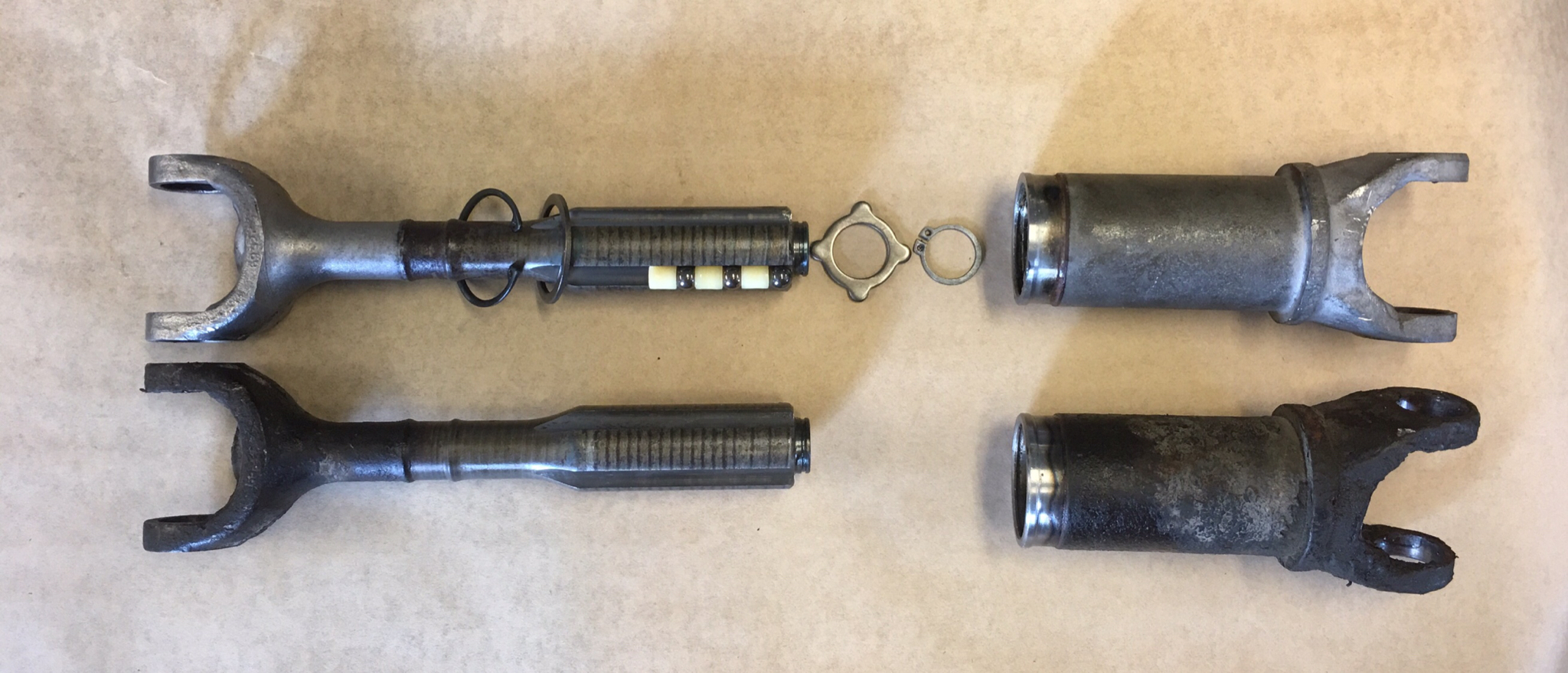

February 24, 20196 yr comment_569278 Over time the half shafts can seem to have less range of motion due to the packing of the grease in the shafts. I documented the disassembly and the myth busting of various sized half shafts. They are all the same. Take them apart, clean them and reassemble. Very straightforward. Link to comment https://www.classiczcars.com/forums/topic/61658-r180-half-shaft-dislodged-from-differential/?&page=2#findComment-569278 Share on other sites More sharing options...
February 24, 20196 yr Author comment_569279 Many thanks.. I remember following that thread, don't know why i didn't access it earlier. I'm going to get started after I help the kid with her homework. Sunday is my Saturday. Link to comment https://www.classiczcars.com/forums/topic/61658-r180-half-shaft-dislodged-from-differential/?&page=2#findComment-569279 Share on other sites More sharing options...
