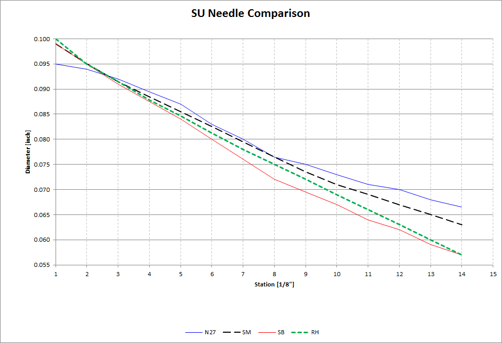

Am going to order the RH needles for comparison purposes, and possibly lean out a few spots in the range.
Yeah, sorry I couldn't help you out with the RH needles. Good luck with the tinkering, and keep us posted!
Short story for the rest of the forum... I went looking for my RH needles that I thought I had and only came up with just ONE instead of two. Not much help there!   :facepalm:
I installed a set of RH needles and they ran lean (16 to 17 APR) on WOT on numerous test runs. Went back to SB needles.
There are a few rich spots on the SB needles (cruise is around 13.5), so dropped the needle shoulder down so even with bottom of piston. This kept the WOT numbers on target (13 to 13.5) and the cruise numbers are closer to 14. Will test further, but pleased so far!
