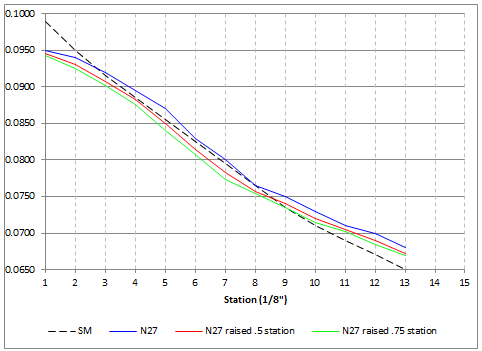

July 9, 20195 yr comment_579279 You can push the stock N47 deeper into the piston to enrich the whole range: Link to comment https://www.classiczcars.com/forums/topic/61679-sb-needles-to-resolve-lean-wot-with-sus/?&page=6#findComment-579279 Share on other sites More sharing options...
July 11, 20195 yr comment_579368 Forgive my ignorance - I have to ask to learn: how does pushing the needles up differ from dropping the jets? With my limited knowledge, I would have said that it’s changing the annulus area akin to winding down the jets, but is there something special going on when you move needles instead of jets? Link to comment https://www.classiczcars.com/forums/topic/61679-sb-needles-to-resolve-lean-wot-with-sus/?&page=6#findComment-579368 Share on other sites More sharing options...
July 11, 20195 yr comment_579373 The ring annulus change is the same whether you drop jet or raise needle. The location of the annulus from the carb throat where the venturi pulls fuel through it, and from the top of the fuel differs. It will probably be the same effect as you point out. Link to comment https://www.classiczcars.com/forums/topic/61679-sb-needles-to-resolve-lean-wot-with-sus/?&page=6#findComment-579373 Share on other sites More sharing options...
July 11, 20195 yr comment_579385 Altering the fuel level is another parameter for tuning a/f ratio. Link to comment https://www.classiczcars.com/forums/topic/61679-sb-needles-to-resolve-lean-wot-with-sus/?&page=6#findComment-579385 Share on other sites More sharing options...
