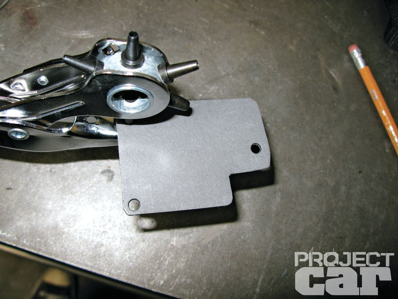

The gasket is easy... just use you box of cornflakes and cut a rectangle to fit the area. Use a paper punch or hole punch (or drill) to make the two holes (one for oil and one for bolt).  They can be same diameter. Trim any loose paper (xacto/file/sand paper). Coat with sealant and you are done.
Aviation sealant?  Is there another name for this? If I go to Oreilly will they know what I’m talking about?  I think I’ll use gasket material, wont’ cardboard break down with oil?
