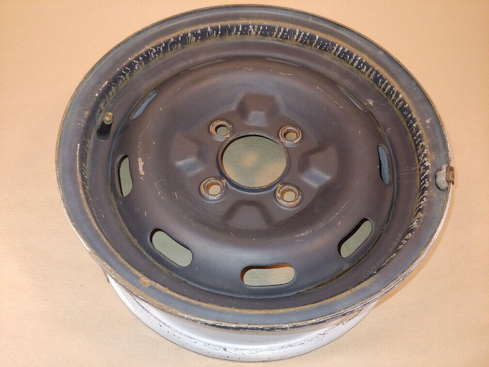

that paint colour on the face seems to be a close match to that of the tail light garnish from the #162 and the original spare from the 72 that was on hand as well, which I referred to as "chalkboard black". Rustoleum actually makes a chalkboard black colour which is close, but it is not meant for exterior applications or road vehicle use as it's not very durable against the elements.
I never dismounted the tire as it was 5" as you noted and did not match the 4.5"s from the 69 cars under restoration, so I am unsure if it was over sprayed as shown in the photo above, but it wouldn't surprise me. They probably just had these stacked 6 or 7 high against a wall and just sprayed the fronts liberally with the same paint they sprayed the tail light garnishes and just churned them out. There was another item that was sprayed the same colour. I can't quite recall, but I want to say on the 162 car it was the front radiator grille that was clearly the same colour as the tail light garnish. I'd have to check photos to be sure.

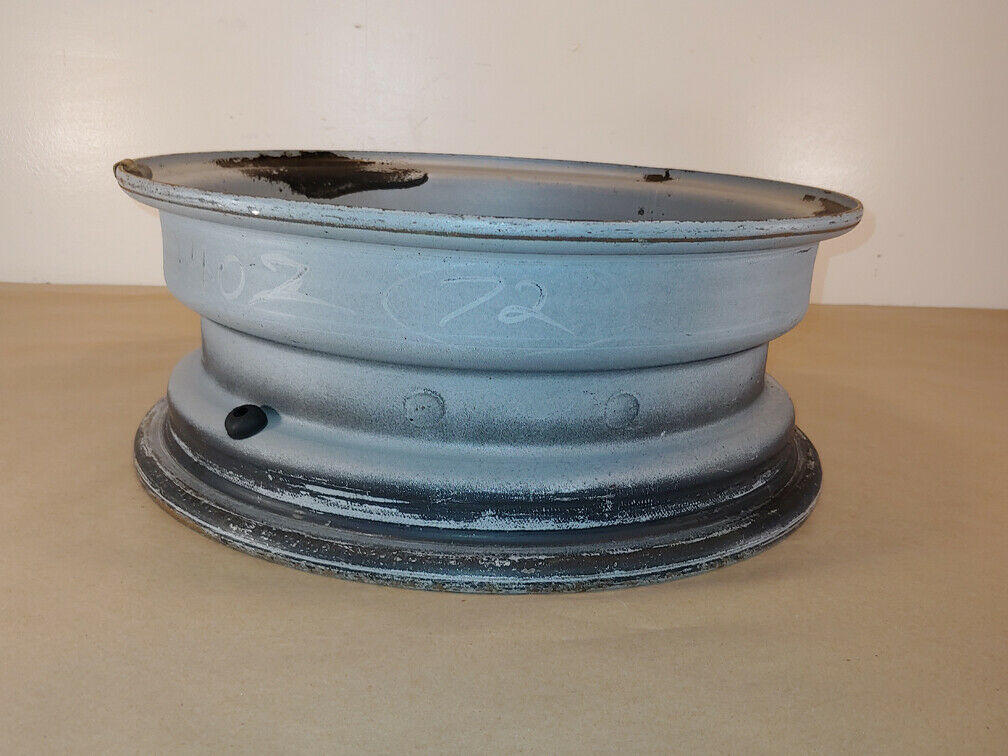

I'm not sure if it's just the whitebalance on the photo,  but on the side view, the base wheel colour looks quite "cool" like a generic gray primer you'd see today, but on the top/down view it looks more like Alumiblast.
I think they used a primer that was closer to aluminum colour than it was to actual gray primer... it would have looked really unfinished if it was just primer. I think they would have rather sprayed the entire wheel black if that was the case to avoid poor feedback on overall finish of the cars.
