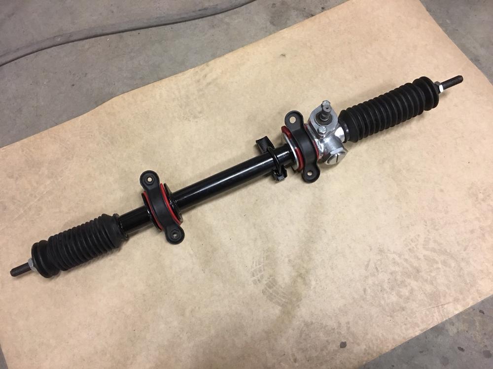

Posted March 7, 20196 yr comment_570291 Hi there, Got to change my left inner tie rod...the one that's seems to be disrupted. Heard of getting a right one + right side rod and installing all this on the left side. Just wondering if anybody have validated an alternate part from ZX or other that may suit. Thanks for support. Seb Link to comment https://www.classiczcars.com/forums/topic/61754-inner-tie-rod-alternatives-for-z/ Share on other sites More sharing options...

March 7, 20196 yr comment_570315 As I understand it, the left hand thread side is unobtanium and you need to replace with the newer right right style o inner and outer. I used this as an excuse to get Techno Toy Tuning outers and newer right right inners. Link to comment https://www.classiczcars.com/forums/topic/61754-inner-tie-rod-alternatives-for-z/#findComment-570315 Share on other sites More sharing options...

March 8, 20196 yr Author comment_570433 On 3/7/2019 at 10:23 PM, wheee! said: As I understand it, the left hand thread side is unobtanium and you need to replace with the newer right right style o inner and outer. I used this as an excuse to get Techno Toy Tuning outers and newer right right inners. I saw the at 200 $ at TTTuning... ouch!!! Link to comment https://www.classiczcars.com/forums/topic/61754-inner-tie-rod-alternatives-for-z/#findComment-570433 Share on other sites More sharing options...

March 9, 20196 yr comment_570542 Have to dig it up, but I bought a new (not reman) rack with inner tie rods from an outfit on ebay couple of years back. It was ~$275 USD back then. Why hunt for $200 parts? Oh yes, their ebay name is carsteering https://www.ebay.ca/usr/carsteering?_trksid=p2057872.m2749.l2754 Or https://www.jegs.com/i/Rare+Parts/202/RP26575/10002/-1 Link to comment https://www.classiczcars.com/forums/topic/61754-inner-tie-rod-alternatives-for-z/#findComment-570542 Share on other sites More sharing options...
March 10, 20196 yr Author comment_570608 20 hours ago, zKars said: Have to dig it up, but I bought a new (not reman) rack with inner tie rods from an outfit on ebay couple of years back. It was ~$275 USD back then. Why hunt for $200 parts? Oh yes, their ebay name is carsteering https://www.ebay.ca/usr/carsteering?_trksid=p2057872.m2749.l2754 Or https://www.jegs.com/i/Rare+Parts/202/RP26575/10002/-1 Thanks! Got in touch with the guy on ebay. Link to comment https://www.classiczcars.com/forums/topic/61754-inner-tie-rod-alternatives-for-z/#findComment-570608 Share on other sites More sharing options...
March 10, 20196 yr Author comment_570611 available on amazon, carsteering.com... Require the 2 right tie rod end trick... Link to comment https://www.classiczcars.com/forums/topic/61754-inner-tie-rod-alternatives-for-z/#findComment-570611 Share on other sites More sharing options...
