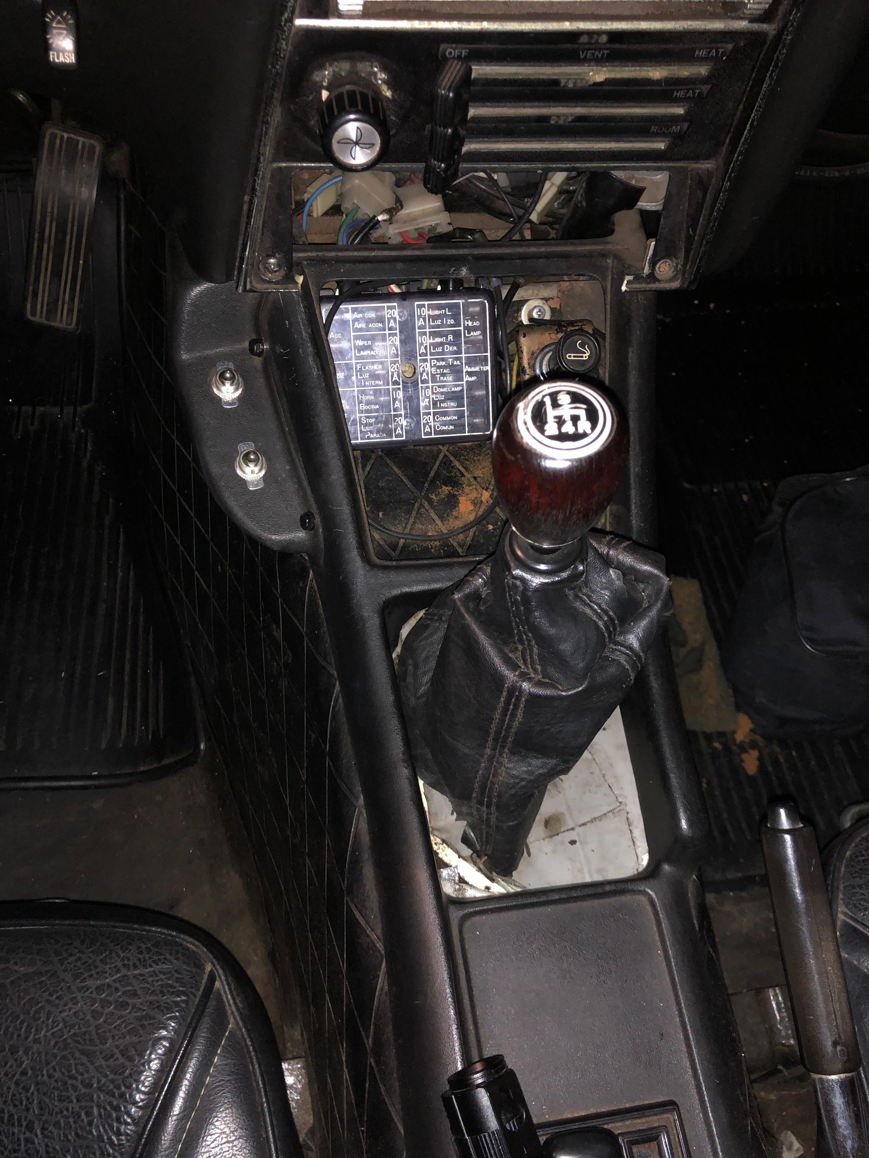

Post a picture of the console to get confirmation

Is that white material original?  I doesn't look like it.  It's a tough plastic material I think they added instead of an inner and outer boot.
To make things right, I believe I'll need the inner boot, outer boot, six clips, and a new leather boot.  Are the clips used to secure just the rubber outer boot, or does it secure the rubber and leather to the frame.  Any pics you may have are appreciated.

The pic may not help as I don't have the center console removed yet.  Interestingly, I thing the original boot is still on the car, but it's in bad shape.IMG_1527.thumb.jpeg.bf33e3712a34539c9e708a172fdf2dba.jpeg
I have never seen material that looks Like that on the many early cars I have worked I on. My first 71 the outer shift boot was vinyl and did have a off white netting attached on the back side. You can purchase both vinyl or leather reproductions. Attaching it is pretty straight forward.

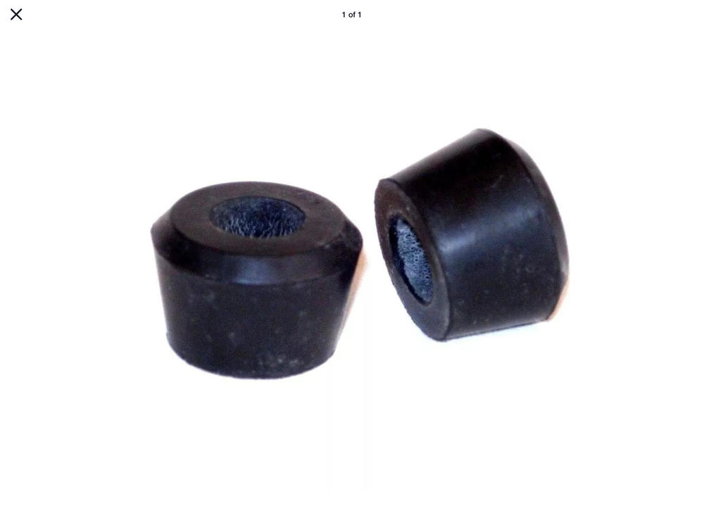

Here are the bushings you need for the “A” type transmission that you have. Search for Datsun 510, there more people supplying them for their “A” type trans that is the same (shifter mount at least) as the early Z trans. Found these on ebay.

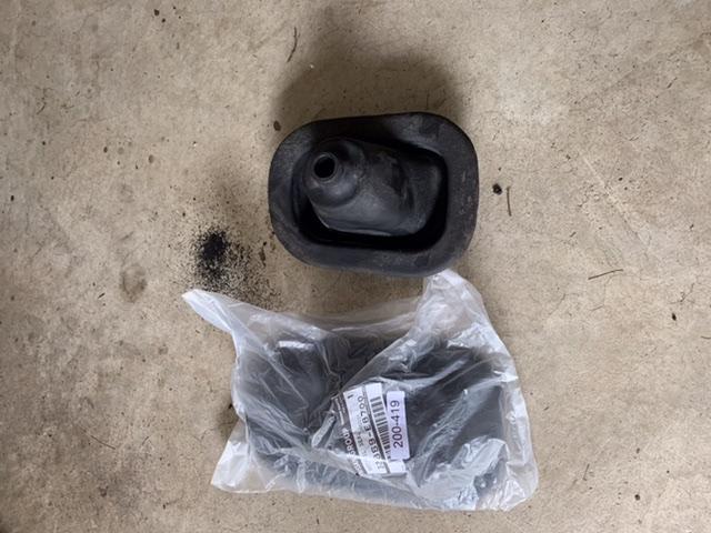

This is the shift boot you need, that fits the trans tunnel. It has a groove that fits on the trans tunnel cut out.

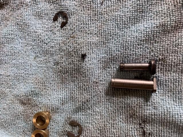

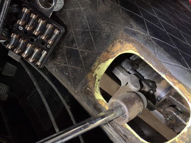

Thanks for the prompt responses!  @siteunseen, that looks like a different set up than the “dog leg” shifter that’s in my car.  The pin in mine is smaller and doesn’t seem to have enough room for bushings at all.  Thinking I’ve got an older transmission but I am new to this scene and have a lot to learn.
@zKars as it turns out my shifter boot is in really good condition, it is just like the one in the pics you sent. Does the bushing in the top pic belong on the bottom of the shifter?  Mine has a hard plastic bushing just above the lock nut. My nomenclature is terrible, I’ll get the manual so I can better describe what I’m talking about.   I took it all apart to install the parts , got disappointed when NOTHING matched and put it back together so I can’t get any better pics at the moment.

do not buy the metal ones on EBay you will hate the feeling . Be careful when you tighten the nut the chrome on on the shifter will mar easily.. the lever should be straight not dog legged. Let me know if you need photos
