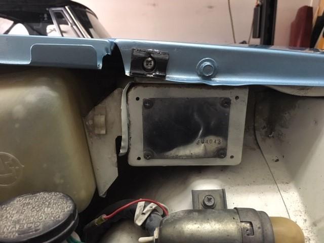

Posted March 8, 20196 yr comment_570397 My 280z has an engine bay id tag that I have never seen in any other 1978. The tag has the vin# of the car stamped into it and nothing else. The dash vin #, firewall and door jam all match. Late 78's did not have the engine #'s on the engine bay tag but again, never have seen one that just has the vin stamped on it and nothing else. Anybody know why this car has this? Link to comment https://www.classiczcars.com/forums/topic/61767-odd-engine-bay-id-tag/ Share on other sites More sharing options...
March 8, 20196 yr comment_570399 Could be a different front clip. Is the rest of the engine bay white? Link to comment https://www.classiczcars.com/forums/topic/61767-odd-engine-bay-id-tag/#findComment-570399 Share on other sites More sharing options...
March 8, 20196 yr Author comment_570425 The car was originally white. I just painted it light metallic blue and have not gotten to painting the engine bay. The vin on the engine tag and the vin on the firewall, dash and door jam all match up. Link to comment https://www.classiczcars.com/forums/topic/61767-odd-engine-bay-id-tag/#findComment-570425 Share on other sites More sharing options...
March 8, 20196 yr comment_570427 I'm pretty sure the black writing on the tags is a painted on stencil. Aggressive cleaning with harsh a substance can remove all the black paint leaving just the stamped numbers. Just a possibility. I learned this when trying to clean some overspray off of one, and found the cleaner I was using was starting to take the writing off as well. Link to comment https://www.classiczcars.com/forums/topic/61767-odd-engine-bay-id-tag/#findComment-570427 Share on other sites More sharing options...
March 8, 20196 yr comment_570434 1 hour ago, Terrapin Z said: I'm pretty sure the black writing on the tags is a painted on stencil. Aggressive cleaning with harsh a substance can remove all the black paint leaving just the stamped numbers. Just a possibility. I learned this when trying to clean some overspray off of one, and found the cleaner I was using was starting to take the writing off as well. I agree with Terrapin Z - someone used some aggressive cleaning techniques and removed the printed image. Similar process as a stencil - but screen printed. I *thought* you could get reproduction plates from zcarsource and/or Banzai, but both offer 240 plates while Banzai also offers a plate for the 260. So, ya got a couple options: a) Live with it, as it is (or tell a fisherman's story of how your ID plate is custom - note, this only works with someone that hasn't seen a Z) b) see if Banzai will pursue a reproduction tag for the 280's (you might have to pay for the up front costs) c) scan a good ID plate, and reprint that image onto your tag by: using a clear film as a sticker print directly on the plate using a suitable 3D printer and media screen-print it on (see option b) Probably another option, but I can't think of one now Link to comment https://www.classiczcars.com/forums/topic/61767-odd-engine-bay-id-tag/#findComment-570434 Share on other sites More sharing options...
March 8, 20196 yr Author comment_570435 I never thought of that! Good call. I looked at an original tag and that is exactly where the vin is engraved. I think that is the answer. Thanks Link to comment https://www.classiczcars.com/forums/topic/61767-odd-engine-bay-id-tag/#findComment-570435 Share on other sites More sharing options...
