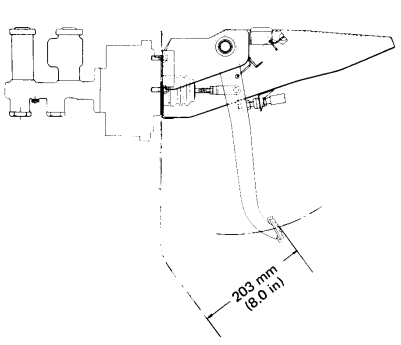

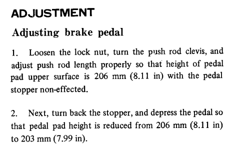

March 17, 20196 yr comment_571144 Is the throw of the push rod from the pedal correct? Link to comment https://www.classiczcars.com/forums/topic/61778-brake-problems-still/?&page=3#findComment-571144 Share on other sites More sharing options...
