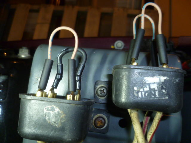

I had the camera handy, so I took some additional pics. Here's the correct position for the links on the 77-78. This time I took the pic from the angle that everyone likes. As it's shown in the FSM:

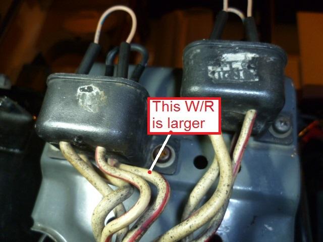

And here's a pic that (although it's hard to tell), you can actually see that one of the White/Red wires is larger than the other three. That's the position that gets the largest (black) fusible link. The W/R wire gauge is larger to account for the higher current that circuit can potentially carry. Who knows... Since the blocks are just screwed to the fender well, maybe some of them have been switched around? So if you're looking for a way to definitively determine which location gets the largest fusible link, you can check the wire gauge sizes:

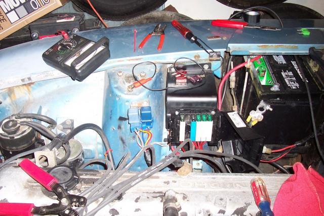

Call it what you want.... I've got 2 (well, one now since I used a slot for my headlight relay feed) spare +12V fused feeds that I don't have to tap off the battery. No gremlins and no maintenance. Nothing about this screams 'bling'.
  • Haha 1
2 hours ago, wal280z said:
Call it what you want....  No gremlins and no maintenance. Nothing about this screams 'bling'.
Haha!! Very nice! Next time we're together, well have a fuse-off.
So... Out of curiosity, what value fuses did you use, and what made you choose those values?

The brown fusible links were replaced by 30A Maxi-fuses.
Why? Fusible link "D" has the most draw on the right-hand side of the fuse-block inside the cabin. It hasn't blown. I didn't want to start high and end up melting the inside fuse-block.
The alternator output is at an 80A maxi-fuse. My memory is going to the crapper and that crapper is flushed multiple times a day, but, if I recall correctly, I found a internally regulated 65A alternator from a early 80's Maxima in the junkyard. There's a 60A Maxi-fuse, and there's an 80A Maxi-fuse. Which would you choose?
