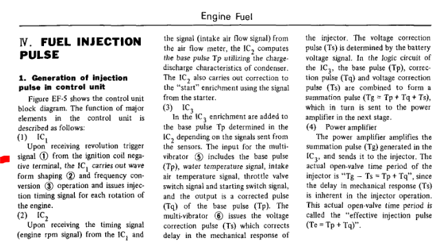

April 26, 20195 yr comment_574217 Yeah, I definitely think there's something else going on. There's absolutely no reason you should need to disconnect the WTS to improve anything. Disconnecting that should do nothing but produce billowing clouds of eye burning rich fumes. Have you checked the timing with a timing light? Should be able to get a quick and dirty measurement if you can keep it running long enough. Are you sure you have the thermotime and WTS connectors in the correct positions (sorry, but have to ask). If you think you're looking for an intake leak, you could smoke the system. The injectors are powered through the dropping resistors as shown. Bank of four and back of two. On the low side, they are grounded in groups of three. (1, 2, 3) and (4, 5, 6) through the two output power transistors. Wish I was closer to give you a hand. Link to comment https://www.classiczcars.com/forums/topic/61835-engine-test-stand/?&page=7#findComment-574217 Share on other sites More sharing options...

April 26, 20195 yr comment_574229 When my ignition module was going bad it would "over spark", causing the tachometer to read high and the engine to run rich. A possibility. Maybe you have the opposite problem, with a weak ECU trigger pulse. Along the same lines as the tachometer connection issue. Pin 1 "expects" a certain type of "pulse". I don't really know how it works, if it's flyback from the coil discharge or if it's a high and low voltage thing. Do you have all of your wires bundled together? Maybe you have some crosstalk on those signals, or the Pin 1 pulse is getting attenuated. Try splitting them up and checking all connections. Make sure that the ECU has a good ground, maybe the Pin 1 pulse needs that to start the cycle. I know little about electronics. Link to comment https://www.classiczcars.com/forums/topic/61835-engine-test-stand/?&page=7#findComment-574229 Share on other sites More sharing options...
