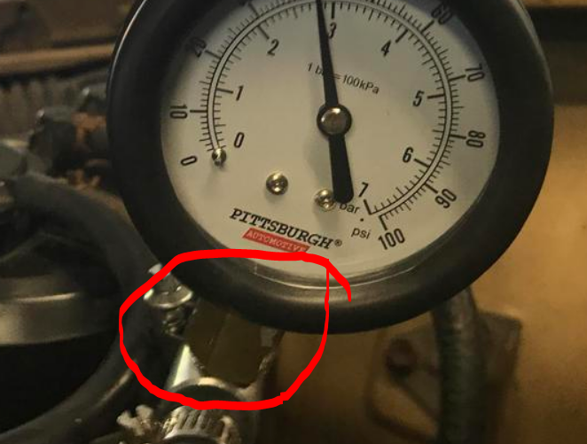

I ran a set of 10 tests and got consistent results:
Fuel Pressure Engine Idling:
With Vac. Connected to FPR: 41 psi (every time)
Without Vac. Connected to FPR: 44 psi (every time)
I did not think of trying it with the hose clamp to prevent vac leak at manifold, but will try that next.

You've found some good correlations but I think that the cause-effect might be off. Closing the AFM vane makes it act like a throttle blade, cutting off air (lowering idle speed), and also causing intake vacuum to increase (causing fuel pressure to decrease).
Maybe the vacuum leak guys were right, but your bad fuel pressure gauge is making things confusing.  You might have a big vacuum leak, causing low vacuum to the FPR which increases fuel pressure, a bad pressure gauge, causing the fuel pressure look high when it isn't, and and AFM that might be adjusted (except that it appears to be adjusted the opposite way to make things leaner).
You have a lot of bad information.  Bad in produces bad out.  Notice that your fuel pressure reading with no vacuum is now the highest it's ever been.  44 psi.  It keeps changing, nobody knows what it really is.  If it was mine, I'd get a new gauge first thing.  You can unscrew the gauge from the hose, you don't need a whole new setup.  Any oil pressure gauge will work also.  A 0 - 50 oil pressure gauge will probably screw right on there.

Regarding the fuel pressure gauge, I'm not defending it, however at worst I think it's maybe 1-2 psi higher than it should be.
That last set of fuel pressure data was pretty consistent (albeit high).

with the consistant 44psi with no vacuum you have to figure out why that is. I would seem the vacuum is doing something.  so either the gauge is wrong or the return hard line is plugged up.
