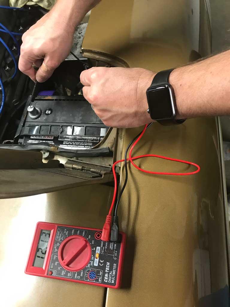

March 28, 20196 yr Author comment_571987 ZH & DaveWM, thank you for responding to this, I appreciate your help. I just checked the battery, it's giving me a reading of 12.13 volts. Tomorrow I should be able to test the voltage with just the fuel pump, and then also with the engine running. Will report results. Agreed this seems very odd, the fuel pressure should drop when the engine starts, but it's increasing. I'm trying to understand how it is that if the battery has low voltage, the fuel pressure increases.... wouldn't it stand to reason that if the fuel pump was not getting enough voltage from the battery, it would be under-performing and thus delivering LESS pressure, and not MORE pressure like it is? Edited March 28, 20196 yr by mbz added photo Link to comment https://www.classiczcars.com/forums/topic/61841-1976-280z-engine-runs-rough-then-dies-will-not-idle/?&page=8#findComment-571987 Share on other sites More sharing options...
March 28, 20196 yr comment_572009 that's a weak battery, get a good healthy new one, make sure you have good quality cables (not the kind that clamp on the wire) Make sure the ground connection from the batter cable to the chassis is good. Little things like this can add up and make chasing odd problems an issue. I was able to find a nice positive lead with TWO extra aux leads all molded into the cable at a local car parts store. One problem at a time. you clearly have a weak battery, so the engine off voltage will drop even more with the load of the pump. Next when the alt is working (engine on) the voltage jumps up and the pump will have power running thru it, increasing the fuel pressure. This is why its important not to jump ahead like I already did. get one thing resolved at a time. 1st now is it get a proper working voltage out of the battery. a fully charged battery should be something like 12.8 min (no load), is does not sound like a lot but 12.13 is not healthy. It will be interesting to see the voltages pump on engine off and pump on engine on. Ultimately you need to get the system working as described 36 psi engine off pump on, 30psi engine on. If that is not happening its pointless to move on to other test. the efi is a open loop system with no ability to compensate for out of spec conditions. the pressure must be correct, the sensors must be correct for the entire system to work (think ZH has already mentioned this). Modern cars with O2 sensors and real computers and adapt and keep a car running with all kinds of system failures (but then you get that dreaded "check engine"). You can still check the return line while working the battery issue out, it only takes a min to disconnect the line in the engine bay, remove the fuel tank filler cap, and make sure you can blow air back thru it. Worst case the line is blocked, not easy to fix. If its ok and the battery supply is ok, then the FPR maybe not regulating properly. this would require more test with a controlled vacuum source to make sure the problem is with the FPR. again no point in any other test till you get the 36/30 engine off/engine on with the pump running. 38PSI at idle is more fuel pressure than with the engine at wide open was designed for. no wonder the plugs foul. Edited March 28, 20196 yr by Dave WM Link to comment https://www.classiczcars.com/forums/topic/61841-1976-280z-engine-runs-rough-then-dies-will-not-idle/?&page=8#findComment-572009 Share on other sites More sharing options...

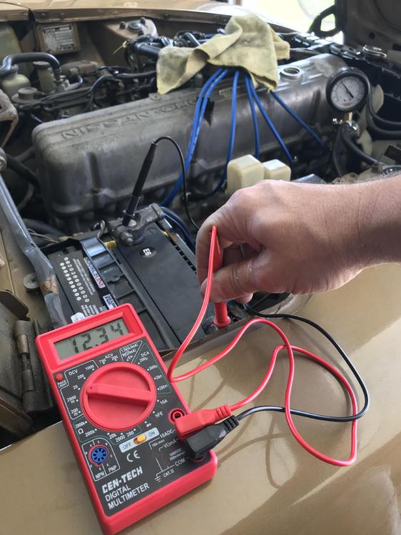

March 28, 20196 yr Author comment_572042 OK so I had a chance to test the voltage with the engine running, it jumps between 12.95 - 13.07 volts. (see video) Then I tested the battery voltage with just the fuel pump on and it reads 12.34 volts. (see photo) I did a visual inspection of the cables and ground connection, they appear to be OK. Will pick up a new battery this weekend. voltage_with_engine_running.MOV Link to comment https://www.classiczcars.com/forums/topic/61841-1976-280z-engine-runs-rough-then-dies-will-not-idle/?&page=8#findComment-572042 Share on other sites More sharing options...

March 28, 20196 yr comment_572044 15 minutes ago, mbz said: OK so I had a chance to test the voltage with the engine running, it jumps between 12.95 - 13.07 volts. (see video) Then I tested the battery voltage with just the fuel pump on and it reads 12.34 volts. (see photo) So close, so close. I can even see the pressure gauge in the back of one of the pictures. We're really more interested in the fuel pressure at those voltages. We don't really care about the voltage itself. Looks like that latest video might have it.. let's watch. Link to comment https://www.classiczcars.com/forums/topic/61841-1976-280z-engine-runs-rough-then-dies-will-not-idle/?&page=8#findComment-572044 Share on other sites More sharing options...

March 28, 20196 yr comment_572047 12.34 with the fuel pump running is not that bad. But it still is a good idea to have a new battery if its even suspect. I replace my battery every 3 years or so even if it test ok. I use a napa legend series fyi. Now back to the original problem. Just to be sure do the pressure checks again, this time with the running, then turn it off and get a engine off (pull the solenoid key to start) this way the batt will have a fresh charge on it. I just want to see those odd readings again that you had previously shown. If that is still the case then you need to check that return line and if ok it almost has to be something wrong with the FPR. You can test I have a test showing compressed air to trigger the 36 psi bleed off. In your case you would need to supply a vacuum as well to confirm the FPR operation. took a long time to type this, did not see the videos yet Edited March 28, 20196 yr by Dave WM Link to comment https://www.classiczcars.com/forums/topic/61841-1976-280z-engine-runs-rough-then-dies-will-not-idle/?&page=8#findComment-572047 Share on other sites More sharing options...
