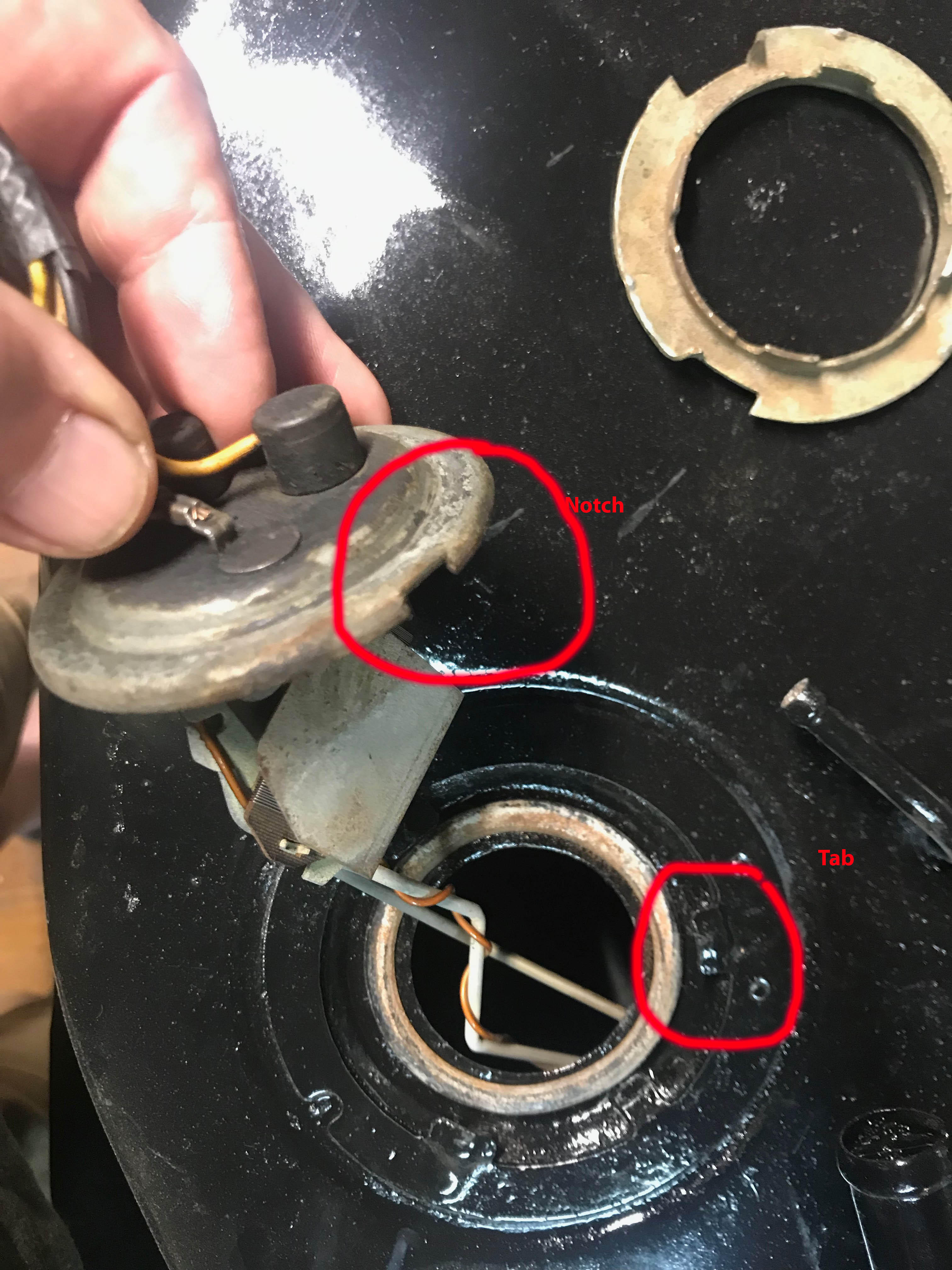

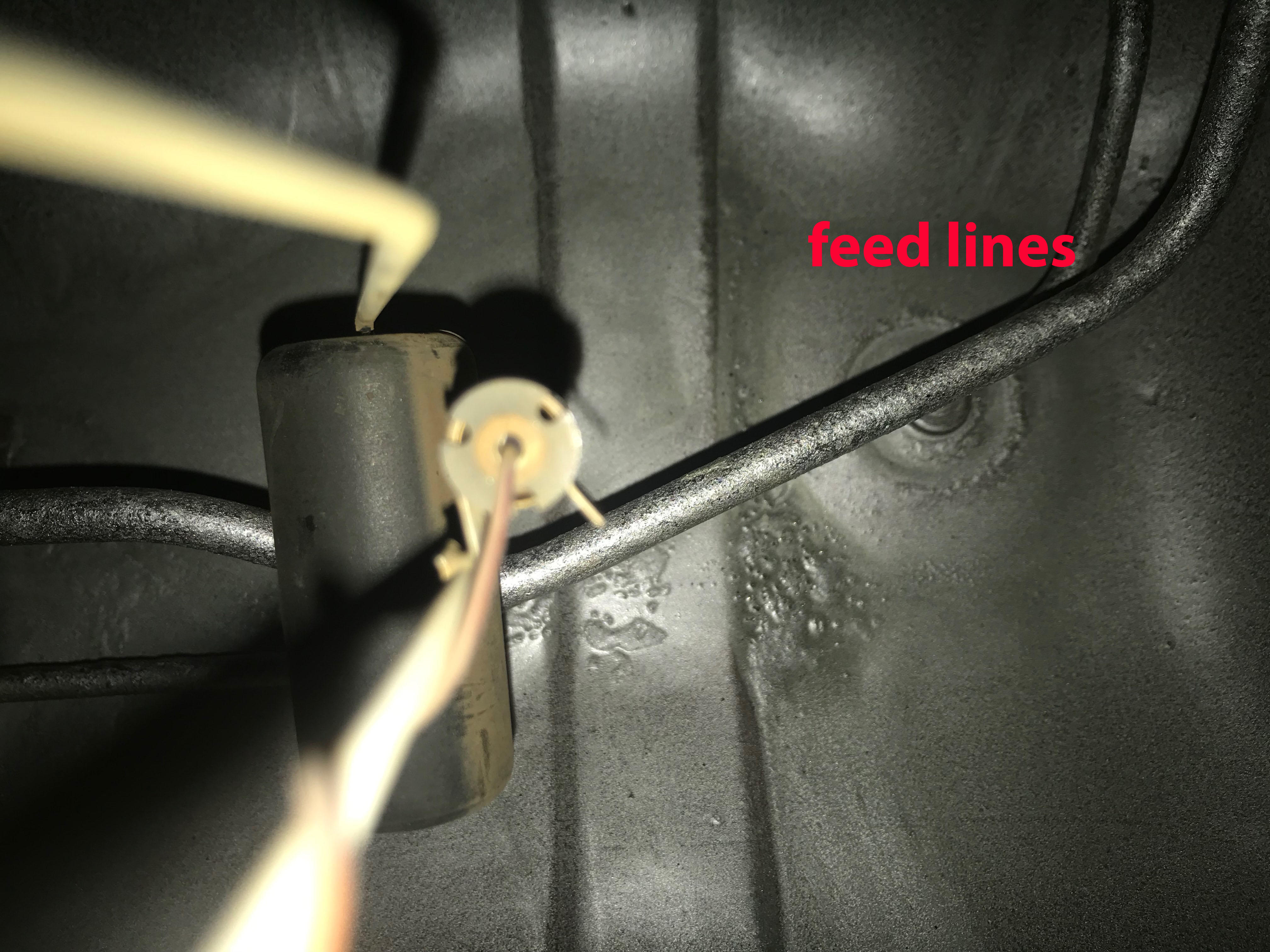

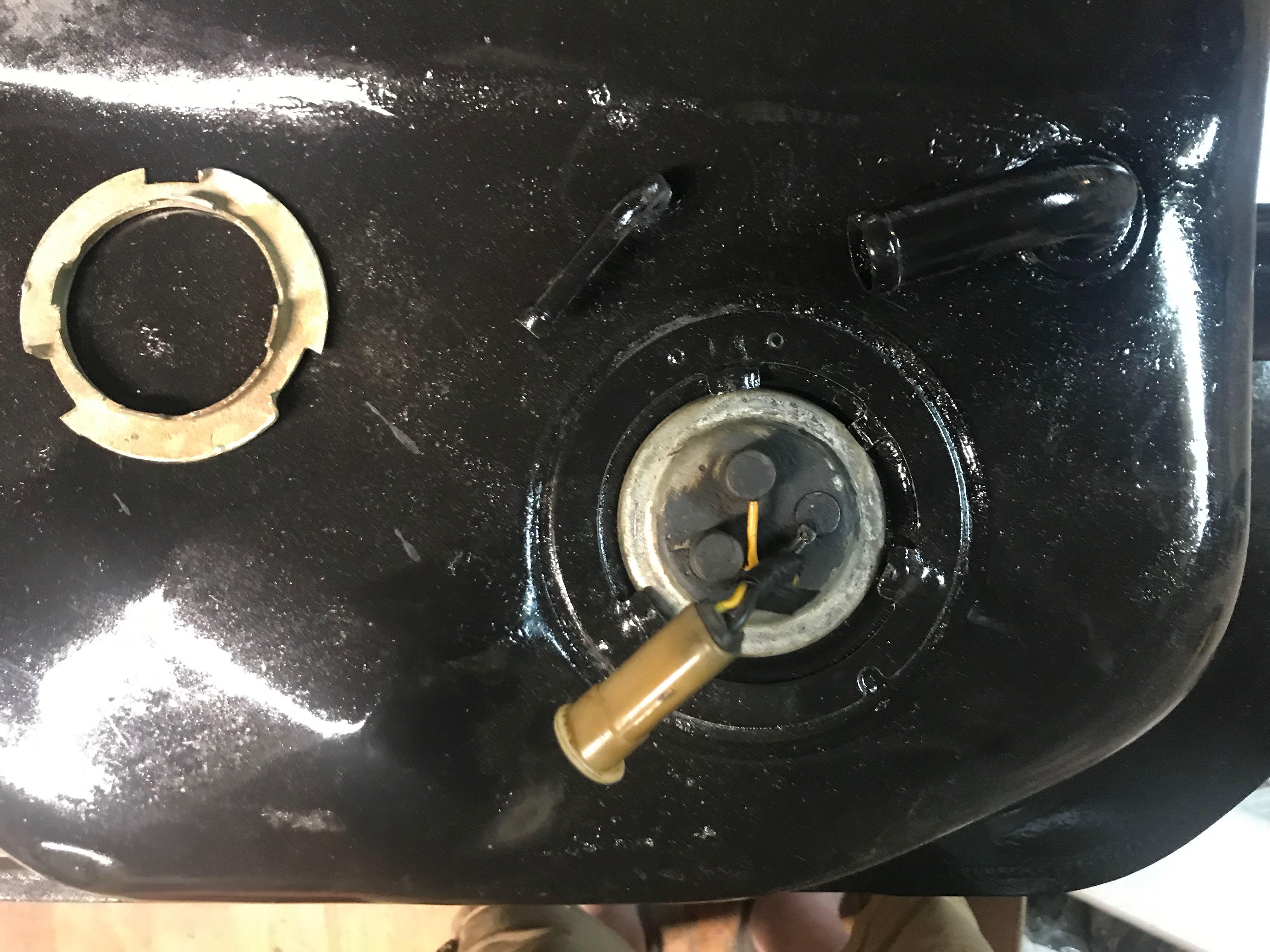

July 21, 20195 yr comment_580118 The good news is you don't have to drain or drop the tank to fix this. It can all be done under the back decking through a round plate on the passenger side. Clocking is important. There is a notch on the sender that lines up with a tab on the tank. Since it is a top mounted unit you have to be careful putting the sender into the tank. After your gyrate the float to pass through the opening, that float has to go OVER two hard lines in the tank. There is a good chance that you dropped the sender float and arm are on the wrong side of those two lines. That would in effect jam the sender are and not allow the sender to read accurately. I'll post some pictures shortly. Link to comment https://www.classiczcars.com/forums/topic/61849-picking-up-a-1977-280z-6-hours-away-tips/?&page=16#findComment-580118 Share on other sites More sharing options...
July 21, 20195 yr comment_580123 First image shows the notch on the sender and tab on the tank Second image shows feed lines inside the tank that the float has to go over, then under the lines. You'll need tilt the sender to do this Third images show the correct orientation of the two top posts on the sender once it is seated. This would be the angle of view if you were working in the hatch. It should seat easily but If there is any binding you'll need to readjust the sender by lifting it up and try again. You'll know when everything feels right. Link to comment https://www.classiczcars.com/forums/topic/61849-picking-up-a-1977-280z-6-hours-away-tips/?&page=16#findComment-580123 Share on other sites More sharing options...

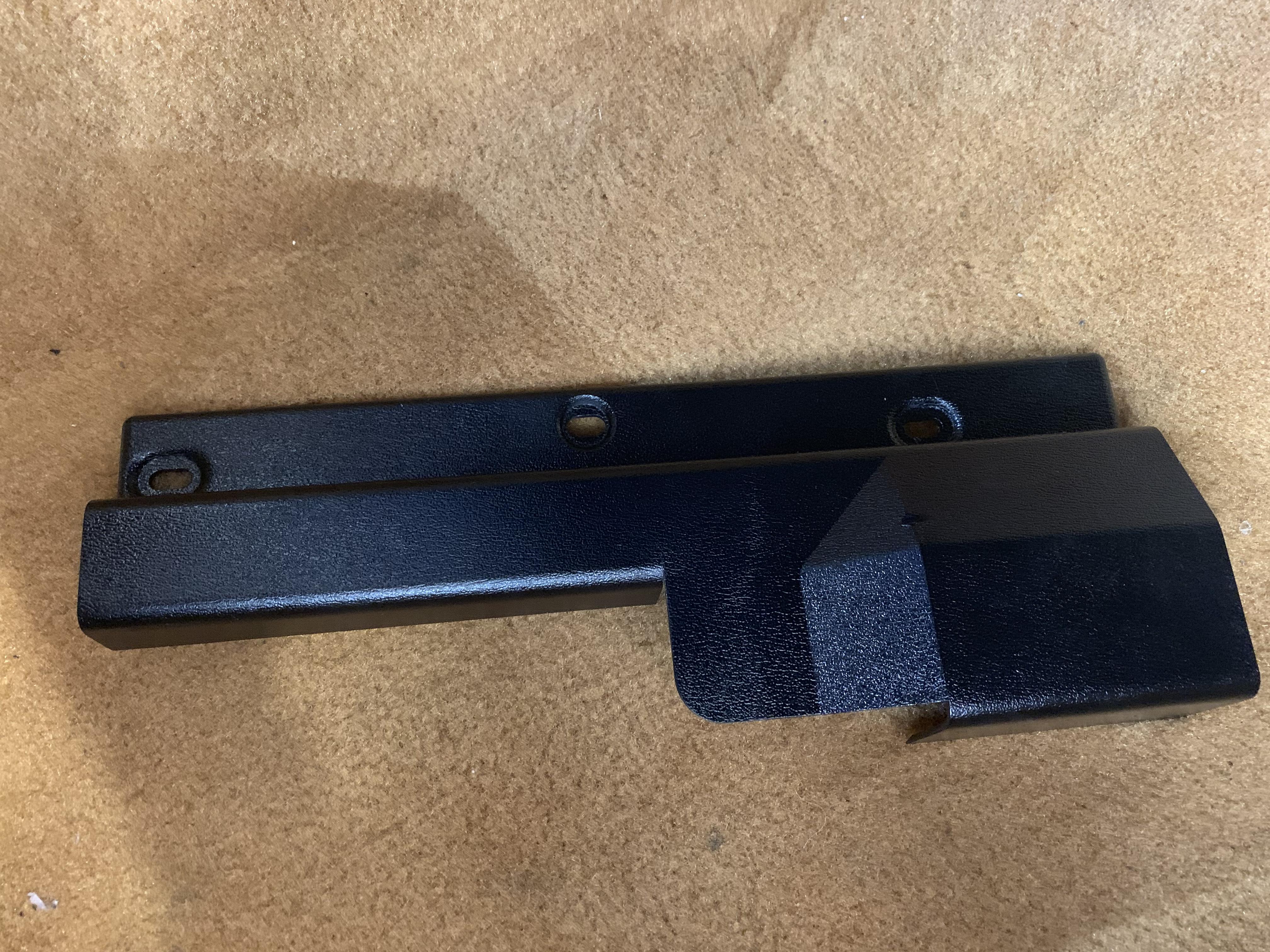

July 22, 20195 yr Author comment_580227 I’m putting back the trim pieces that the PO gave in a box. Does anyone know where this goes? I been trying to figure it out ? Link to comment https://www.classiczcars.com/forums/topic/61849-picking-up-a-1977-280z-6-hours-away-tips/?&page=16#findComment-580227 Share on other sites More sharing options...
July 23, 20195 yr comment_580229 That's the carpet finisher for the passenger footwell. Bolts holes go on the bottom.Sent from my SM-G950U1 using Tapatalk Link to comment https://www.classiczcars.com/forums/topic/61849-picking-up-a-1977-280z-6-hours-away-tips/?&page=16#findComment-580229 Share on other sites More sharing options...
