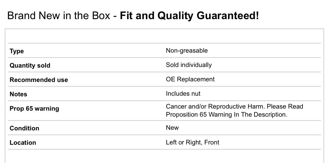

August 25, 20195 yr Author comment_582568 I was able to get to quite a few things in the Z this weekend. I measured the temperature while the Z is running and it’s At the right temperature. Thank you for the advice fellas. I was working on the suspension this weekend as well. My ball joints are oozing out so I want to replace them. I saw a ball joint for sale on eBay. It says “it’s nongreasable”. Does this mean that it’s filled with grease already? I was going to get the moog ball joint but I don’t know if this is greased as well. Link to comment https://www.classiczcars.com/forums/topic/61849-picking-up-a-1977-280z-6-hours-away-tips/?&page=18#findComment-582568 Share on other sites More sharing options...

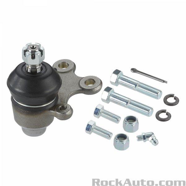

August 25, 20195 yr comment_582569 The Moog 9011 is greaseable. 14mm Thread MOOG® Problem Solver® products incorporate proven design and engineering features for like-new suspension, ease of installation and longer life. MOOG is the preferred steering and suspension parts brand of professional technicians and NASCAR Crew Chiefs. Construction and design validated by MOOG engineers Greaseable socket reduces corrosion and wear by allowing new lubricant to flush contaminants Loose or worn chassis parts can lead to premature tire wear Long-lasting performance Restores like-new steering and handling Material Neoprene Castle Nut Included Yes Cotter Pin Hole Yes Mounting Hole Quantity 3 Greasable Yes Alternate/OEM Part Number(s): 4016078500, 40160A3405, 40160A8600, 40160A8610, 40160A8625, 40160U7000 Link to comment https://www.classiczcars.com/forums/topic/61849-picking-up-a-1977-280z-6-hours-away-tips/?&page=18#findComment-582569 Share on other sites More sharing options...
August 25, 20195 yr comment_582573 look out for cheap ball joints, avoid them, moog is good, I got a "Sankei 555" made in japan. Neabour had a cheap ball joint BREAK on him Don't know the details but that was enough for me. The OE ball joints may be fine, if there are just oozing may just need a boot. IF they feel tight and have no play, you may just want to clean up and replace the boot. New is not always better. Edited August 25, 20195 yr by Dave WM Link to comment https://www.classiczcars.com/forums/topic/61849-picking-up-a-1977-280z-6-hours-away-tips/?&page=18#findComment-582573 Share on other sites More sharing options...

August 25, 20195 yr comment_582578 https://www.thezstore.com/page/TZS/PROD/23-4307 Not cheap so you would want to make sure your old ball joints are not worn out. Have to remove them, they should be somewhat tight, any slop bad, easy to move bad. If they seem ok then you could clean up (pump grease to displace all the old) wipe clean, install boot, install on car, pump up with grease unitl you start to see the boot bulge (just a bit). Link to comment https://www.classiczcars.com/forums/topic/61849-picking-up-a-1977-280z-6-hours-away-tips/?&page=18#findComment-582578 Share on other sites More sharing options...
August 25, 20195 yr Author comment_582583 54 minutes ago, Dave WM said: https://www.thezstore.com/page/TZS/PROD/23-4307 Not cheap so you would want to make sure your old ball joints are not worn out. Have to remove them, they should be somewhat tight, any slop bad, easy to move bad. If they seem ok then you could clean up (pump grease to displace all the old) wipe clean, install boot, install on car, pump up with grease unitl you start to see the boot bulge (just a bit). Got it, thanks for the link. I’ll be completing this repair along with the suspension components. Link to comment https://www.classiczcars.com/forums/topic/61849-picking-up-a-1977-280z-6-hours-away-tips/?&page=18#findComment-582583 Share on other sites More sharing options...
