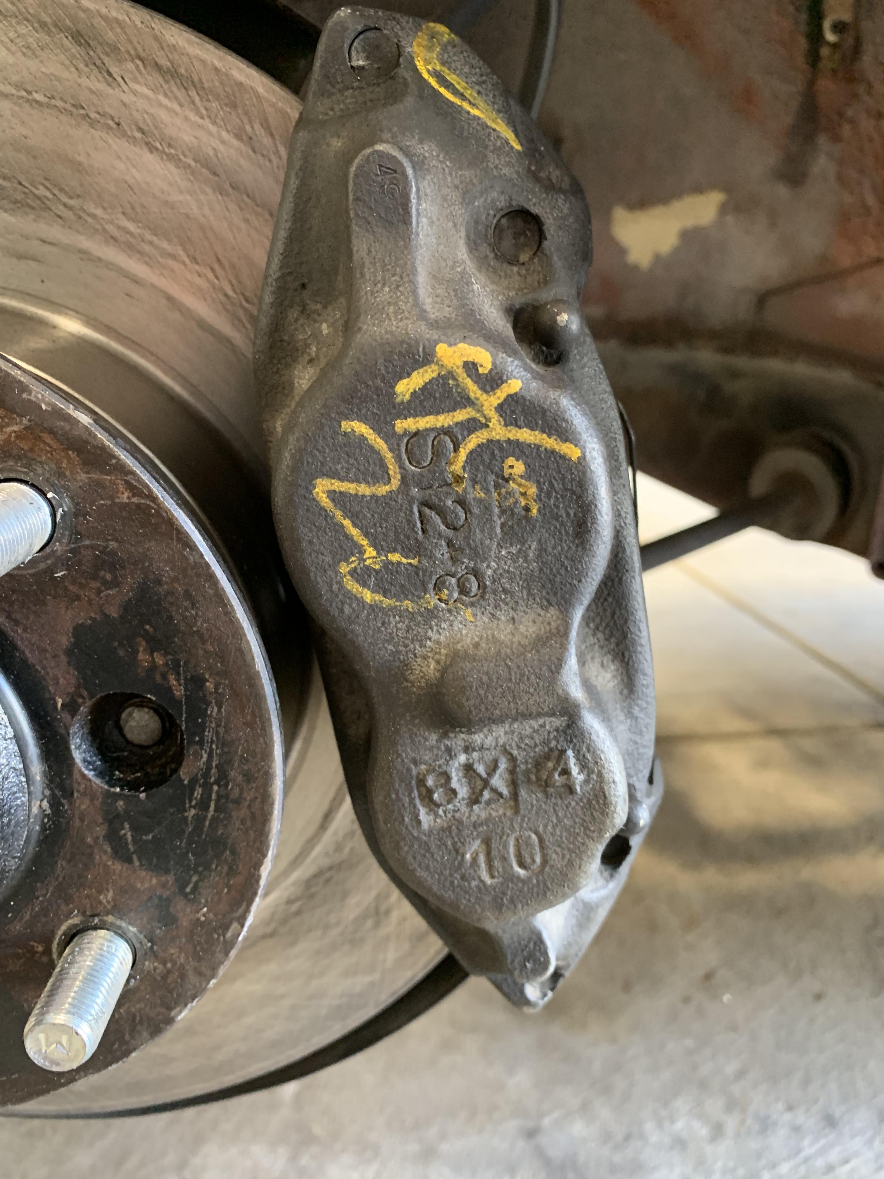

i noticed the caliper I have is different. Do you know which calipers these are? I need to get brake pads
I replaced the rotors with the non vented original rotors for a 280z and the brake pads are slightly touching the rotors.

The pads will always be close to the rotors, they self-adjust.  They shouldn't be generating any friction though, the wheel should spin freely.
