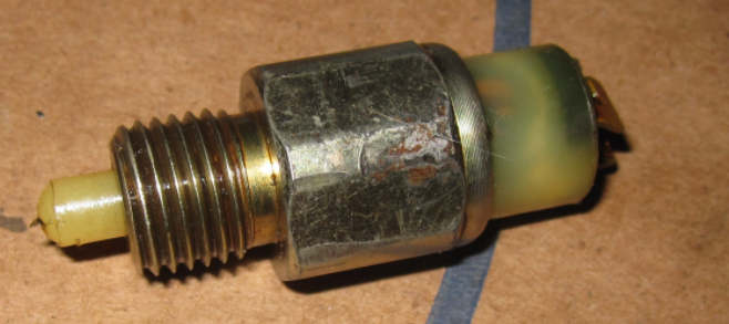

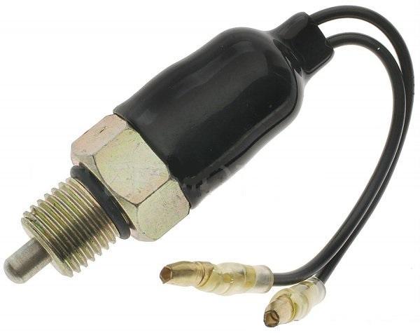

Looks like zcardepot sells it with an o-ring but autozone does not. So who knows.
IIRC when I was tracing a leak at the switch I fixed it with a new o-ring. But that was about 9 years ago. So I could have installed one to stop a leak if what you say is correct Zed Head, no o-ring
Looks like it's one of those "mysteries". I can't find anything that says yes or no on the o-ring.
Edited by rcb280z
O-rings are interesting things. They were developed to replace old fiber and grease packing materials.  They are supposed to have a fairly precisely sized channel to live in to work correctly.  Not really meant to be squished flat.
I think that I just used some Hylomar blue non-hardening sealant on mine.  You could make your own paper gasket pretty easily.  Lots of flat to worth with.
2 hours ago, Zed Head said:
I'm not so sure that there's an O-ring there.  The ones I've seen are just two machined flats, no gasket, no O-ring.  Worth removing to take a look, for sure, though.  Easy.  19 mm wrench.

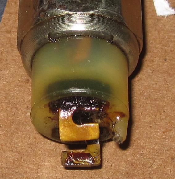

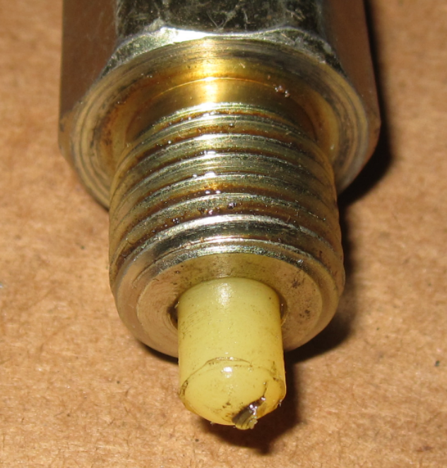

I just went and messed with one I had off to see what I remembered.  The body of the one I looked at is metal, crimped around a plastic mechanism.  some have a metal plunger.  I don't know if there's an O-ring inside or not.  But the plastic portion was loose in its seat in the metal body.  I wiggled it and oil started to work its way out.   I think that the plastic, or internal O-rings, shrink after a few million heat cycles and leaks start.
Thank you for the photos! I placed an order for a new switch so I can fix that transmission leak.
