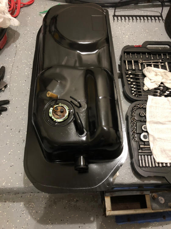

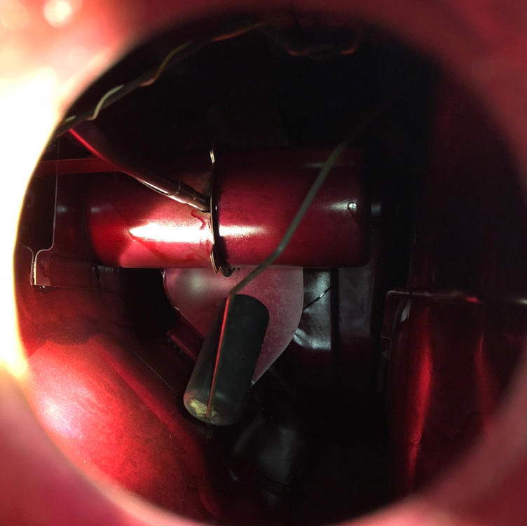

April 28, 20195 yr comment_574383 I agree the fuel filter is a precautionary measure not a fix. It will save you from damaging your fuel pump which is expensive for an OEM one. If you see rust then your tank is failing. It will only get worst and became a hazard to a reliable vehicle. It will have to be cleaned eventually so do it next off season (winter). It’s actually a pain in the arse in my opinion. Don’t put BB’s in you tank either after pulling it to use a an agitation agent to break on the rust. You’ll never get them out. I met a guy first hand who did this and it was a nightmare. He had to cut a door into the tank to get all them out and then weld it back. He eventually dipped his tank in a trash can full of 5:1 diluted water and muriatic acid followed by an immediate rinse in baking soda bath to neutralize the acid and then he poured POR-15 in there. It’s a messy job for sure. I had mine professionally cleaned inside and out by a semi-truck radiator shop and it looks like new. Cost me $350. This a must do job to build a reliable car in my opinion. It’s just one of the things you need to do eventually on an old car. Here are pics of the inside and outside on my tank post cleaning and painting all done by the repair shop. Do it right the first time and save yourself time and hassles. Sent from my iPhone using Tapatalk Link to comment https://www.classiczcars.com/forums/topic/61849-picking-up-a-1977-280z-6-hours-away-tips/?&page=8#findComment-574383 Share on other sites More sharing options...

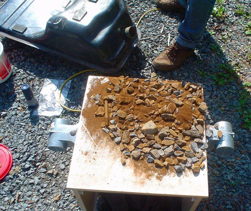

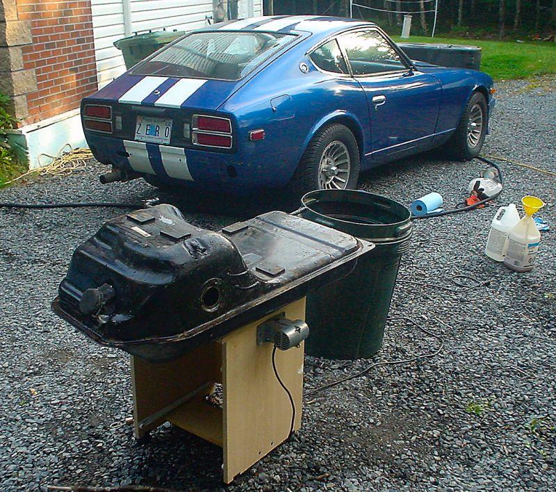

April 28, 20195 yr comment_574385 here's how @240260280z does his. when he's in a hurry muriatic acid works too. http://atlanticz.ca/zclub/techtips/fuel/gastank/index.htm Edited April 28, 20195 yr by siteunseen Link to comment https://www.classiczcars.com/forums/topic/61849-picking-up-a-1977-280z-6-hours-away-tips/?&page=8#findComment-574385 Share on other sites More sharing options...
April 28, 20195 yr comment_574389 Vibrating table, blue rocks, and a friend's 240z tank. Link to comment https://www.classiczcars.com/forums/topic/61849-picking-up-a-1977-280z-6-hours-away-tips/?&page=8#findComment-574389 Share on other sites More sharing options...

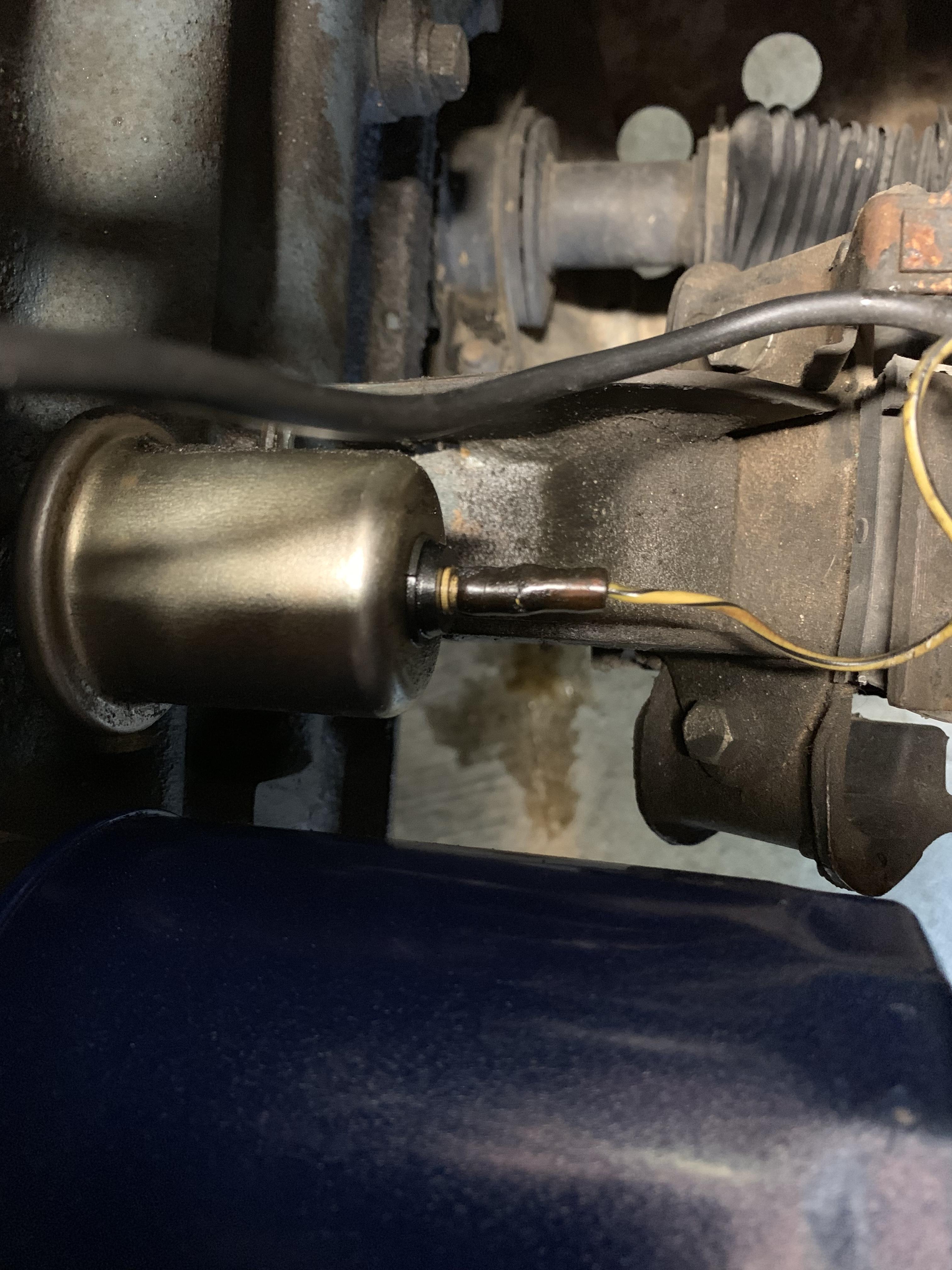

April 28, 20195 yr Author comment_574397 Went on a drive today with my dad and it drove well today! The fiancé and I went through a good amount of maintenance these past two weeks. The transmission leak stopped after changing the switch! Thank you guys for this tip to fix it. Next weekend we will address two issues: a fuel leak in the gas tank right under the filler cap. The other issue is the cylindrical housing to the right of the oil filter is slowly leaking. What part would fix this issue? Link to comment https://www.classiczcars.com/forums/topic/61849-picking-up-a-1977-280z-6-hours-away-tips/?&page=8#findComment-574397 Share on other sites More sharing options...
April 28, 20195 yr comment_574398 That's the oil pressure sender Link to comment https://www.classiczcars.com/forums/topic/61849-picking-up-a-1977-280z-6-hours-away-tips/?&page=8#findComment-574398 Share on other sites More sharing options...
April 28, 20195 yr comment_574400 Unscrew it, seal the threads and screw it back in.... see if that does the trick. If not then it should be changed out. Link to comment https://www.classiczcars.com/forums/topic/61849-picking-up-a-1977-280z-6-hours-away-tips/?&page=8#findComment-574400 Share on other sites More sharing options...
April 28, 20195 yr comment_574401 I've put teflon tape on my oil senders. No leaks. Link to comment https://www.classiczcars.com/forums/topic/61849-picking-up-a-1977-280z-6-hours-away-tips/?&page=8#findComment-574401 Share on other sites More sharing options...
April 28, 20195 yr Author comment_574404 On 4/28/2019 at 7:12 PM, siteunseen said: I've put teflon tape on my oil senders. No leaks. Good idea, did you put the Teflon tape on the oil sender threads? Link to comment https://www.classiczcars.com/forums/topic/61849-picking-up-a-1977-280z-6-hours-away-tips/?&page=8#findComment-574404 Share on other sites More sharing options...
April 28, 20195 yr comment_574405 On 4/28/2019 at 7:47 PM, BayAreaZ650 said: Good idea, did you put the Teflon tape on the oil sender threads? Yes. They're the male end. The sender is. Hope that fixes it! If you're gonna buy some I'd get that thick pink tape. I love that stuff better than the thin white. Edited April 28, 20195 yr by siteunseen Link to comment https://www.classiczcars.com/forums/topic/61849-picking-up-a-1977-280z-6-hours-away-tips/?&page=8#findComment-574405 Share on other sites More sharing options...
April 28, 20195 yr comment_574421 Might be better to use a high temp Permatex Thread Sealant vice Teflon tape because I don’t think those tapes are designed to be exposed to petroleum products. Go to Autozone and get Permatex thread sealant. It comes in a small travel toothpaste size container. My 2 cents. Link to comment https://www.classiczcars.com/forums/topic/61849-picking-up-a-1977-280z-6-hours-away-tips/?&page=8#findComment-574421 Share on other sites More sharing options...
