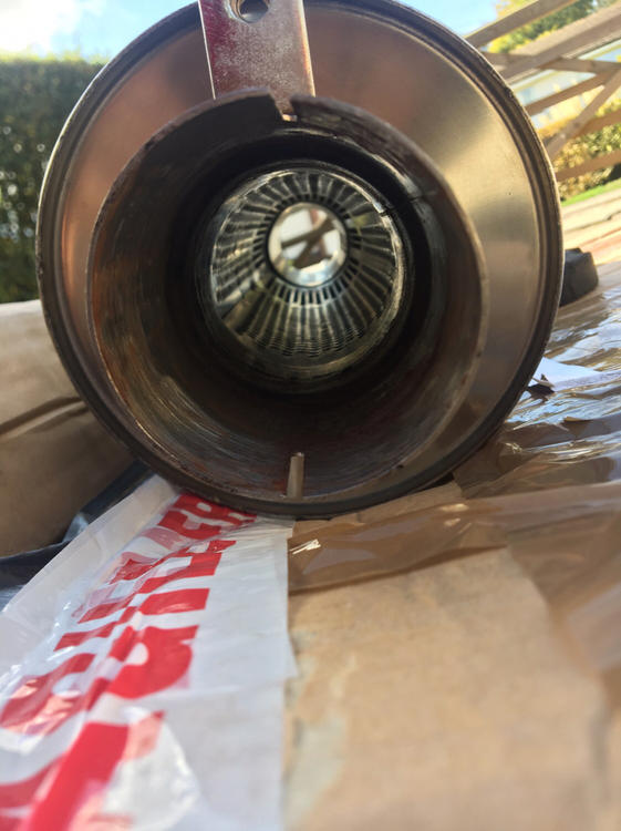

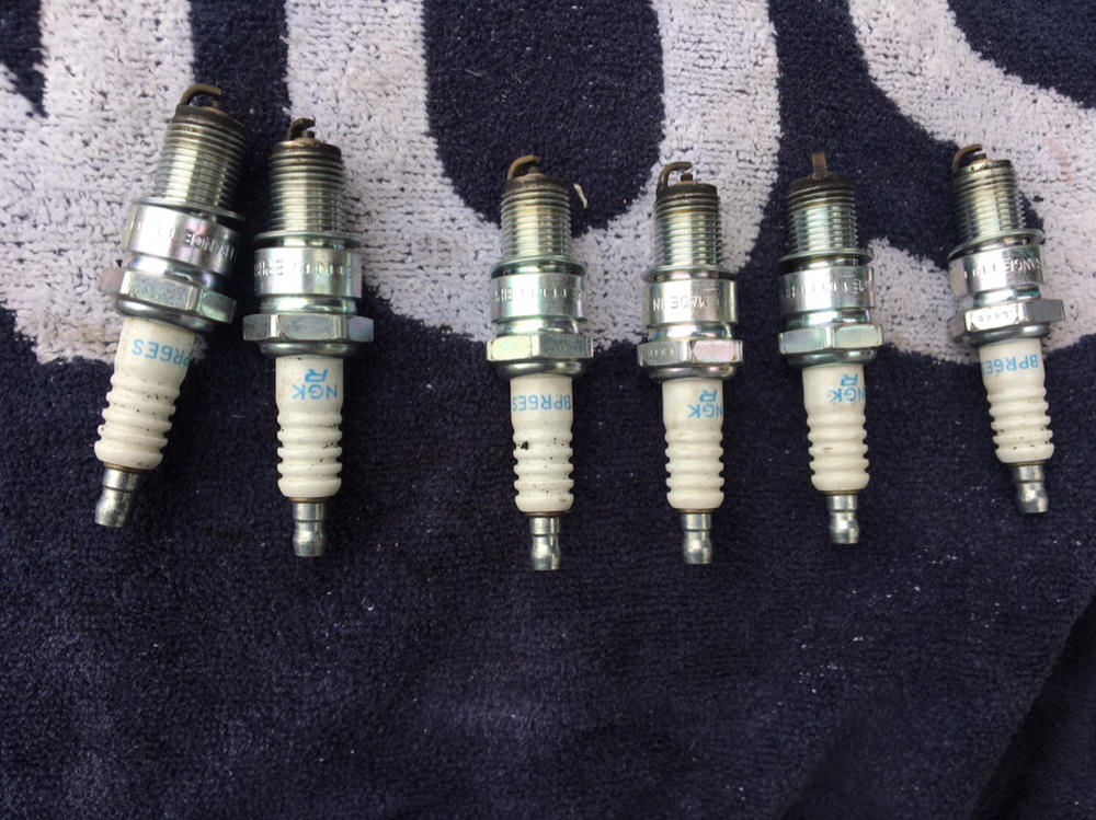

Problem: the car feels like it's "missing" constantly but randomly (I.e. Not always on the same Cyl). Mainly on steady throttle or idle. Goes like stink but tries to die when idling. Plugs all look the same, like they are firing and chocolate brown if taken out after hard acceleration and ign off + neutral. It feels like it would, if a carb was way out of balance or a cyl not firing correctly.
41c76a276d504fb34886d55db80e980f.jpg&key=940122cc25f2c1b415ef5aee04e8d5984ab0d9267e83adddddad64438e553954
Engine: L28, 10.5:1, 270 degree high lift cam, Dynamic Compression c. 205PSI across all 6, pertronix flamethrower coil, 8.5mm HT leads, NGK BPR6ES plugs gapped at 1.1mm , 123 ignition. Z therapy SUs / SM needles.

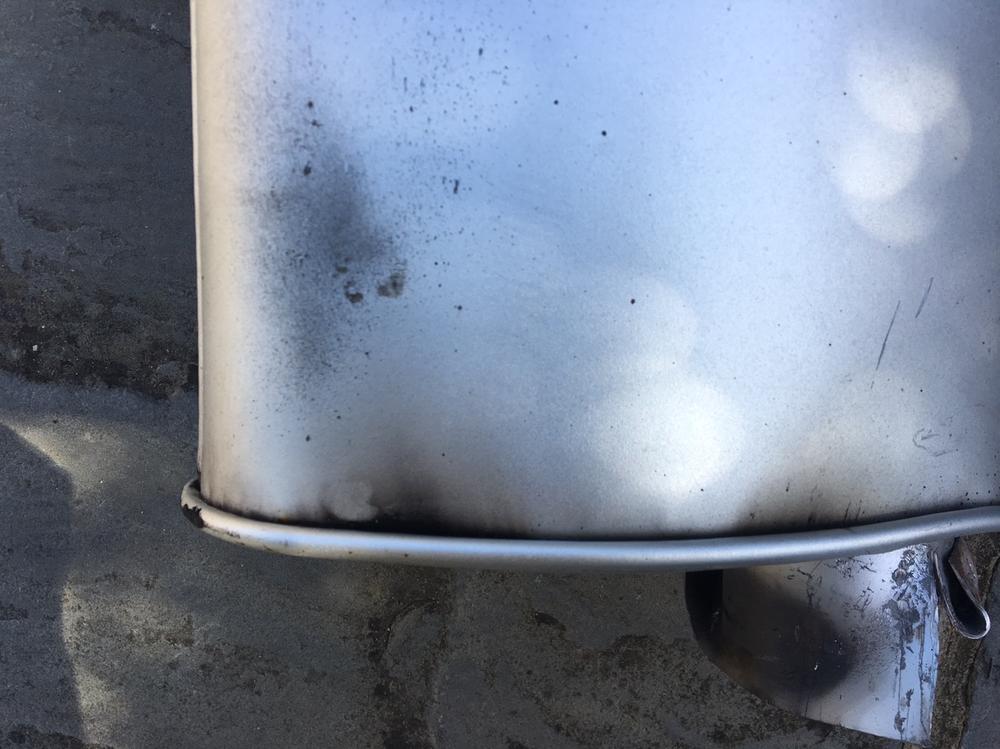

When did it start: I fitted the 123 ignition, stupidly following the instructions and the no.1 plug position on the cap was not correct against where the rotor was pointing - timing 120 degrees out. It resulted in a condition technically referred to as "car-no-startie" followed by a baaada boom!!!! Biiig bada boom, bada big boom. Goodbye baffles, hello shiny new straight through silencer! :D
0b7e55417f310d9e533eb99a271d80cd.jpg&key=28a08008b8e6d1a617379ef06f462b6817d9b5610759e1f76ff6fe40adac8297
daeb0adf1ce1894aaa8f545f835760c8.jpg&key=1342048a85d607e539655768d267c357a5268da1fd3343ffb14c6412ef1f8c19
Coincidentally, later I found the magnecore leads had breaks that came to the fore after the dizzy change, resulting in intermittent ignition issues and on power/wot popping - according to the condescending chap on the phone at magnecore this failure is my fault for not unplugging them often enough!!! Not sure how that is possible as my HT leads are on and off like a tart's knickers!! No matter, at least I know what not to buy next time. So that made me think HT was to blame.

Retuned carbs on Friday last week. All good right until I pulled the plugs for the last time to check colour. Plugs back in not smooth anymore on part throttle or idle. Changed plugs again in case I damaged them, no difference.

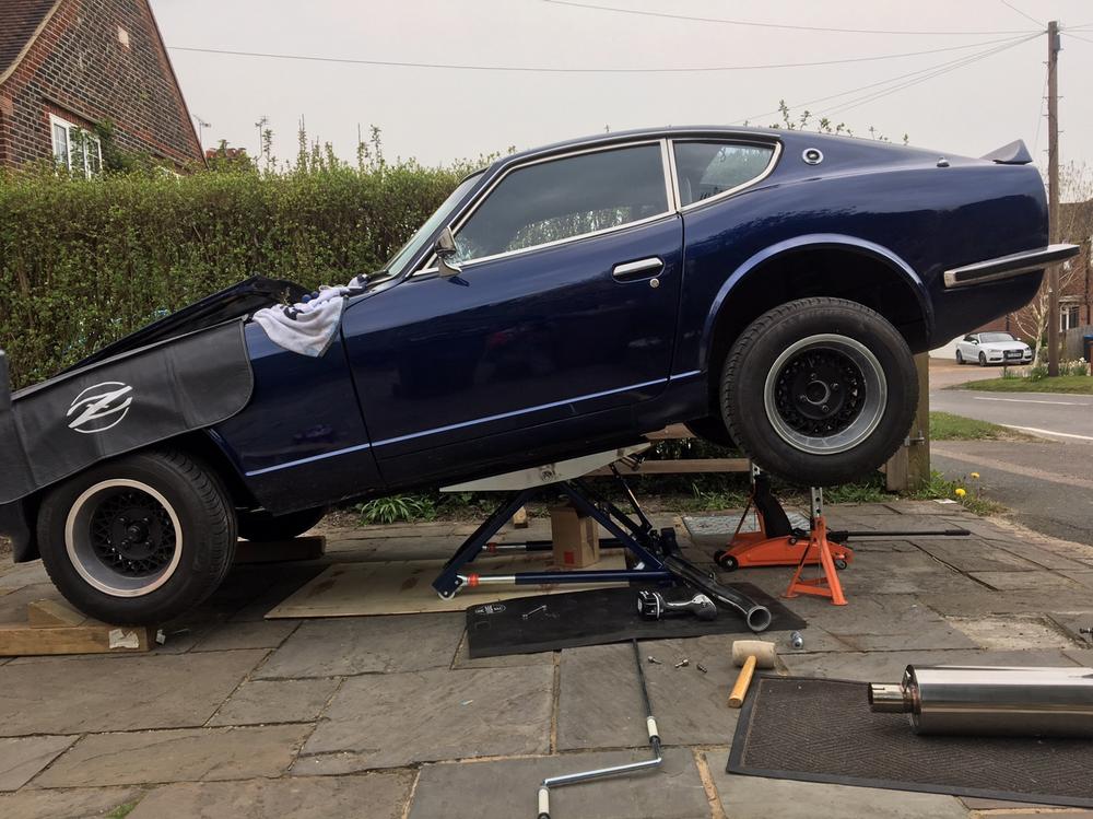

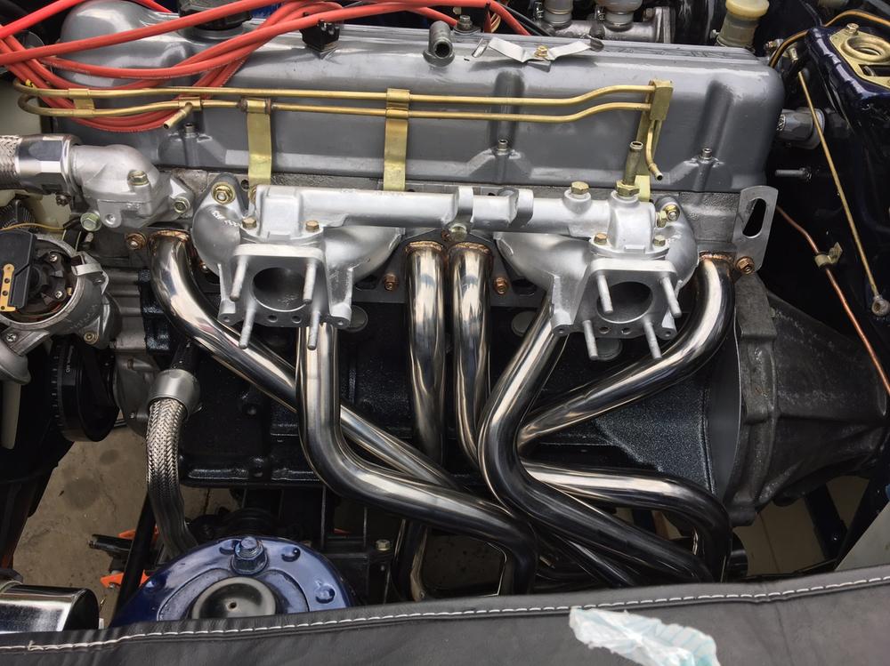

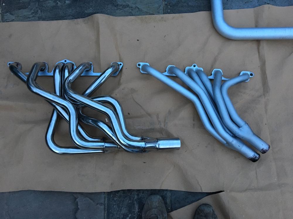

Quick update as promised:

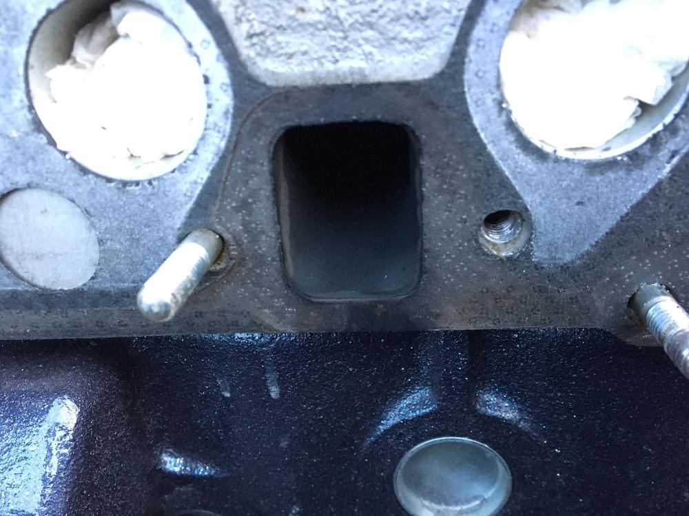

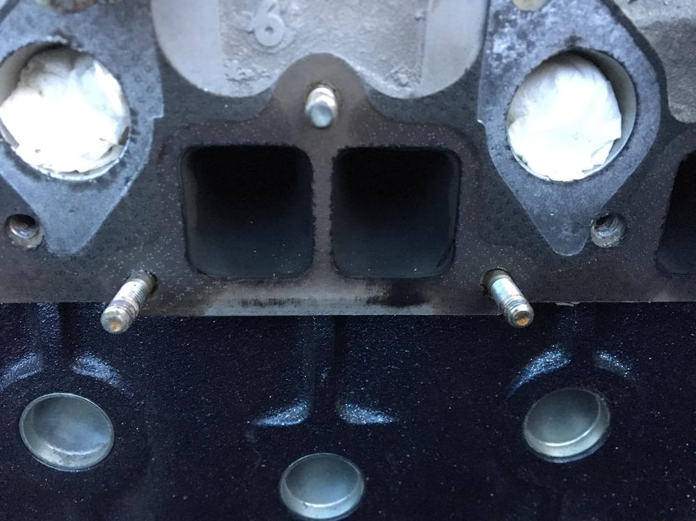

I fitted the Z story exhaust and in the process found that on the original header gasket there were several exhaust leaks and a small vac leak on cyl 6.
With new header and gasket, the car runs just fine. Amazing how much fuss a little air leak can cause!
8150b9e8e0e5c6913982a04606540a30.jpg&key=10f201c9d30a51564741c29086f56d4163f9f3e59950e60f9befa090ffac771e
The Z story system is a thing of beauty and performs well. Sean the supplier is also a very decent chap who has been most helpful post sales.

The tilting lift is made by CJ Autos in the UK. I started a thread on it and there was a lot of controversy on where to position it on the car. I still haven't had the balls or the need to take it to it's max height. [emoji33]
https://zclub.net/community/index.php?threads/car-tilting-lifts-cj-autos.25075/

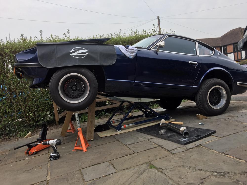

Given mine is a '77 260 it has the longer fatter floor / chassis rails (like the 280) that go all the way back. You can lift the car on the cills instead of you wish as the lift is width adjustable but I felt where I have it was the strongest less damaging place to go - especially given the wide weight distribution across the car.
It is my number one favourite Best Buy tool!!! I don't have space for a post lift in my garage. With this tool, except for a tranny swap there is nothing I can't do on the car now that requires underside access.

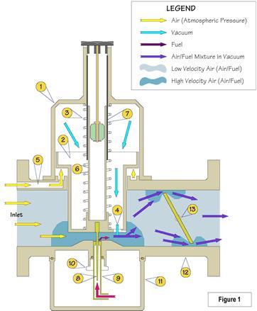

So next I got a length of 18mm ID rubber hose and listened around the carbs because the rear carb I thought was whistling loudly. Well both carbs are doing it and it was mainly at the mouth where the two small holes take air pressure to the piston. Hole 5 below. As I understand, SU carbs to make a high pitched sound without the air cleaner on.
66638b46c0c53842c184266260a10149.jpg&key=4184b281e58c2fa7b6515f95417bc283cab7e92769843ff15fd7062f00b06b73
Next up, I took the domes off to see if anything obvious was amiss. All I could think of was that somehow the domes are leaking.
I checked the bottom of the domes for flatness and found the rear carb in particular to be less than flat. So I got some 3mm closed cell foam sound deadening material and made a couple of gaskets.
b833ce6ddd556b95738a8ae8d6289ad6.jpg&key=dd800e8f7472f38e1dad7d94798536f61fd7c02b55f6a7a518d18a74d4e503ba
This made it way harder to centre the needles and pistons but a bit of patience and carefulness while tightening down did the trick.
I went out to “buy some bread” and it’s a different car! The wobbly engine is a shed load smoother. The AFR that previously would not budge past 15 now goes 18+ on the overrun when in gear. The idle is sitting at a lean 16 and cruising steady throttle AfR is around 15-16. WOT when passed the reversion part of the range sits doggedly from 11.5-12.5, the latter at around 6.5k rpm. The rear wheels now squirm in 2nd at 4K rpm.
So for now I am quietly confident the issue may have been resolved and will try to find a better solution with some plumbing rubber O rings.
