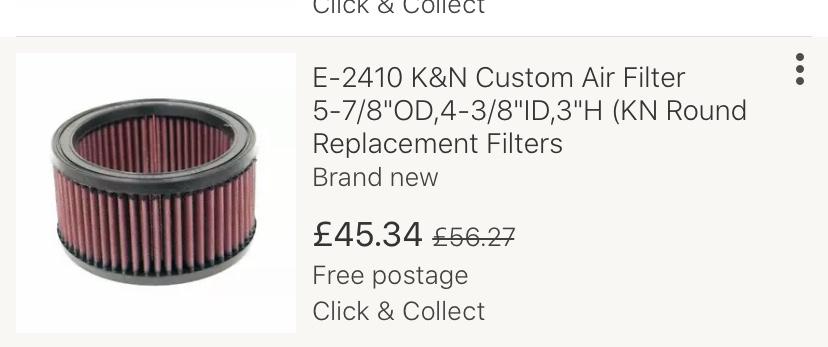

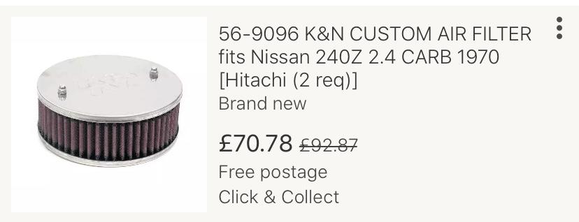

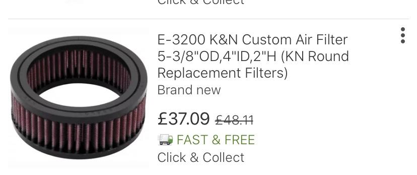

I absolutely love the look of those round filters - they are phenomenally expensive to get this side of The Pond. If I buy from Zcardepot they end up at $239USD delivered!! As a matter of interest do you know the K&N part number (or dimensions) of the actual filter element? I am tempted to see if I can source the elements and fabricate my own metalwork.
I know people say they will cost a few small ponies due to sucking warmer air but the sound is quite a way closer to DCOEs!
These are several options but I think the E2410 is the closest!
