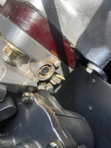

Alright gang, the hunt for air leaks continues ....
I could tell that despite the car feeling better, there was still something amiss with the rear carb.

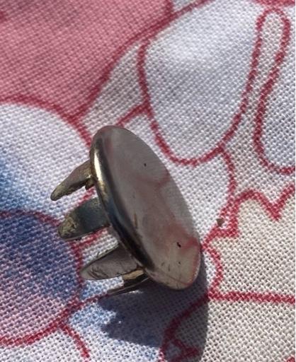

Using self penetrating oil (as it froths up nicely and is runny), I sprayed around the typical areas and found that that outer end of the throttle shaft on the rear carb was showing a perfect line in the froth between the end cap and the carb body. Using a razor blade, I gently encouraged it out (which was frankly quite easy).
I discovered a putty type material in there which I assume is there to seal the cap. Not much of it left though.

Looking at the fingers in the cap, you can see where it was leaking has the dark residue.

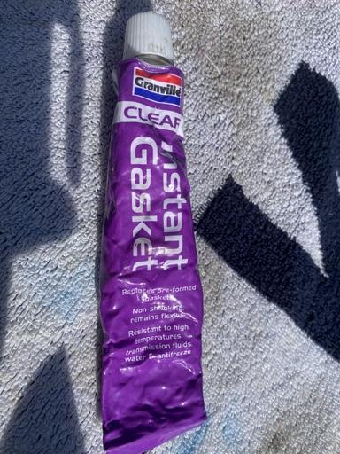

So I cleaned both the cap and carb big up and using a gasket making paste, I covered the cap, pushed it home and wiped off the residue. I’m sure someone will tell me that I have used the wrong paste ;). Incidentally, I used the same thing on the intake manifold and carb insulators gaskets to ensure a good seal.

I used to use that silicone RTV style for pretty much everything, but a couple years ago I switched over to Pertmatex MotoSeal for gasoline intensive applications. I don't know if you've got something similar on your part of the globe, but I assume you could find something.
I ran some tests on both in gasoline, and the MotoSeal came out to be the clear winner. I think I've got some pics around here somewhere if I could only find them...

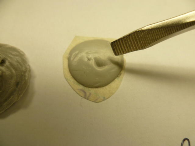

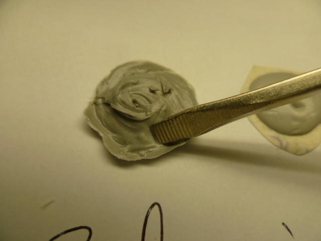

So after posting last night, I was able to poke around on the computer a little and found some detail about my testing and my pics. I don't remember what type of carb I was messing with that spurred me into the experiments, but I did the following...

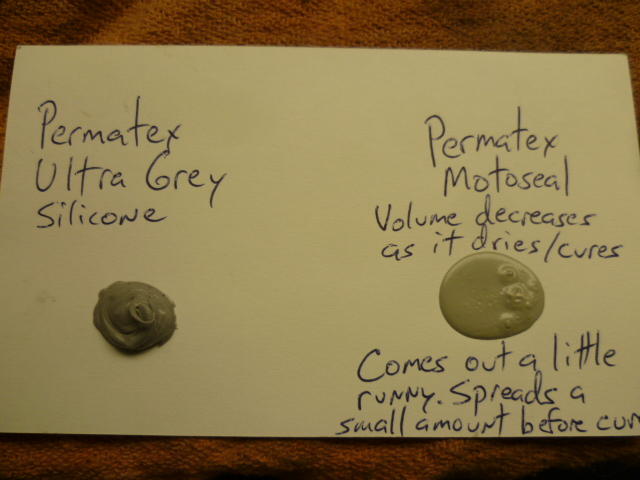

I put a dab of both Permatex Ultra-Gray silicone (my go-to) and MotoSeal on an index card and let them both cure for a couple days. Looked like this:

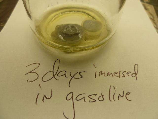

Then I cut the little dabs out of the index card and gave them a couple day immersion bath in gasoline:

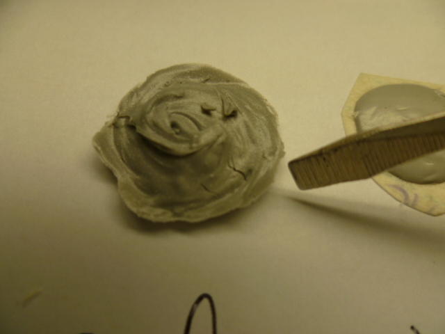

Then I took them out and gave them and compared the results. Here's the ultra-scientific "poke test":
MotoSeal after poking:
Silicone poke:
Silicone after poke:

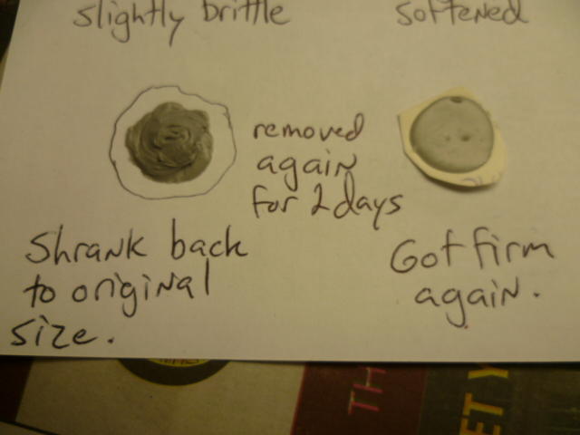

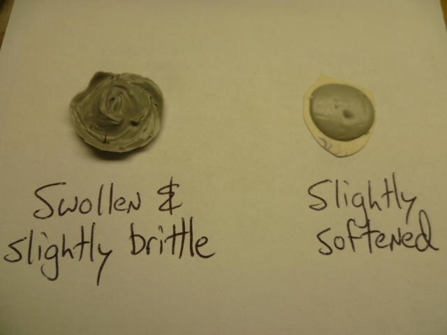

And here's the summary result:
And then after the soaking, I let them sit on the bench and dry out for a couple more days, and here's the results of that:
So after that testing, I've stopped using the Ultra-Gray and have switched over to MotoSeal in gasoline intensive applications,. I still use the Ultra-Gray for most everything else that doesn't involve potential direct exposure to gasoline.
