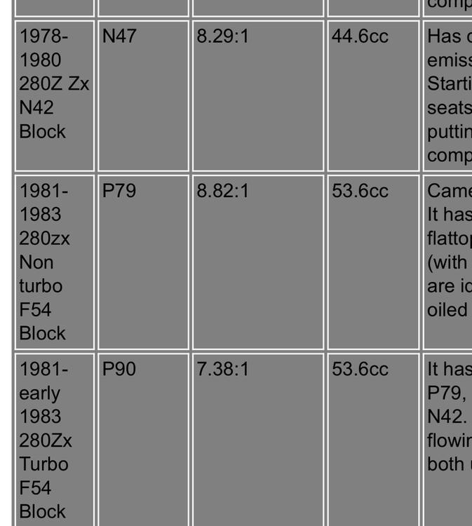

March 28, 20196 yr comment_572022 Do you know the compression ratio you’re going to get with an N47 head and flattop pistons, I’m just not sure what it would be? Looks like right now with dished pistons you would be 8.29:1. I’m going to go with the P 79 head and flat top pistons. Your chamber will be 9cc smaller than with the P79 and flat tops and that head has 8.82:1 CR. Sent from my iPhone using Tapatalk Link to comment https://www.classiczcars.com/forums/topic/61906-engine-rebuild-preparation/#findComment-572022 Share on other sites More sharing options...
