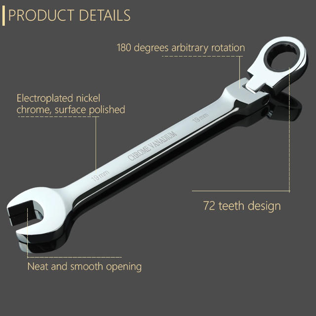

March 30, 20196 yr comment_572178 I did this exact job last year. It is a royal PITA. It can be done, it requires some patience, preferably some small hands. Some advice:You need a ratcheting open end 10mm wrench. It was hard getting the threads started. I pulled off the long bar that goes down the the door lock at attaches with plastic clips. It took me at least 1.5 hrs to figure it out. I may have posted about it. Let me check. Good luck.....you can do it. Tip: sometimes it works to crazy glue the nut to your finger to allow you to maneuver your hand to the right spot without dropping it. Start the threading then pull your finger off. Sent from my iPhone using Tapatalk Link to comment https://www.classiczcars.com/forums/topic/61915-thoughts-on-broken-door-handle/#findComment-572178 Share on other sites More sharing options...
March 30, 20196 yr comment_572179 never seen an open ended ratcheting wrench, seems impossible. Must be a typo, empty mini bar? just playing John! Whelp, my bad. https://www.lawsonproducts.com/lawson/Wrench-Open-End-Ratcheting-10mm/16414.lp?utm_source=google&utm_medium=cpc&adpos=1o1&scid=scplp16414&sc_intid=16414&gclid=EAIaIQobChMI9qDWpZKq4QIVxI2zCh3jbwksEAQYASABEgJccvD_BwE Edited March 30, 20196 yr by siteunseen Link to comment https://www.classiczcars.com/forums/topic/61915-thoughts-on-broken-door-handle/#findComment-572179 Share on other sites More sharing options...
March 30, 20196 yr comment_572180 The other end of the open end wrench has a ratchet Sent from my iPhone using Tapatalk Link to comment https://www.classiczcars.com/forums/topic/61915-thoughts-on-broken-door-handle/#findComment-572180 Share on other sites More sharing options...
March 30, 20196 yr comment_572181 I know you were kidding Sent from my iPhone using Tapatalk Link to comment https://www.classiczcars.com/forums/topic/61915-thoughts-on-broken-door-handle/#findComment-572181 Share on other sites More sharing options...
