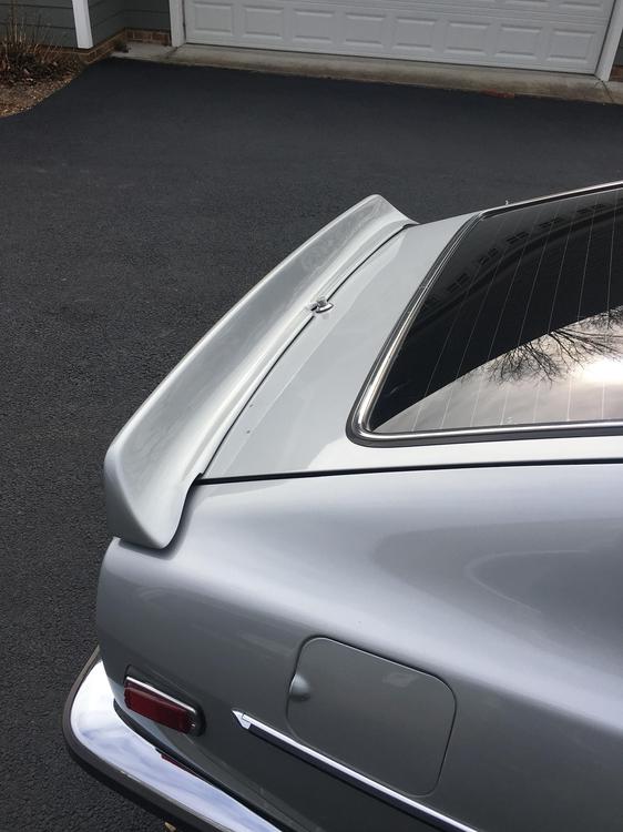

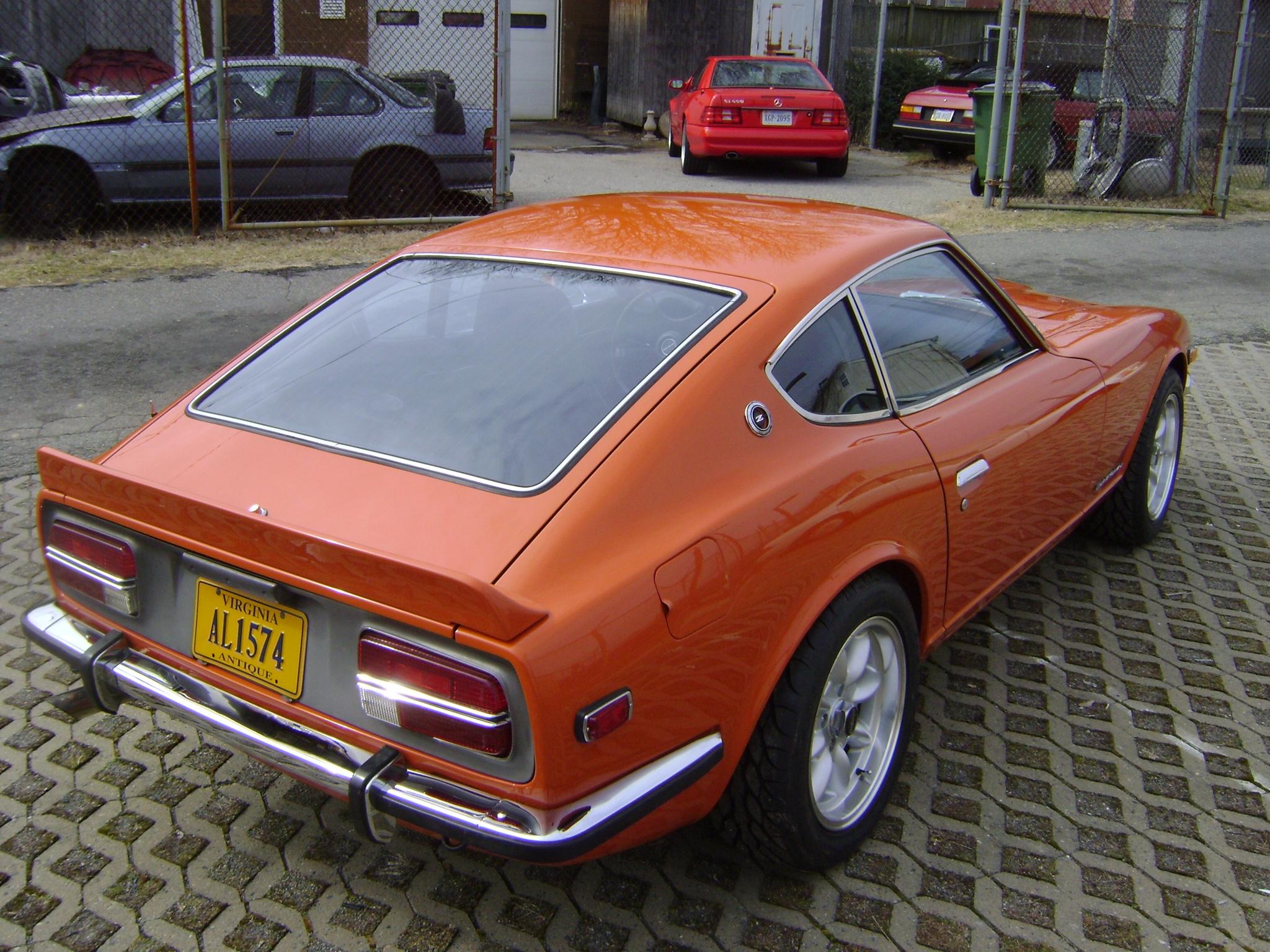

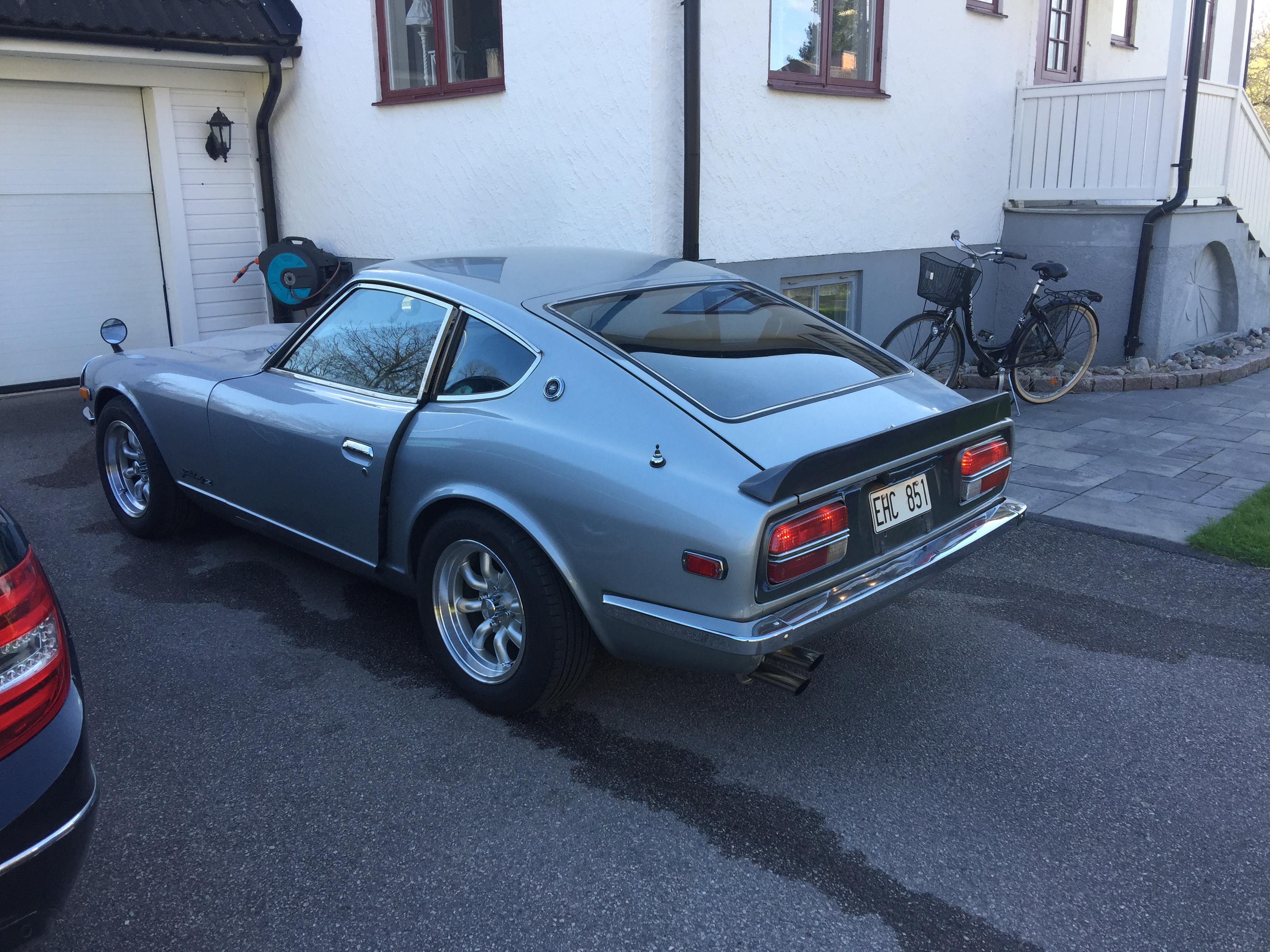

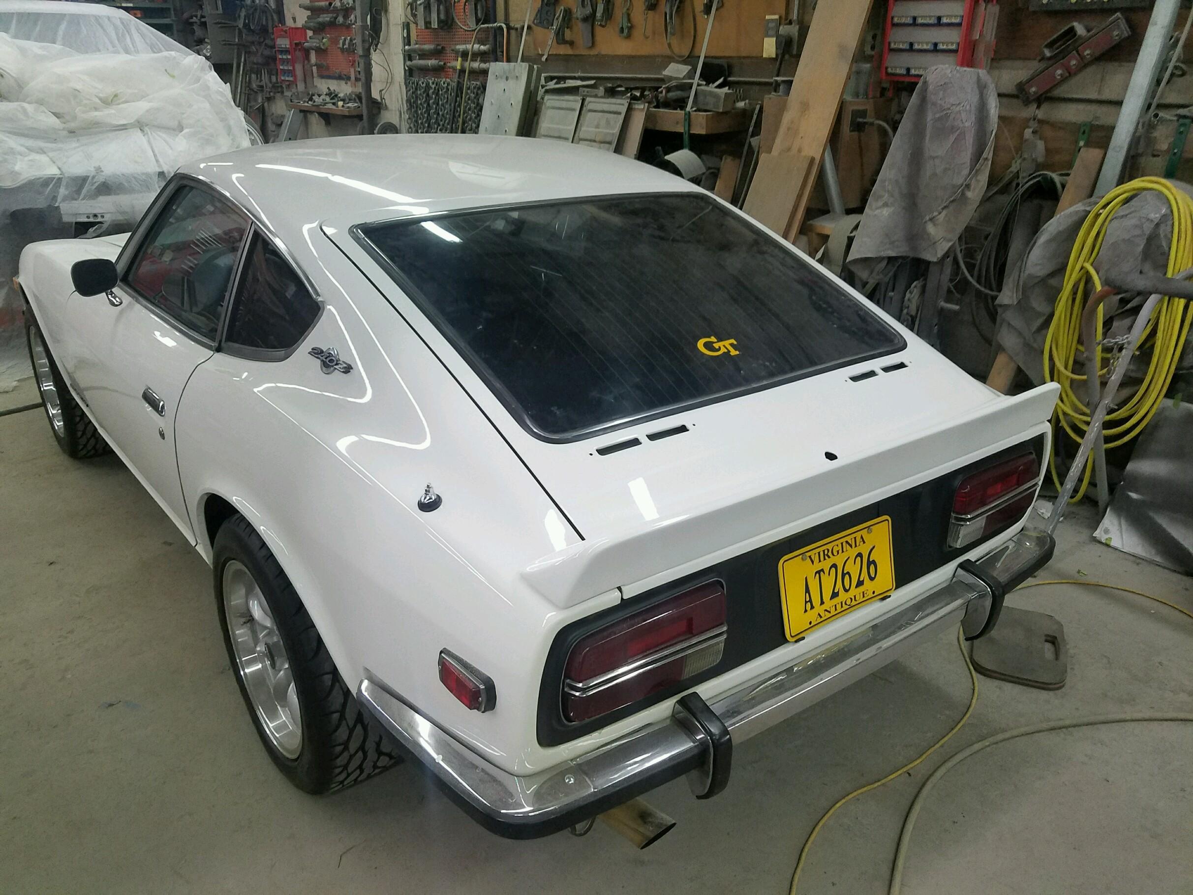

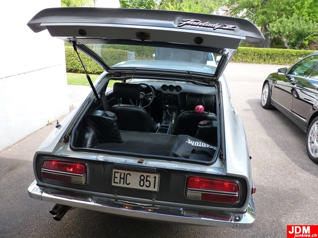

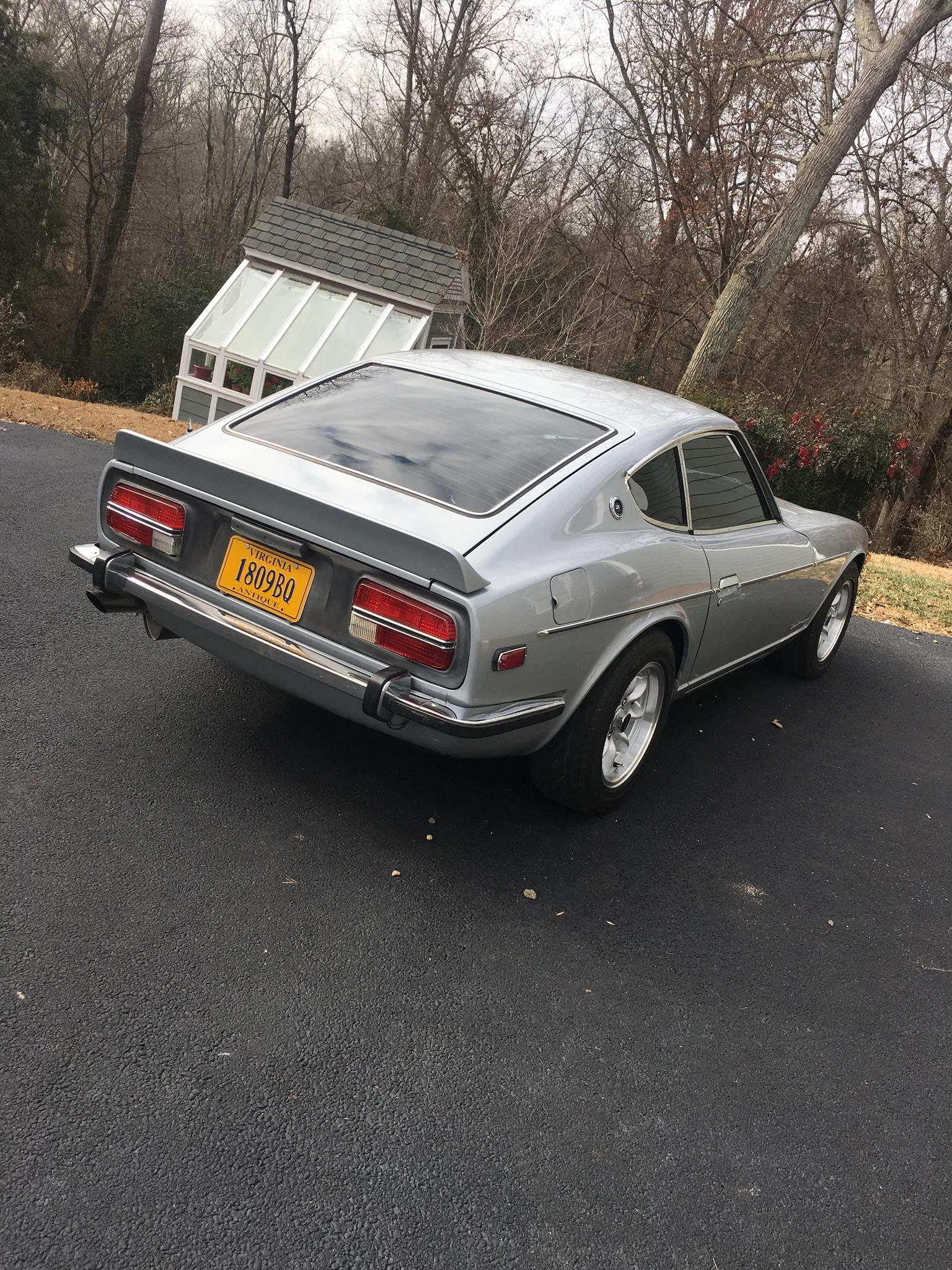

here's my rear spoiler as mounted from the dealership in 1972.  It's mounted right before the hatch rolls down.  That was one of the hardest things I've done that I thought would be easy.  Take the vinyl cover off the interior side bottom of the hatch to access the bolts.  Getting the nuts on are a huge pain in the rectum.  Good luck!

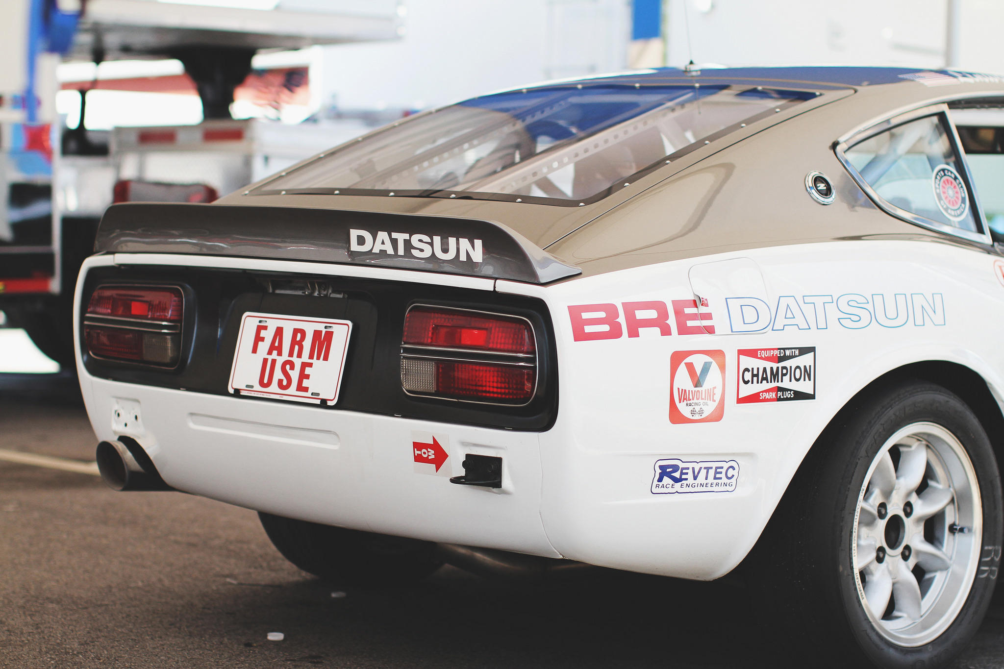

Not my car but the 432

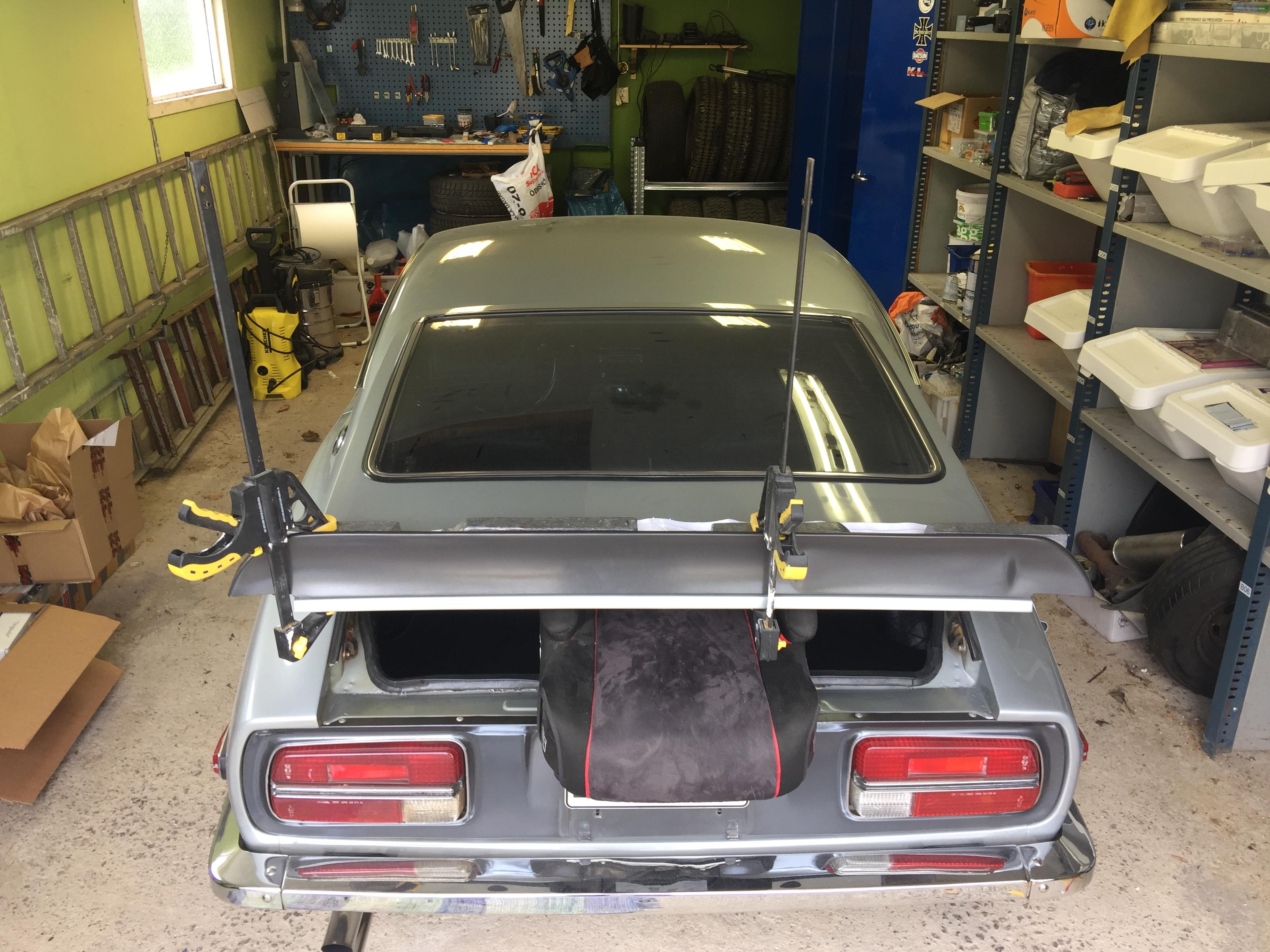

My 2c... Dont drill, use tape.
33CB5FEB-0C2A-4FA0-8A91-51B9FD41CA6D.jpegCFEC24AF-4667-4E1C-8C89-E236FEBC5C5F.jpegF164D9A6-8EC4-4505-9510-74146996AF0F.jpeg78292907-B7DD-4363-85B5-C8FCE5DFBDF3.jpeg
If I ever do it again tape will be used.
I did put rubber fender washers under the bolts. Keeps the spoiler off the paint.
