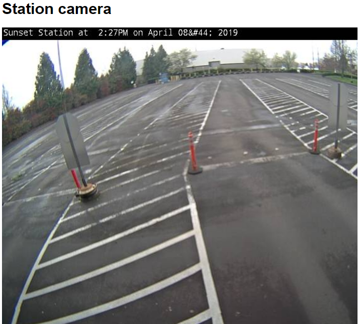

April 8, 20195 yr Author comment_572913 It's the DEQ fee plus the registration renewal fee, good for two years. It all happens at the DEQ facility and you get as many trips through as you need to get it to pass. Very convenient. They even have a camera so you can get an idea of how busy they are. Closed today. https://www.oregon.gov/deq/Vehicle-Inspection/Pages/Sunset-Hillsboro-Station.aspx Link to comment https://www.classiczcars.com/forums/topic/61955-emissions-saga-and-a-home-test-for-idle-settingtuning-tip/?&page=2#findComment-572913 Share on other sites More sharing options...
