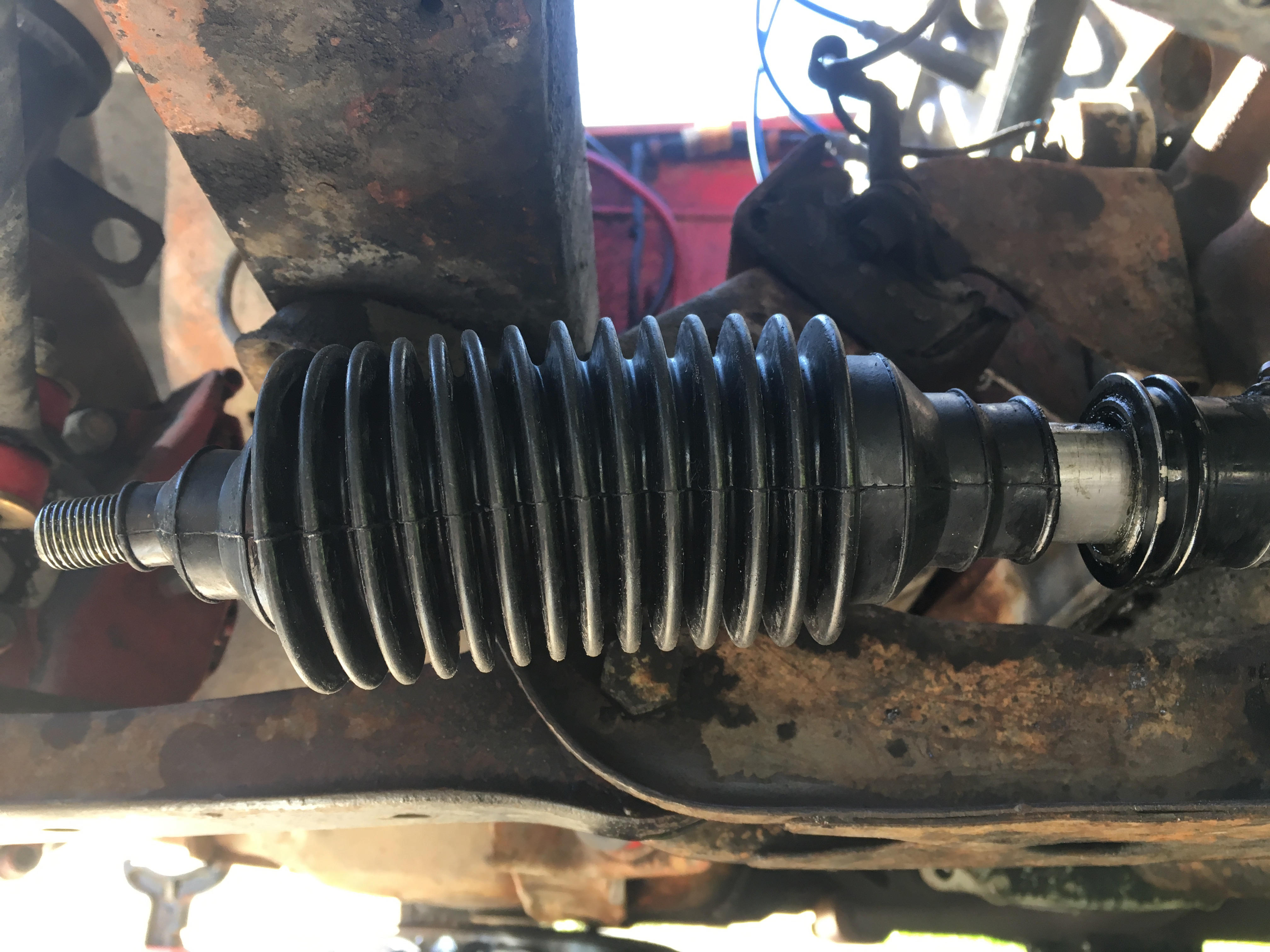

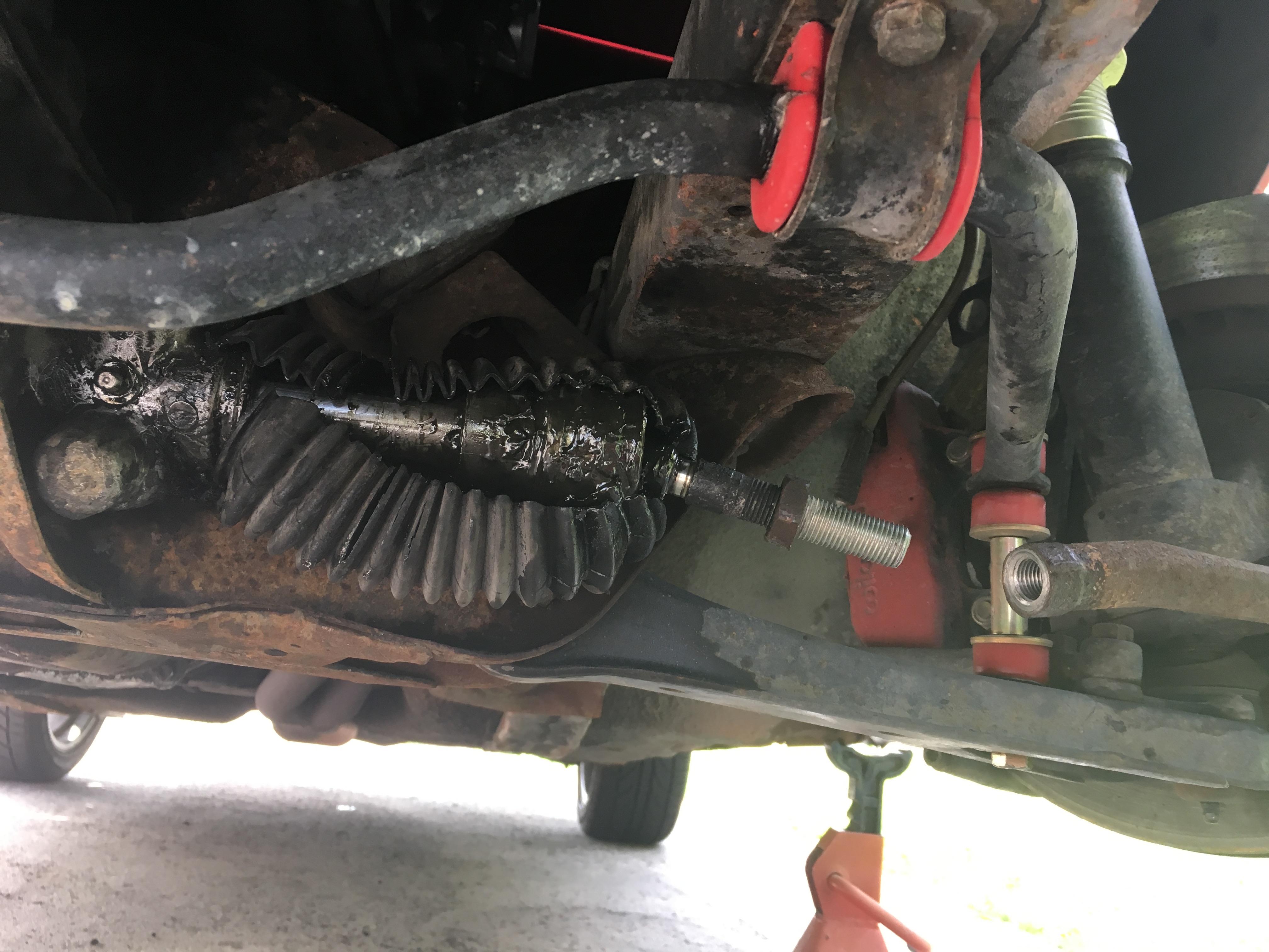

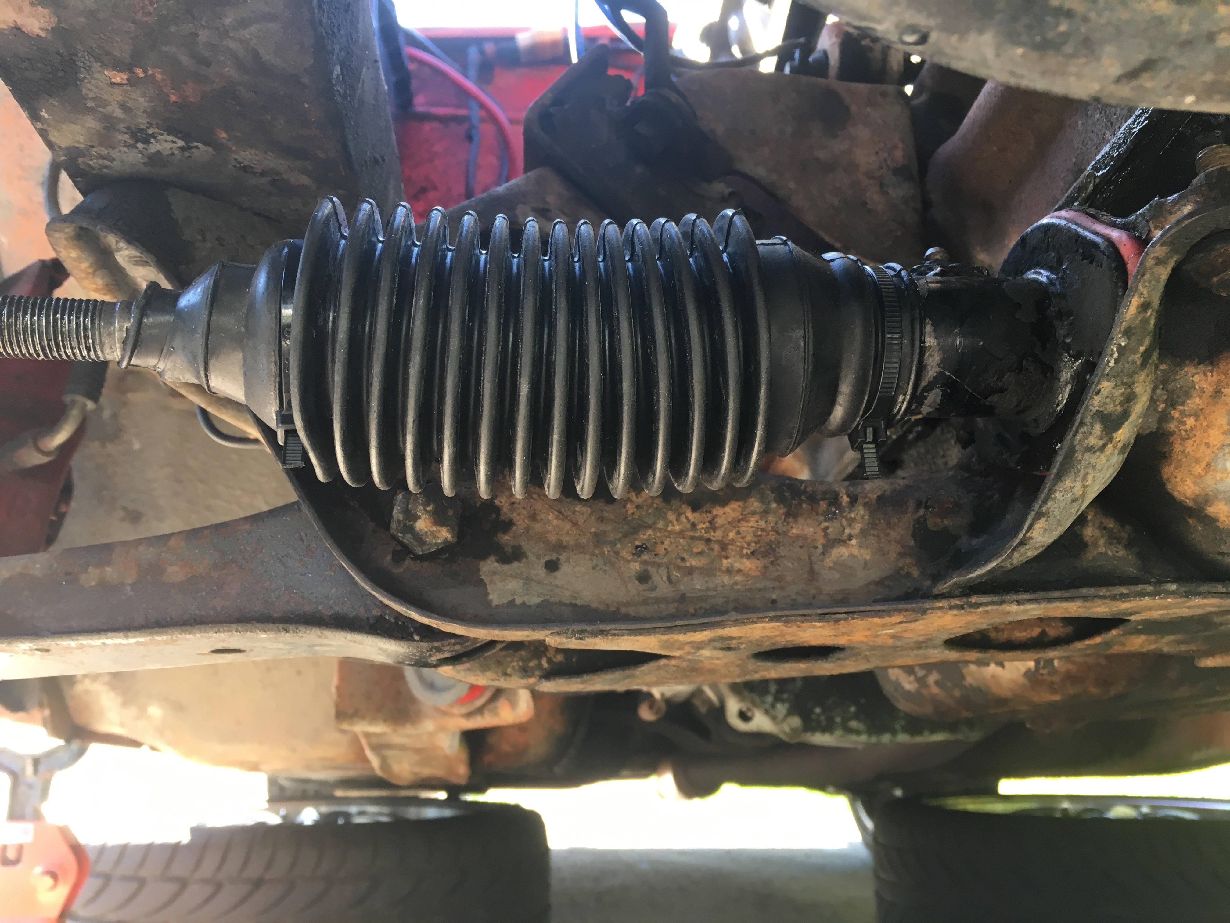

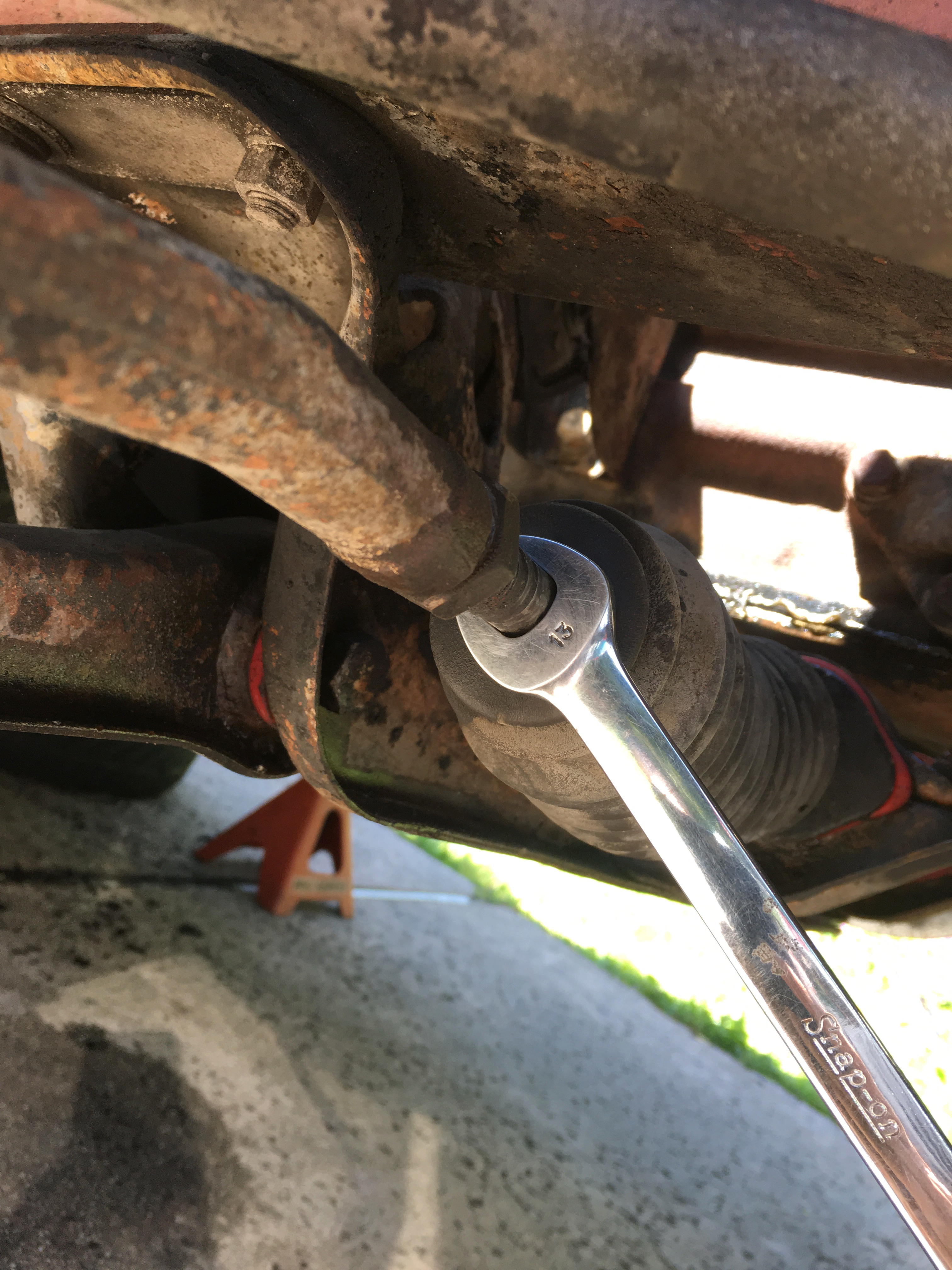

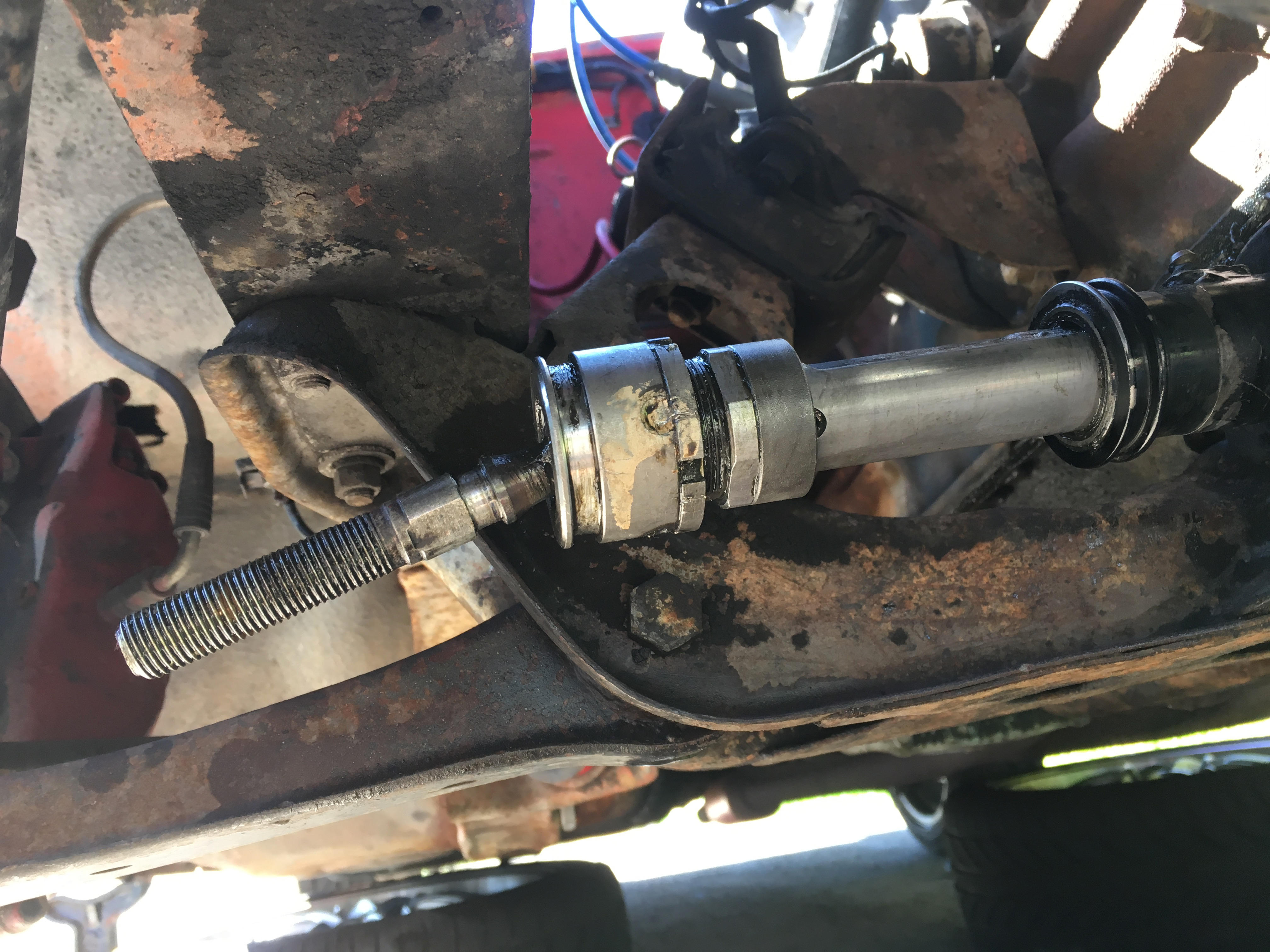

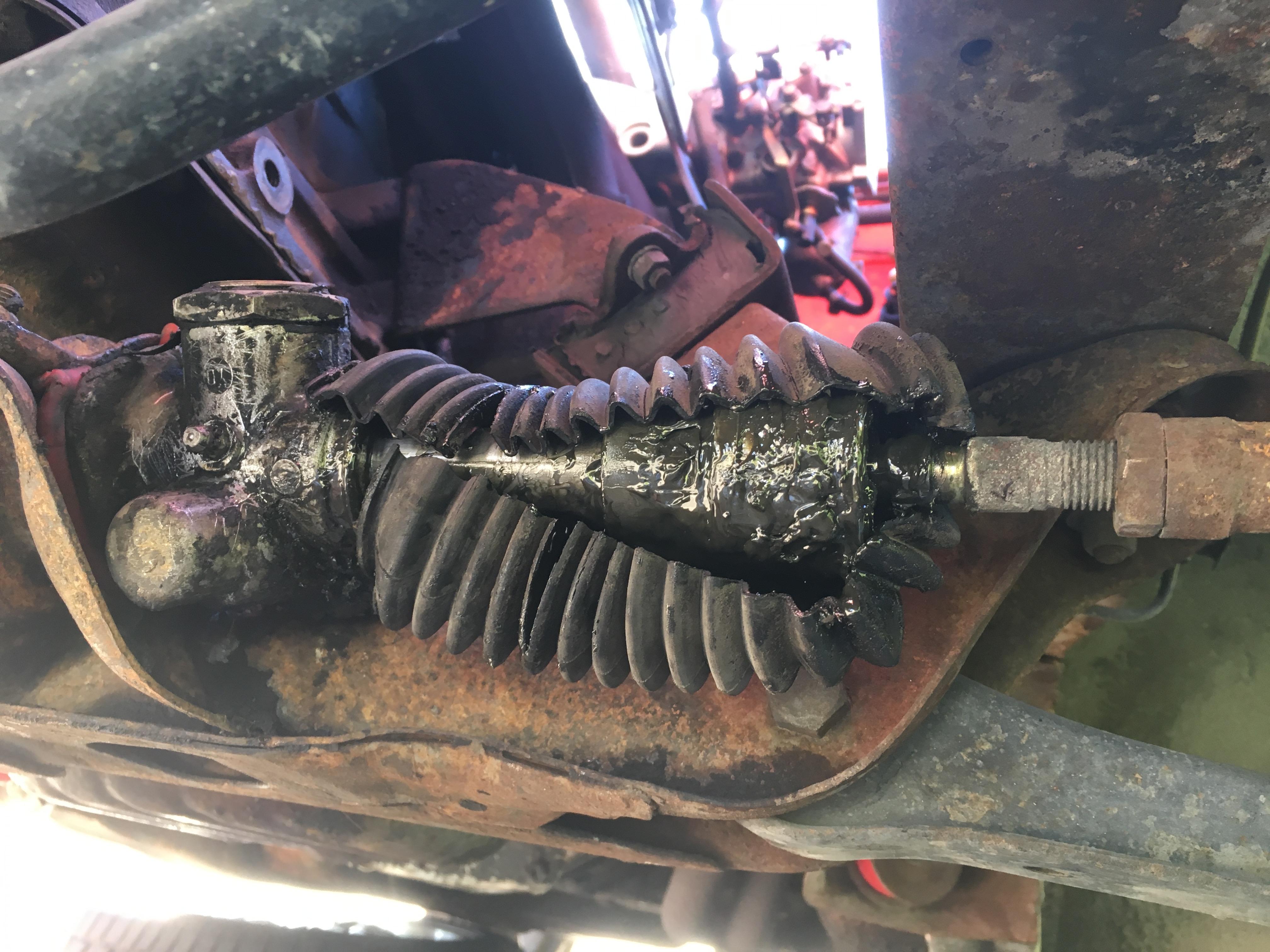

Steering rack accordion boots were trash.  Bought 23-4459 boots from MSA.  First image sequence is for the passenger side.  Unscrew the tie rod ends, clean the half shaft, install the new boots (had to trim one section from the small end, about 1/2" to clear tie rod nut), fill with grease, install tie wraps.  Start with a full tube of fresh grease, so you don't run out half way and have to drive to 3 auto parts store looking for the same kind.  Doh.

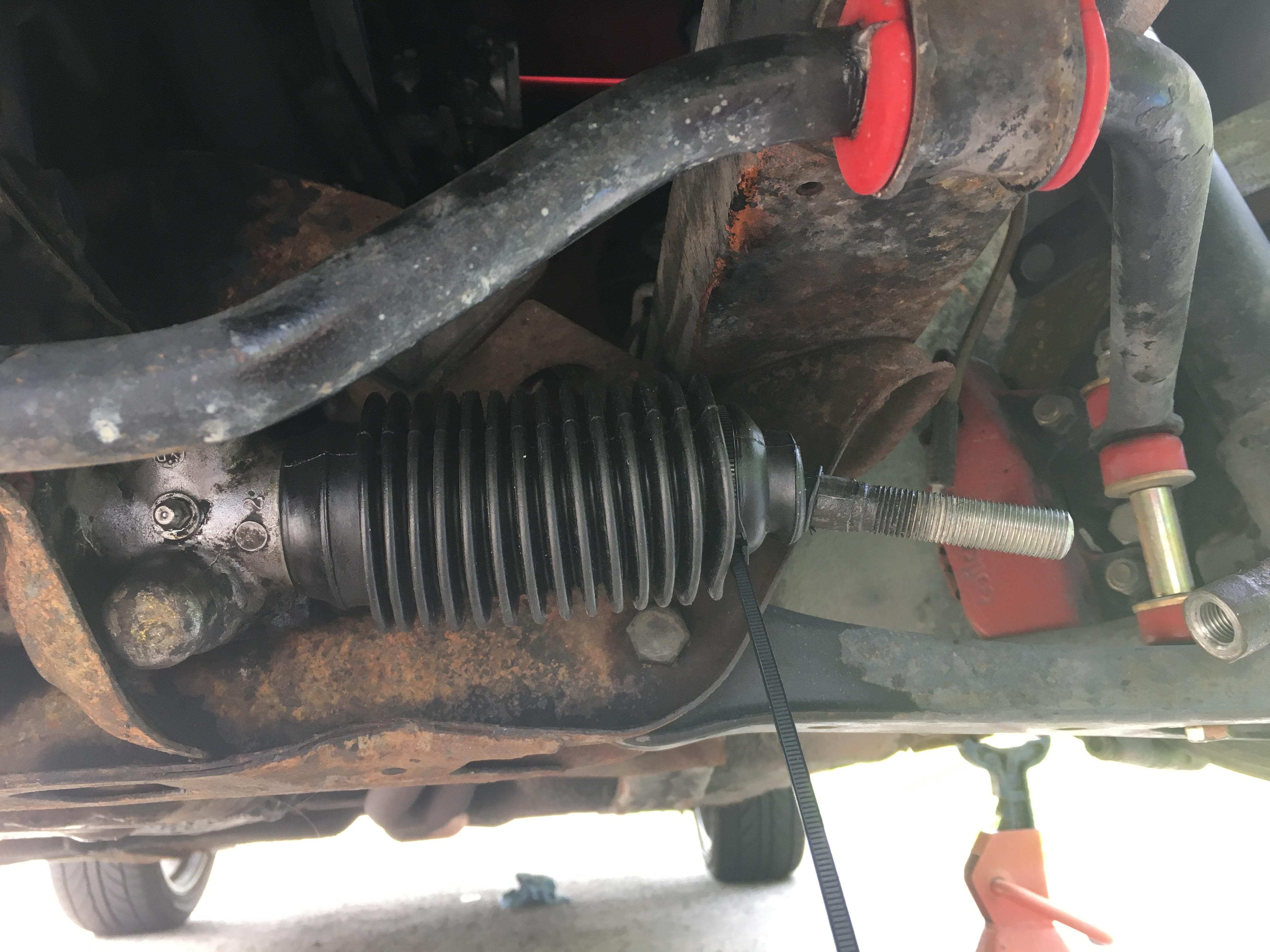

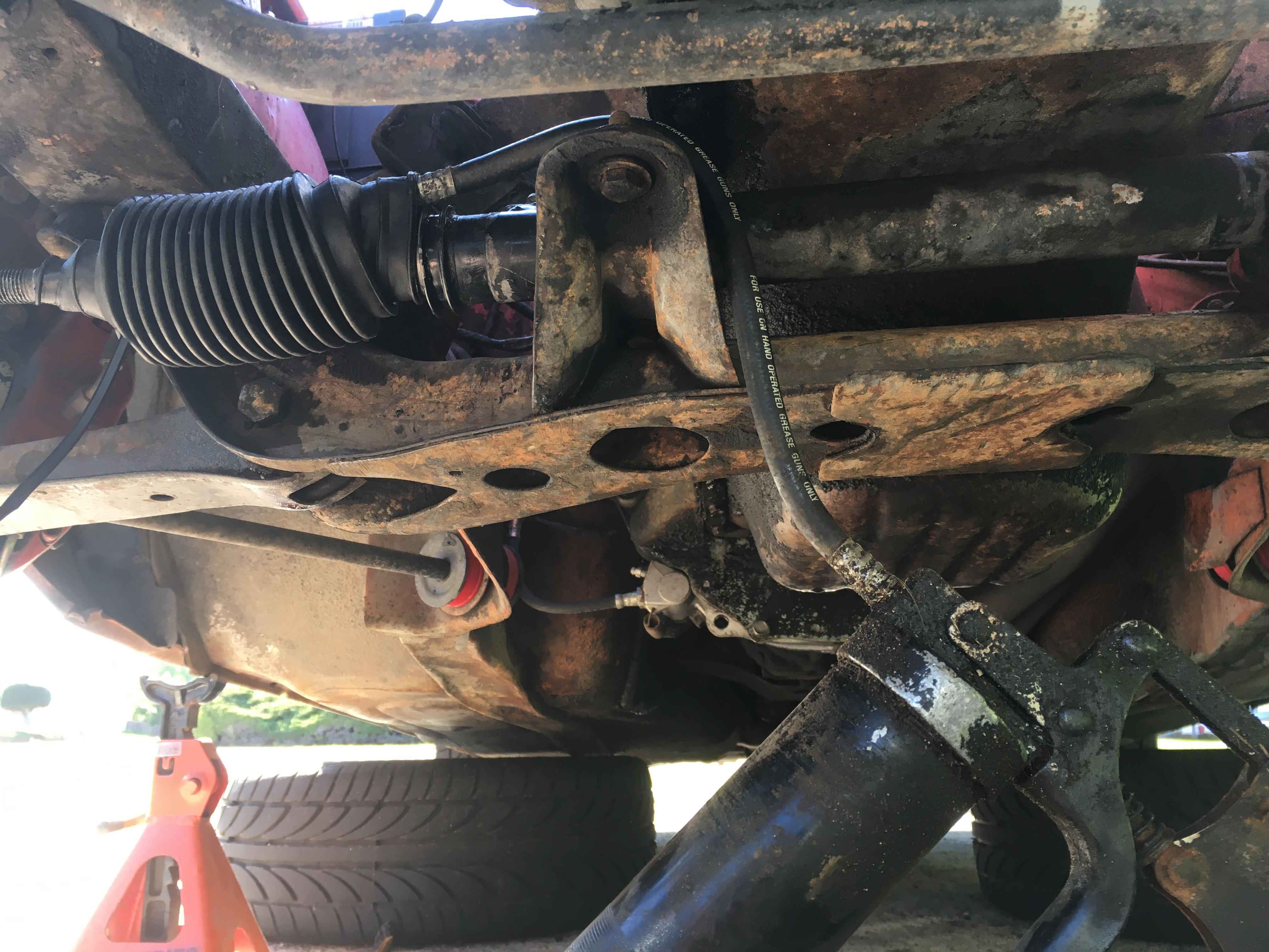

Second image sequence is for the driver side.  Basically the same drill, although had to trim one section from the big end of the boot, so it would fit.  Took the opportunity to degrease the steering knuckle.  Greased all the zerks afterwards.

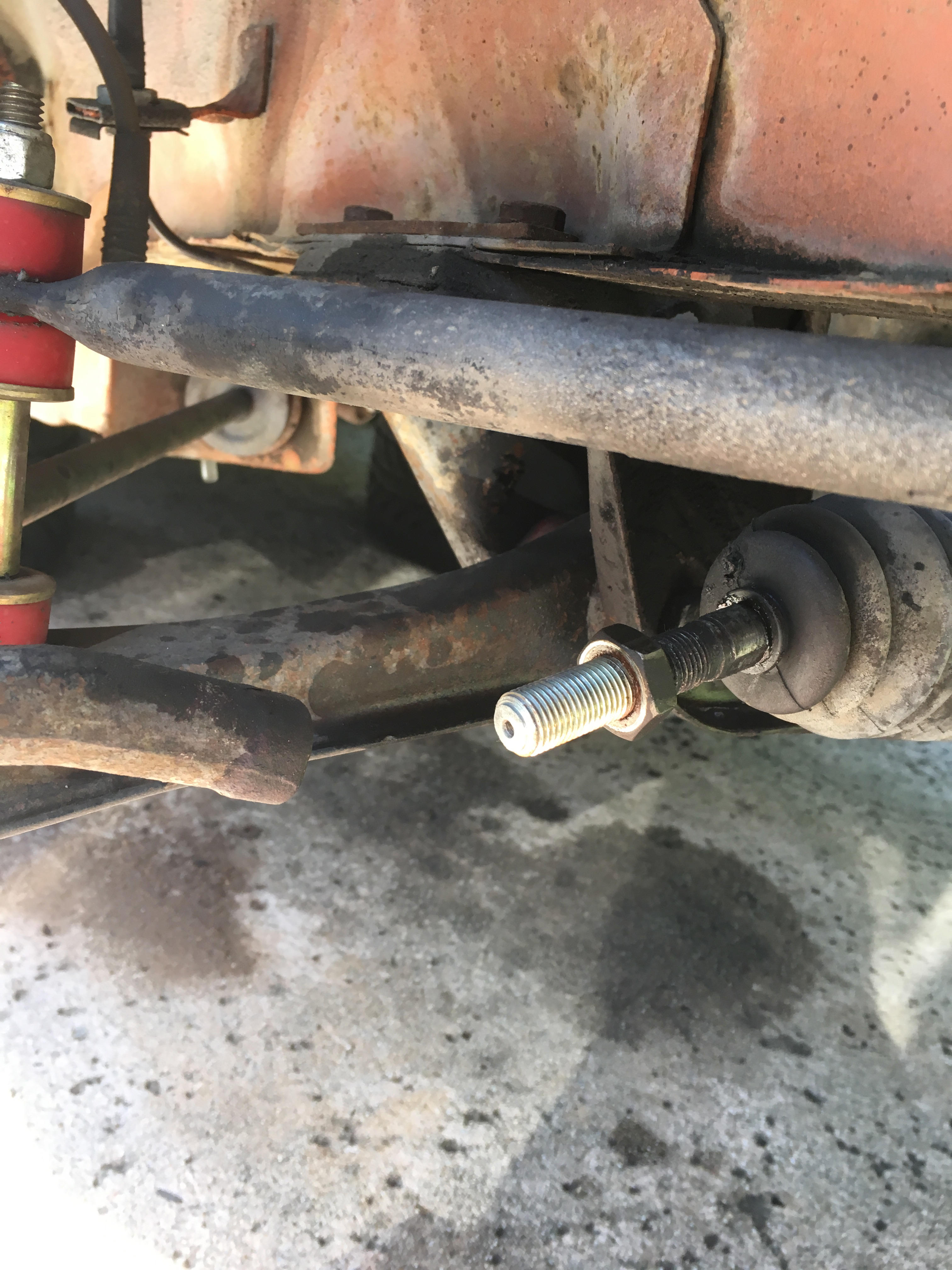

Didn't find it practical to count how many turns required to remove the tie rod ends, in order to put them back together w/o realignment.  Way too imprecise.  Just looked for where the tie rod had no grime, turned it in that far.  See "passenger tie rod end removed.jpg"  Plenty good enough to drive car to Wheel Works for alignment.

Good job,  just one minor thing that could turn into major, the tie wraps on the outboard end of the boots go on the very end of the rubber so they are tight around the smooth section of the threaded rod.  Where you have them now dirt can still get in and foul up the ball joint.
