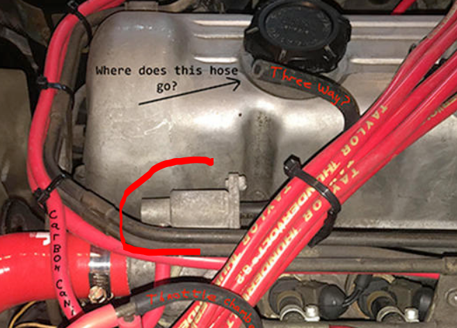

2. Many of the vacuum lines were broken and needed to be replaced. However, there are a few we cannot figure out. There is a three way vacuum line connector near the distributor. The three hoses that are currently connected to it are:
  • The distributor advance vacuum line
  • Throttle chamber vacuum hose
  • Anti-stall dashpot
         From what we are reading the anti-stall dashpot, should not have a vacuum hose connected to it
          Additionally, the one hose from the vacuum switching valve is not connected to anything
          Any help getting these figured out would be highly appreciated!!
Welcome to the club!     :beer:
You are reading the manual correctly. There should be nothing connected to the anti-stall dashpot. Even though it looks like a vacuum nipple, there shouldn't be any hoes on it. The dashpot should just be left open. And a couple of the other vacuum lines are mixed up accordingly.
The non-California 76 cars (which it appears yours is) used a system to disable the distributor vacuum advance until the car is in top gear. Not sure why they thought this was necessary, but in 77, they decided this was not necessary and eliminated that feature.
So if I'm reading the manual correctly (pages EC-9 and ET-1), it appears the three-way line from the throttle chamber should go to:
  • Throttle chamber connection
  • Carbon canister control
  • Timing control solenoid valve
And then the other side of the timing control solenoid valve should go to the distributor advance connection.

Here's that timing advance control solenoid that CO mentioned.  It lets vacuum through to the vacuum advance can on the distributor when you're in 4th gear.  There's an electrical switch on the transmission.  I think that it's really an emissions device.  It should probably have the dashpot hose connected to it.
If those hoses are messed up. your ported vacuum and constant vacuum sources might be too. Better check.
