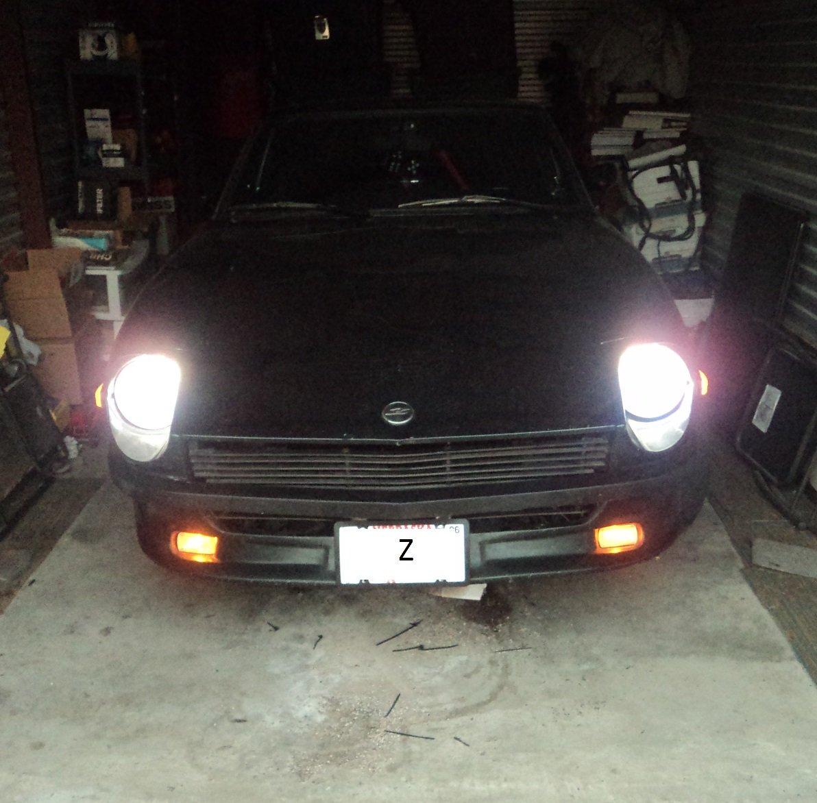

Mine had the front "air dam" when I bought it.  I found a 240z grille and put it on, had to kind of rig it up to fit though.  I also got rid of the stock signal lights, and found some aftermarket fog lights that fit into those 2 "brake duct" openings.  I removed the fog light bulb and routed the turn signal lights to these housings.  It was a lot of "rigging", but it works and I think it looks great!  Those are also H4 Headlight upgrades.
