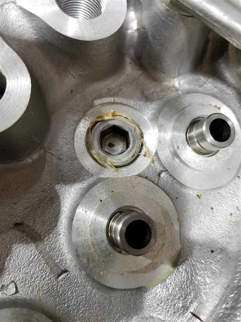

So here's a question for the collective... This is a pic of one of the plugs in the head from the casting process.
Looks like Teflon tape sealing the plug. Was this factory, or did my PO have these plugs out and use Teflon instead of thread lock? Here's what I got:
All of the L series heads I have looked at have Teflon looking tape for these plugs. I am not sure though whether it is some sort of special tape that is resistant to oil or simply Teflon tape. I would like to know what others think or know abut this tape.

Thanks again guys.
