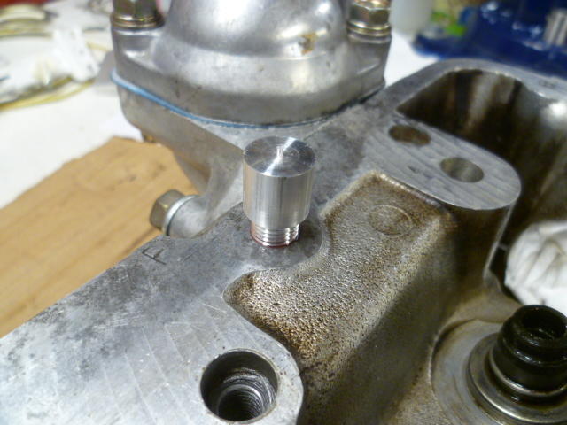

Haha!! I didn't see stamps on the block for that, but I did see a stamp in the head "F".
Here, you can see it to the left of the plug I put in up by the thermostat housing. I'm trying and trying to convince myself that it does not mean "Front":

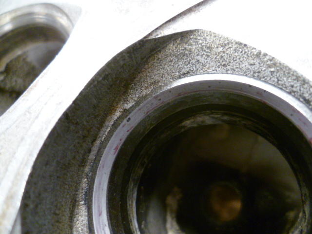

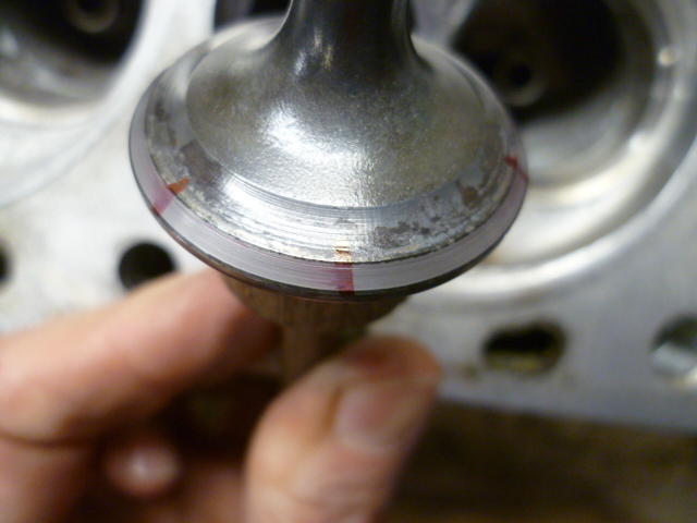

What I'm doing instead kinda goes like this. Under magnification and with the use of some sharpie marks on the sealing surfaces, I've tried to match up the correct valve with the correct cylinder. And then after that, I'm lapping them to match the seats.
For example... Here's one of the seats before I've done much of anything to it. The valve that WAS in this location wasn't even close to making contact on most of the seat. I managed to find one of the other exhaust valves that was pretty close. Here's what I'm starting with:

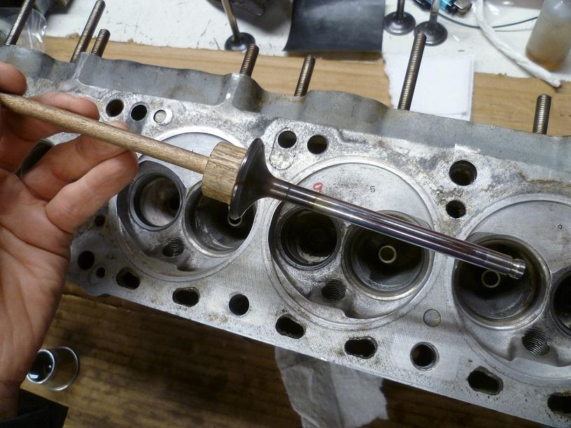

Here's my handy-dandy valve lapping "tool". I use double back sticky tape to hold the valve to the "tool":

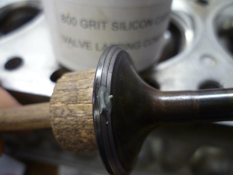

Some 800 grit lapping compound:

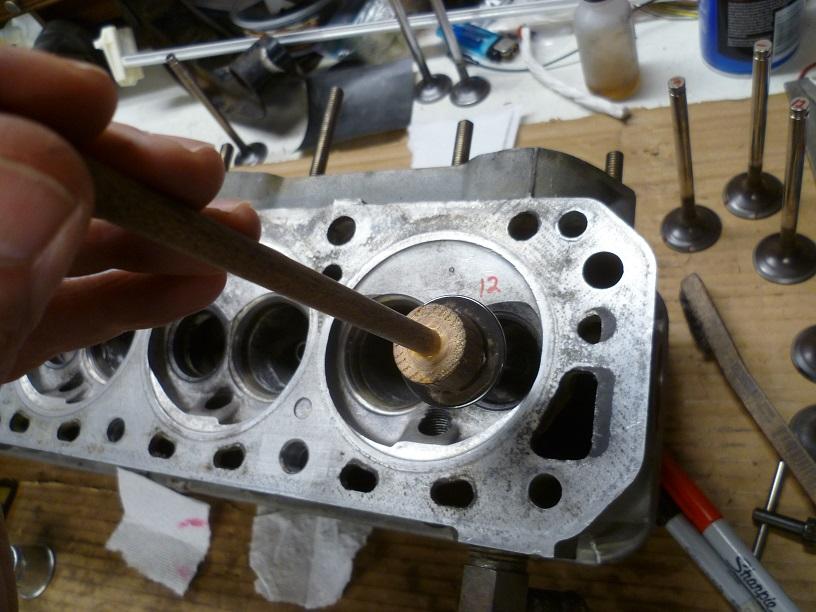

And I work the pair:

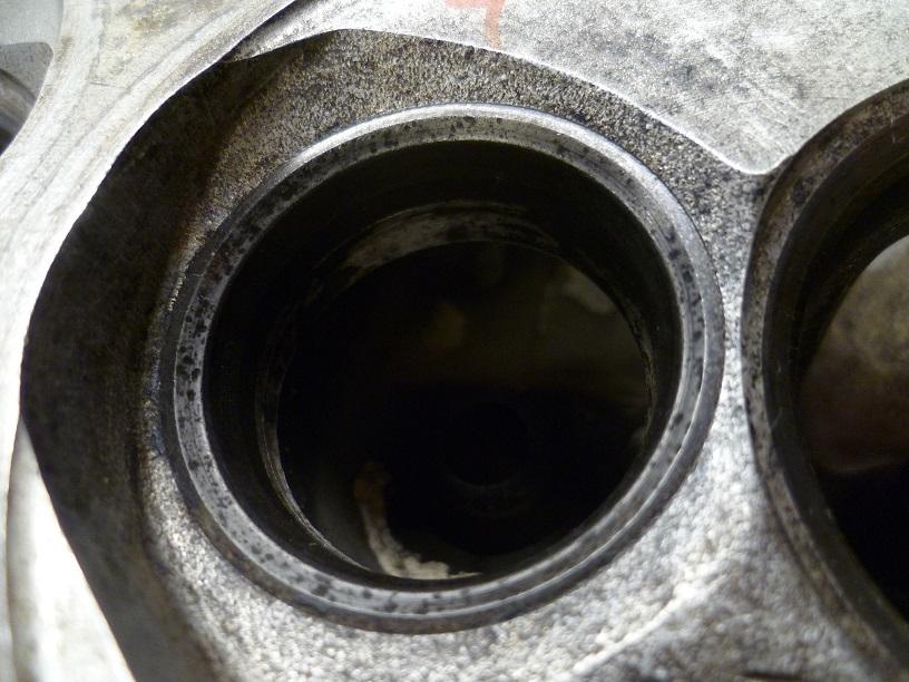

until I have something like this. Smeared contact markings over the entire seal:
Yes, there are still a few pits on the valve seat, but I'm not looking for perfection here. I'm just looking to be able to drive a little bit more on this engine until I finish the F54/P79.
What I'm ending up with is 1000 times better than what I started with!!
