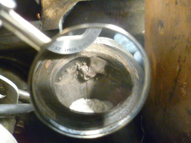

July 31, 20195 yr Author comment_580871 So I'm still waiting for alignment dowels and head gasket to get here. In the meantime, I spent a little time cleaning up the header surfaces where they mate with the head. My PO put on a 6 to 2 header of unknown origin. No idea where he got it. So I'm looking it over and see huge welding goobers inside the tubes and pieces of MIG wire stuck in there from where the guy who welded it got the wire stuck and burned off pieces of it. Here's the worst. About an inch of wire stuck in there: I pried it up with a screwdriver: And pulled it out with a pair of pliers: And there are other testaments to the workmanship, like this huge goober. It was on the upper side, so I used a little mirror to get a good pic. I stuffed a paper towel down the pipe a little and tried to pry it loose. No joy. I'm leaving it in there: So today's question(s) is... What welder has so little pride in his work that he'll leave junk like that in there? Is it just me? Are my expectations too high? Link to comment https://www.classiczcars.com/forums/topic/62173-complete-misfire-on-three-cylinders/?&page=18#findComment-580871 Share on other sites More sharing options...
July 31, 20195 yr Popular Post comment_580889 The mark of a true Craftsman is one who cares about quality more than time and money. Are your expectations too high? Not at all. I suspect that the PO or his mechanic had never done quality work and didn't understand the concept of Craftsmanship and pride in a job well done. Link to comment https://www.classiczcars.com/forums/topic/62173-complete-misfire-on-three-cylinders/?&page=18#findComment-580889 Share on other sites More sharing options...
