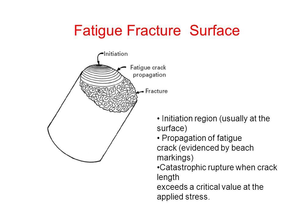

So, what intrigues me is what was the mechanism for the failure. Is it possible something got in the head and jammed the cam for a moment. Why did it break where it did? Either the cam experienced some sort of trauma or it was faulty and had a small stress riser that finally gave way.
I took a 4 week course on aircraft accidents and we had a structures class that focused on metal fatigue and a lot can be determined by looking at the fracture. You can tell If it failed slowly or immediately. I’d think the area most prone to cam fracture would be where to sprocket connects. This is where the load is being applied.
