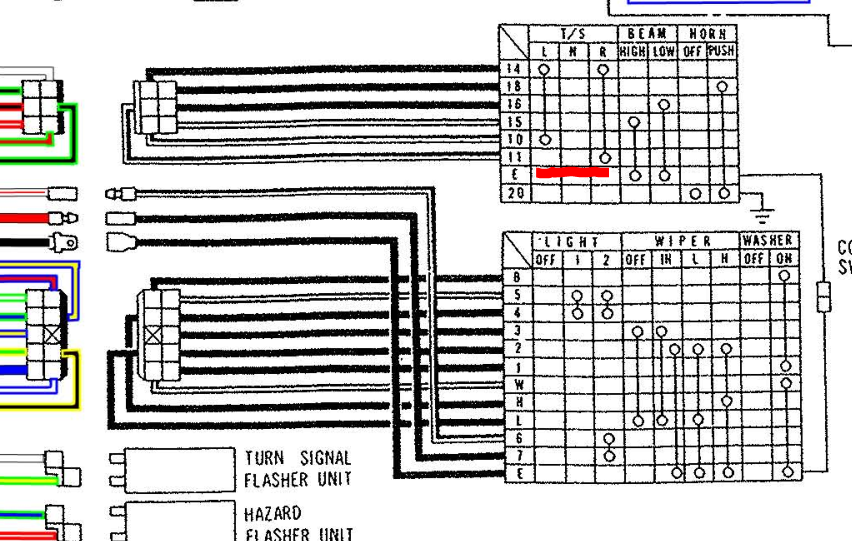

Here is the source of the color wiring diagram - https://www.classiczcars.com/files/category/1-wiring-diagrams/

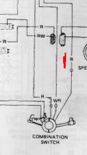

And the FSM has the schematic of the combination switch.  B is the key.  It's a pain tracing out all of the wires.  I'd draw a diagram of the socket and label each one.  Then take your meter and make sure that you have continuity through the switch when you should.  Also check your grounds to be sure that they actually ground.  The lights are all about the ground circuit.

So you're making progress.  Not clear what "proper wires switched on" means.  Sorry.  Just don't know.  Based on the diagram you should be able to take the pug that connects to the combo switch and jump the wires to see if it's the lights or the switch.  Be the switch.  Make sure you pick the right pins, and use a test light as the jumper if you want to be safe.  The test light will stop you from creating a dead short.

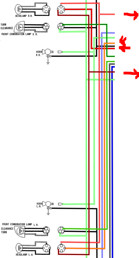

In your case, since you have high beams, it might be a bad connection at one of the connectors on the way back to the dimmer switch.  It looks like C-2 is on the low beam circuit, it doesn't branch off to the high beam indicator.  Red with black stripe by the color diagram.
Good luck.  It's a tough one.  High and low share the same power source so it has to be on the ground circuit if the high beams work.
