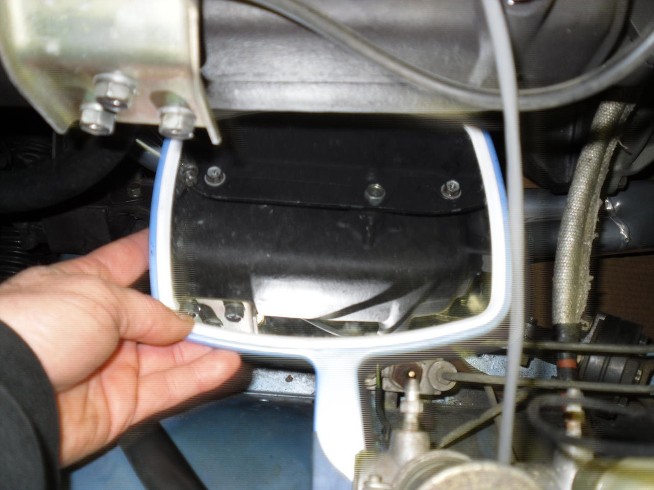

Don't forget the EGR system.  It's a known problem.
I had a problem with my EGR.  You take a handheld mirror and look under the intake manifold closest to the windshield.  The coupling hooks there, mine was loose for who knows how long and rotted out my EGR chamber? I think it's called.
This is after I replaced everything but gives you an idea of what I'm talking about.

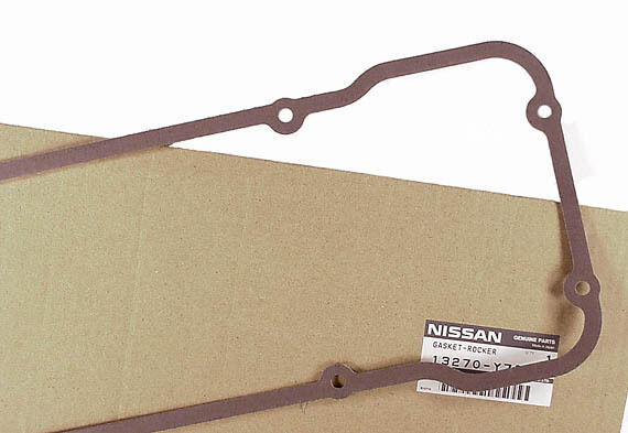

Another thing that happened to me, and me only apparently 'cause I'ma stupid sometimes, I put the valve cover gasket on upside down and created a small opening above the thermostat housing.  They have a straight side and mine was opposite.  I know that's not your leak but it's something to look at.
