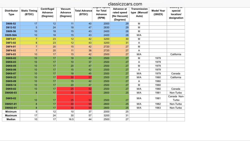

Mine would be a 72 with US emissions so the numbers match what I'm seeing. Thanks for the chart!
You need to double check the actual numbers on the dizzy against the chart unless you're positive the dizzy has never been changed in 50 years

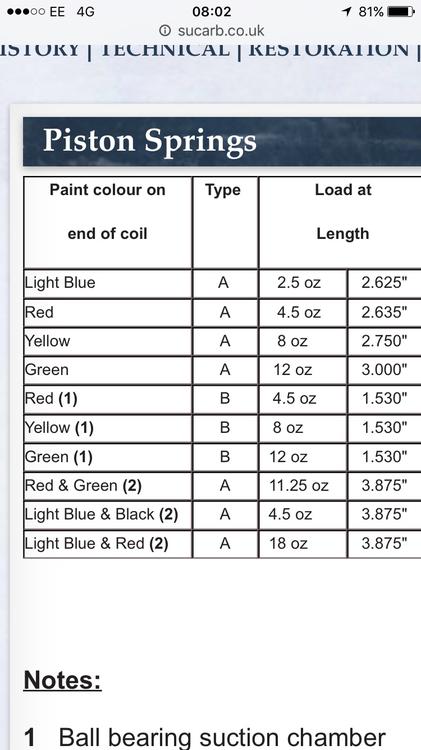

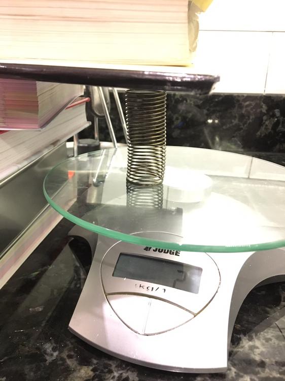

The only thing I would add to your list would be to check the springs are pushing equally. I just used some books and kitchen scales to measure at a compressed height of 65mm. If different between carbs, the piston heights at WOT conditions will be at different heights.
05b2760c881607b16c316ed1ba46b5d7.jpg&key=69c5c6a97e93bcaddd7311a902e63d0b0956c7b6b760ccb4adf7329721ed1956
Here's a table of HS6 alternative springs / ratings.

On a different note I did check my distributor and its a D612-53.  not a lot of info out there on this one.  One site kind of indicated that it was a replacement for the D612-52 but it wasn't clear.
