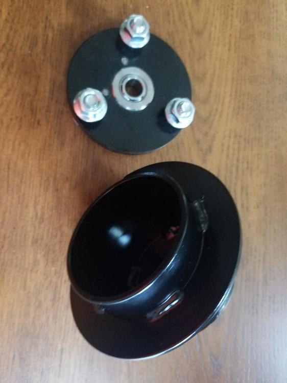

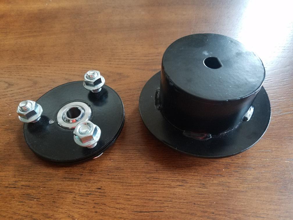

May 22, 20195 yr comment_575958 Hi All, I'm in suspension hell. Sure the Z vets out there who've gone through the fire prior are laughing. Cost is adding up rapidly as the shock towers were sent the local car shop for "F"ing gland nut and old cartridge removal. FYI - gland nut tool for $35.00 bucks does a fine job of rounding all the corners (not sure it the right size for the nut?), waste of money. Here my question, purchased Eibach progressive springs, Koni adjustable shocks and the new pillow ball spring seat and strut mount (see attached) from Motorsport. Anyone installed this set-up? Instructions on all parts are vague at best. The shocks have an aluminum sleeve that slides below the treads on the shaft, holds the bump stop? Concern, the original rubber insulator, not used on this set-up, the new spring seat mount and strut mount are metal on metal. Noise, vibration, banging or other? Would a thin piece of rubber between the two help? Any experience, tricks or advice would be great. Busted knuckles. Link to comment https://www.classiczcars.com/forums/topic/62198-strut-mount-insulator-oem-vs-after-market/#findComment-575958 Share on other sites More sharing options...
May 22, 20195 yr comment_575964 Post a link to the parts page. Never seen those parts before. Also, not clear what car you're working with. Link to comment https://www.classiczcars.com/forums/topic/62198-strut-mount-insulator-oem-vs-after-market/#findComment-575964 Share on other sites More sharing options...
