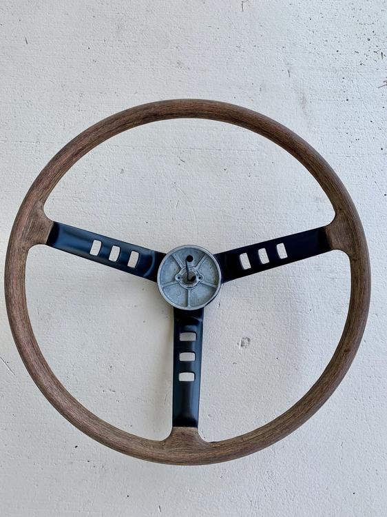

March 2, 20214 yr Popular Post comment_616881 I know this thread is a little old but I just finished my wheel and I believe it turned out pretty good and to me looks pretty close to the brechures that were posted on here. Anyways If anyone is interested in the full story behind my 71 240z I have a thread going here: https://www.zcar.com/threads/240z-worth-saving-front-end-damage.421423/ Edited March 2, 20214 yr by Clint Bizzle Link to comment https://www.classiczcars.com/forums/topic/62221-steering-wheel-restoration/?&page=5#findComment-616881 Share on other sites More sharing options...
March 2, 20214 yr comment_616889 WOW Nice light wood colour! Love it! Link to comment https://www.classiczcars.com/forums/topic/62221-steering-wheel-restoration/?&page=5#findComment-616889 Share on other sites More sharing options...
March 2, 20214 yr comment_616909 At first you did this: And then desided to go original! Yep i like your wheel! You've done a good job on it! 👍 Link to comment https://www.classiczcars.com/forums/topic/62221-steering-wheel-restoration/?&page=5#findComment-616909 Share on other sites More sharing options...
