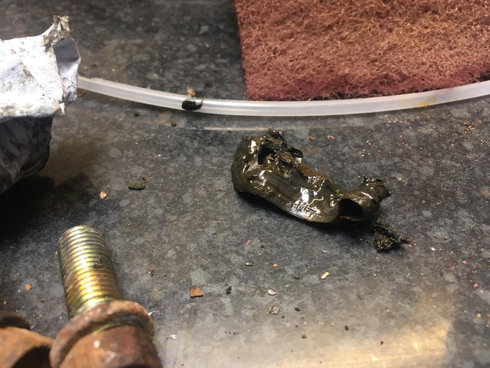

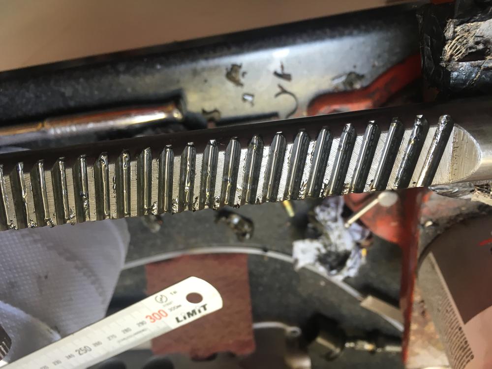

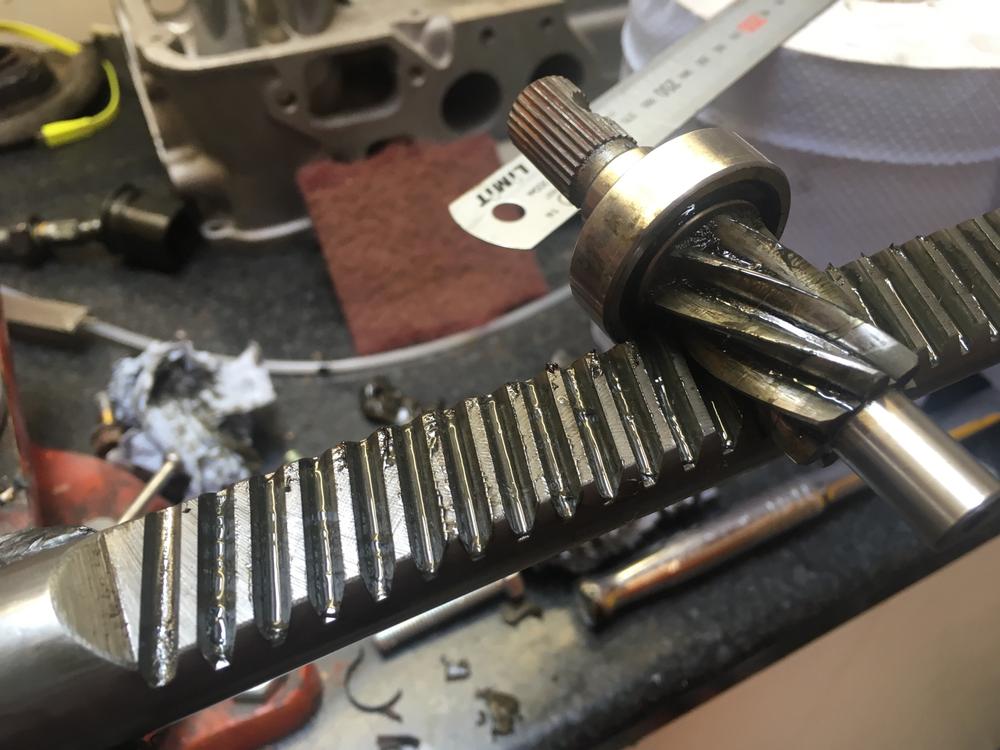

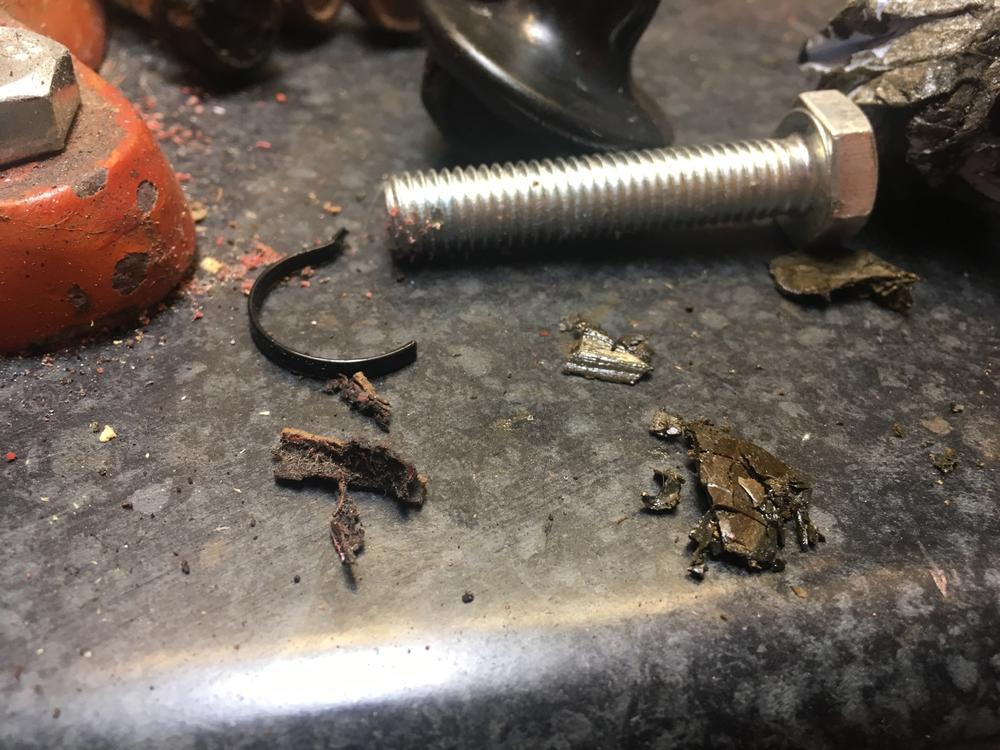

June 7, 20195 yr Author comment_577102 So pulled it apart, it seems not all racks are the same. This is pre-loaded on a brass bucket and spring. I've got it apart, can't find any wear, however can't rotate the any part as they're not ended the same. Lots of plastic hard 40 year old grease removed, which might have created the feeling of the 'notch'. a bit of wear on the brass bearings/shims inside the outer rack, however should be fine. i'll have to rebuild to check its just rock hard grease that's caused the feeling. I had to scrape it off with a stanley blade. What have others done when rebuilding theirs? Also how many have replaced the steering rod UJ? Mines got a good mm of play in it, its a service part So pulled it apart, it seems not all racks are the same. This is pre-loaded on a brass bucket and spring. I've got it apart, can't find any wear, however can't rotate the any part as they're not ended the same. Lots of plastic hard 40 year old grease removed, which might have created the feeling of the 'notch'. a bit of wear on the brass bearings/shims inside the outer rack, however should be fine. i'll have to rebuild to check its just rock hard grease that's caused the feeling. What have others done when rebuilding theirs? Also how many have replaced the steering rod UJ? Mines got a good mm of play in it, its a service part. Edited June 7, 20195 yr by Jason240z Link to comment https://www.classiczcars.com/forums/topic/62273-dreaded-steering-rack/#findComment-577102 Share on other sites More sharing options...

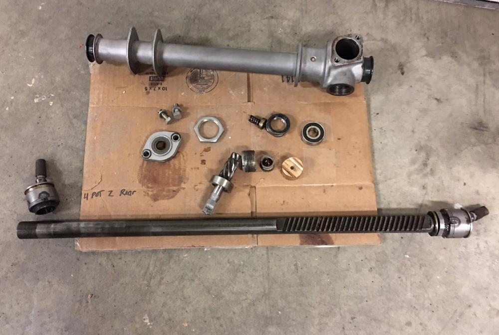

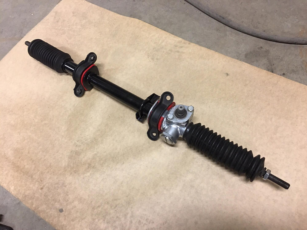

June 7, 20195 yr comment_577108 My ‘76 rack disassembled:And reassembled: Link to comment https://www.classiczcars.com/forums/topic/62273-dreaded-steering-rack/#findComment-577108 Share on other sites More sharing options...
