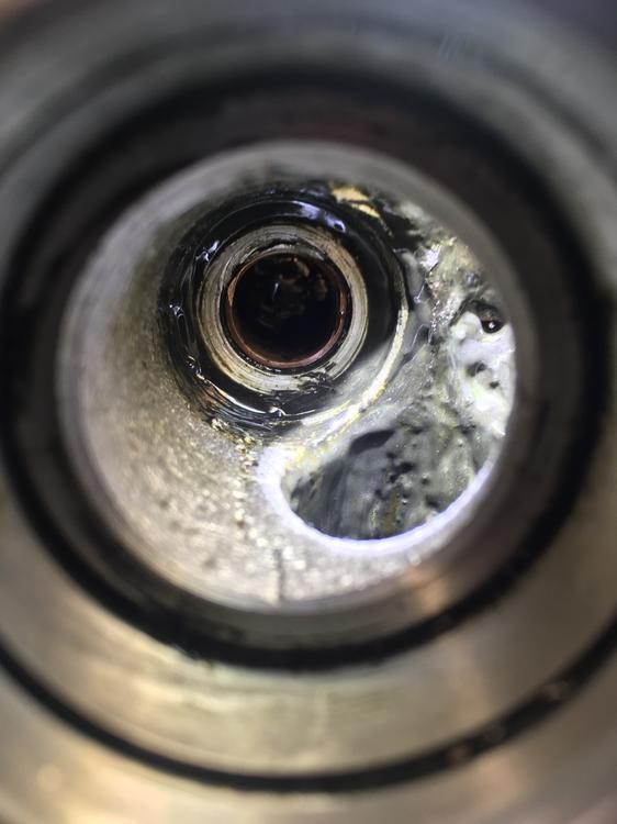

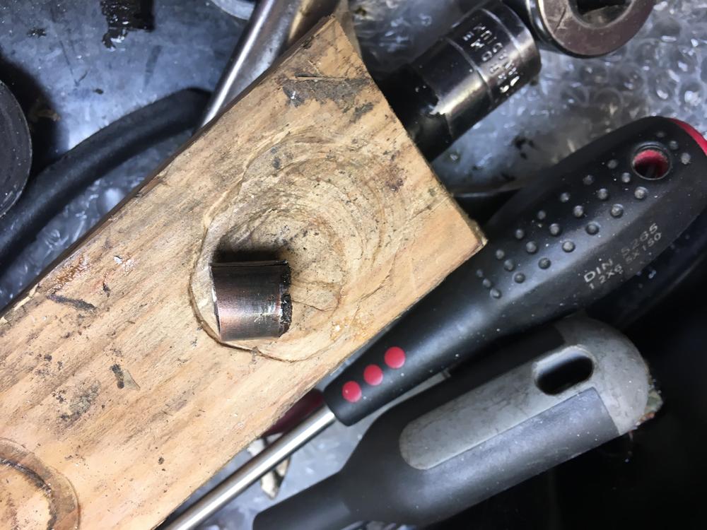

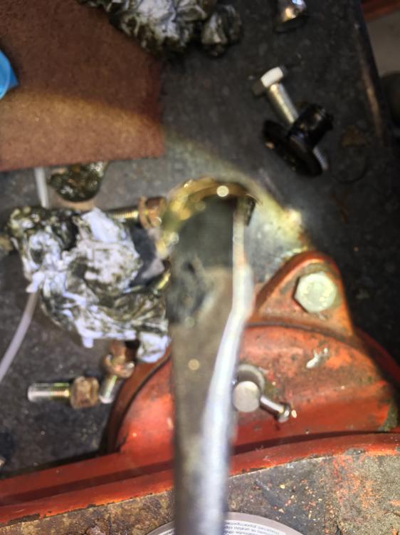

June 8, 20195 yr Author comment_577169 this is what I spotted.... Which is this Looks like the bronze bearing had moved Which would have been caused by this hairline crack I cut the end off to press the bearing out once the crack was found. Link to comment https://www.classiczcars.com/forums/topic/62273-dreaded-steering-rack/?&page=2#findComment-577169 Share on other sites More sharing options...
June 8, 20195 yr comment_577171 Well that's not good. Do you have another rack you're going to put in, or are you thinking you'll weld that crack up and reuse that rack? Link to comment https://www.classiczcars.com/forums/topic/62273-dreaded-steering-rack/?&page=2#findComment-577171 Share on other sites More sharing options...
June 8, 20195 yr Author comment_577178 I could do, Although I think i'll source another rack. @Patcon Thanks for the thread link, great thread. Link to comment https://www.classiczcars.com/forums/topic/62273-dreaded-steering-rack/?&page=2#findComment-577178 Share on other sites More sharing options...
