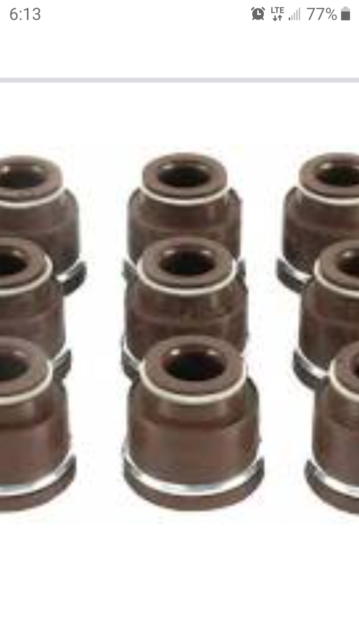

May 11, 20213 yr Author comment_621426 Thanks man. I really think the seal is broken or damaged. I already checked and swapped 2 distributor caps and spark plug 4 still gets fouled even after replacing it with a hotter one such as bp5es Link to comment https://www.classiczcars.com/forums/topic/62317-random-misfire-while-cruising/?&page=12#findComment-621426 Share on other sites More sharing options...

May 12, 20213 yr Author comment_621496 On 5/11/2021 at 5:57 PM, AK260 said: You’re most welcome. I would do exactly what Mark said above and leave the distributor alone for now. Ok. Ill go for it. Hope i dont mess the engine. I thought that since i bought the whole kit of valve seals taking the head out and replacing them was better. Link to comment https://www.classiczcars.com/forums/topic/62317-random-misfire-while-cruising/?&page=12#findComment-621496 Share on other sites More sharing options...

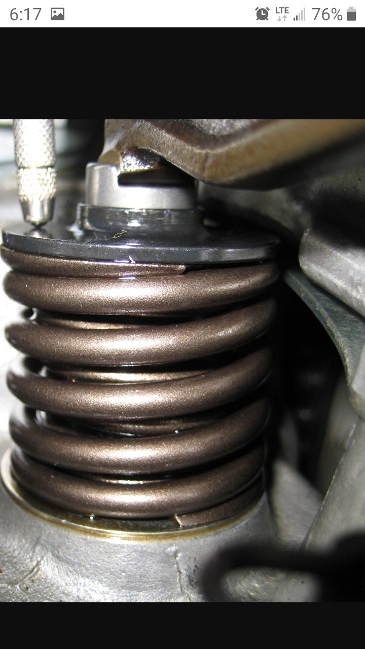

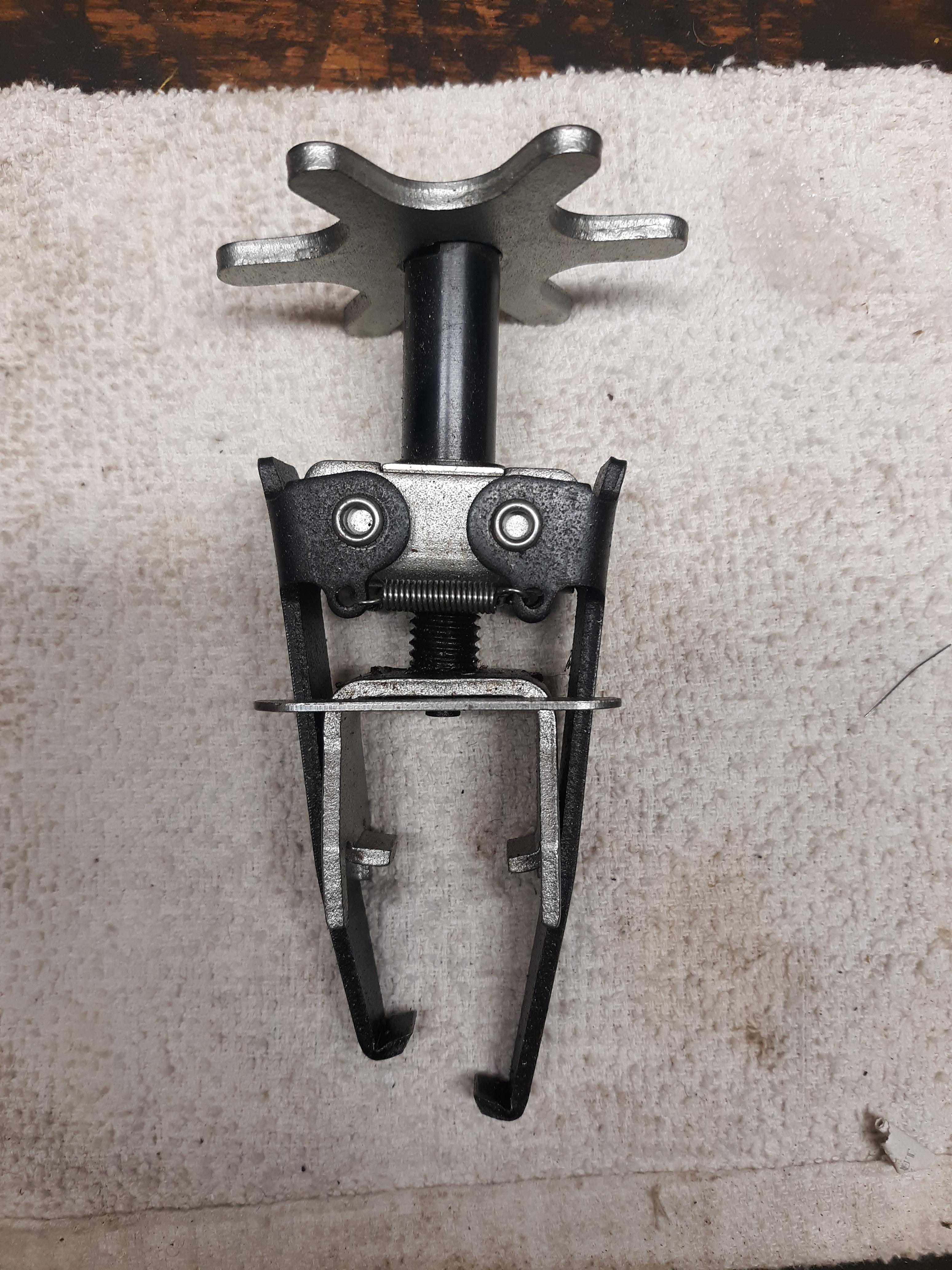

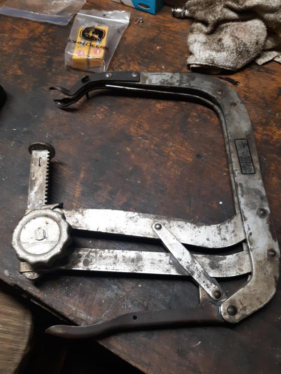

May 12, 20213 yr comment_621499 On 5/12/2021 at 3:51 PM, jalexquijano said: Ok. Ill go for it. Hope i dont mess the engine. I thought that since i bought the whole kit of valve seals taking the head out and replacing them was better. The only reason I see removing the head is if you plan on taking it to a machine shop and have the work done. You could drive it to your mechanic and have them replace the seal or seals without removing the head. If you plan to give it a try yourself the valve spring tool would be much cheaper for head ON replacement. The one I have for head OFF is expensive and harder to find. Question for the gang as I'm not sure if one of these would work or not. I bought it for something I cannot remember what though but I've pretty much only worked on Zs since the late 80s. I know the cam style copressor is the easiest but wouldn't one of these $20 compressors work for one seal? Edited May 12, 20213 yr by siteunseen Link to comment https://www.classiczcars.com/forums/topic/62317-random-misfire-while-cruising/?&page=12#findComment-621499 Share on other sites More sharing options...

May 12, 20213 yr comment_621525 Has the ring around the bottom or top of the seal somehow come loose or slid out of it's seat? I think that cheap compressor would work. Hook the bottom hooks on the lowest ring of the spring and the upper on the retainer. Use a small telescoping magnet to catch the valve retainer clips. I think it could be done with a big socket on the retainer and rubber hammer, magnet to catch the clips. I've read that before. Good luck with it Alex. Link to comment https://www.classiczcars.com/forums/topic/62317-random-misfire-while-cruising/?&page=12#findComment-621525 Share on other sites More sharing options...
