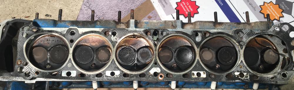

Yeah, Put a hotter plug in #4. It's a band-aid but it may buy you some time until we discover WTH is going on. Is the dark color on #4 plug oily, smell like fuel or is it dry carbon? I'm beginning to suspect a bad valve guide or valve guide seal on #4 if the colorization is oily. Looking at your latest pic of #4 it looks like the plug is trying to fire (clean near the center electrode) but is being overwhelmed by either fuel or oil. Fuel can be crossed off the list so it is likely oil. One more test please. Pull #4 plug, put the wire on it and ground the plug (With an insulated gloved hand) while turning the engine over with the starter. Watch the spark and note the color. It should be bluish, not yellow and you'll probably be able to hear it.

I am of the very strong opinion that you have oil coming down your valves or past a point on your head gasket. Once my” professionally” rebuilt head by a UK “specialist” came off, we found that one of the head bolts was not put in properly and oil was going down the bolt, feeding oil nicely into 3&4.
Do you get any blue smoke out of your exhaust? On my engine I found that if I let it idle for a while then blip the throttle, I got a lovely puff of blue. Typically that is head related not ring related.
Check your valve clearances, check the torque on your head bolts and look to the valve seals / guides as a potential cause.
Look at the plug on no. 4 in this pic compared to the rest!! Then look top right from no.4 and you will see the oil around the offending head bolt hole.
