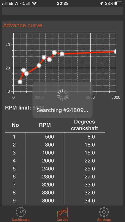

June 18, 20195 yr Author comment_577935 So I wanted to share one more thing for interest, feel free to shoot me down. Given that a lean mix needs more time to fully burn, it stand to reason that an oxygen starved over rich mix also needs extra time to burn as fully as possible. To put this to the test a few weeks ago, I used the 123 ignition to conservatively add a few more degrees at the dips building up to the troughs and then back again where the engine comes to life again. Ignoring the anti-stall peak at 800rpm -which works brilliantly BTW - I call this my twin peaks timing advance (but sadly no Sheryl Lee - am I showing my age again!?) ... The butt dyno told me that no longer did I feel a dip in power but I felt the dips behave more like flat spots. The flaw in this of course is that it is fixed regardless of throttle position or engine load. So at part throttle, I would have more timing than would normally be there - hence the conservative approach and not whacking it up by 5 or more degrees (above trend) at each point. But I like the fact that it worked. Why? Because I’m a middle aged man in suburbia with 2.4 children, living the dream! Some men have golf, I have my carbs and my timing curves! Link to comment https://www.classiczcars.com/forums/topic/62336-playing-with-my-zt-su-carbs/?&page=2#findComment-577935 Share on other sites More sharing options...
