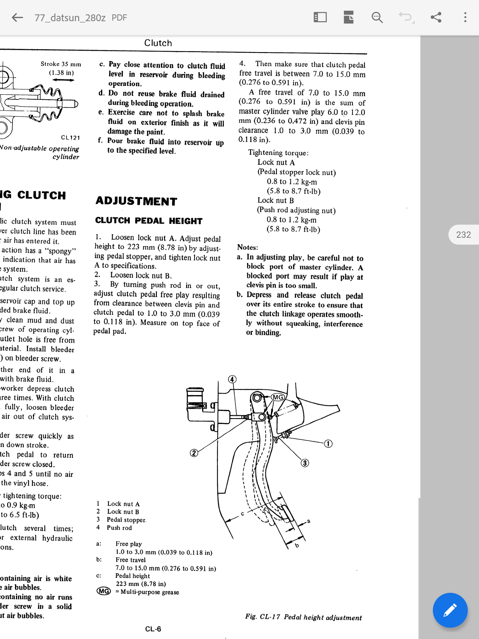

June 28, 20195 yr comment_578479 One trick I've used to verify maximum travel of the master cylinder piston is to adjust the rod so that the clevis pin slides in to the pedal bushing with no effort. If you have to pull the pedal down or push the rod in or pull the rod out to get the clevis pin in then it's not right. While you're there you can eyeball the pin and the hole for wear. I've also used a thread to pull the clevis pin up to the hole so that I can finagle it in the rest of the way with a screwdriver. I can't get my hands up there. Link to comment https://www.classiczcars.com/forums/topic/62337-78-280z-idle-problem/?&page=5#findComment-578479 Share on other sites More sharing options...
June 28, 20195 yr Author comment_578489 3 hours ago, EuroDat said: I thought the master cylinder was replaced earlier before the clutch and pressure plate was replaced. Now reading post #39 I agree. My internet connection is not the quickest working out of a landcruiser or campsite and I scrolled past it. Chaseincats has a good point. It looks like an incorrect master cylinder push-rod or adjustment. If it has the correct push-rod it should be adjusted according to fsm. See attachment. . Oh that's awesome! Thanks so much for that I'll be sure to try it out and let you all know how it goes! Now on the original topic of this thread I've been running some more tests now that the trans is back in and today I pulled the return line off the fuel rail and ran the car with the fuel pump on and plenty of fuel was coming out of the return line but the car was still smoking and running really rich like it had before. I turned the pump off and sure enough fuel stopped coming out of the rail but the idle cleared right up and it started running great which I still wish I could explain. Since I've replaced the AFM, fuel injectors, fuel pressure regulator, and tried tuning the air-fuel mixture with the screw on the back of the AFM, and ruled out the possibility of a return line clog, how else can I adjust the air-fuel mixture to make it run right? Could this be a problem with my ECM? I didn't think that controlled the ratio but I could be wrong. Thanks to everyone who has replied to my posts you're all awesome I love this community! Link to comment https://www.classiczcars.com/forums/topic/62337-78-280z-idle-problem/?&page=5#findComment-578489 Share on other sites More sharing options...

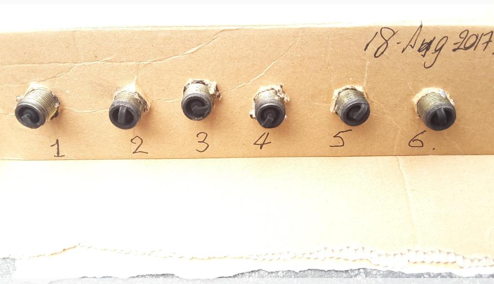

June 28, 20195 yr comment_578497 Ther could be a couple of things causing it to run while the pump has stop. Idling is essentially a no load situation and requires minimal fuel. It looks like (not confirmdd yet) that you have a chronic over fueling issue. You might even have fuel laying around in the inlet manifold. Stop the pump and the air/fuel ratio starts leaning out and it briefly runs better. Well, it's a theory... You NEED to buy a fuel gauge and mount it in the line after the fuel filter. Don't assume stuff. You need to test and confirm or dismiss possabilities. Not doing that will set people on the wrong train of thought and you will be chasing you tale for weeks. Been there, done that, so to speak. The people here can and will help you a lot, but you need to give them solid informatie. Tests you should do asap. - Fuel pressure: If it is a leaking injector or Cold Start Vavle, you can confirm that with the gauge. Ill try and upload a simple procedure I use for testing. Need to find it on my tablet... - Check the spark plugs. That are probably black and sootty from overfuelling. Remove them and stick them through a piece of cardboard with the cylinder number written next to it. Make a photo and post it here. See attachment sootty plugs from a badly leaking cold start valve CSV. - Compression test. Do a compression test and confirm all cylinders are in goed order. It's not that important what the reading is, unless you are reading 75psi on all cylinders.... Most compression gauges are not calibrated accurately showing pressure so 140 could be 160. What you are looking for is variance between the cylinders. They should be (for example) all 135-145psi. Bad would be something like 4 cylinders reading 145psi and two reading 95psi and 110psi. - Read and start doing the tests in the fuel injection bible. There is a very good reason why we call it the bible. Instruction - Fuel Pressure Test 280Z RevB.pdf Edited June 28, 20195 yr by EuroDat found my write up on the tablet. :) Link to comment https://www.classiczcars.com/forums/topic/62337-78-280z-idle-problem/?&page=5#findComment-578497 Share on other sites More sharing options...

June 28, 20195 yr Author comment_578530 6 minutes ago, Dave WM said: finally got around to testing how long an engine will run with the fuel pump off. My setup on the test stand (which has much more rubber hose, no hard line but for the fuel rail) will run for about 13 seconds. You can tell its off after about 2 seconds, then itl struggle for the last 11 or so second till it dies. This was at idle of course. I like the theory of a pooling of fuel in the manifold for any kind of run on longer than that. Still have doubts about 8-10 minutes (think that was what was said). Kind of pointless to keep talking about it, you have to get the fuel pressure gauge and start going thru the process. I only brought it up since I had said I would check the time a engine would run with the pump off, on my setup. I’ve been messing around with the car and it’s stopped doing that, couldn’t tell you why, but I’ve discovered a few things: one is that my newish plugs are filthy black and two that my CSV is broken but in addition to that the engine runs amazing with the CSV removed and the hole it went into left open, although it idles at 2,500 when I do that. It also starts to die if I open the throttle at all. I’m going to run a compression test next but hopefully this info can help lead to a solution. Link to comment https://www.classiczcars.com/forums/topic/62337-78-280z-idle-problem/?&page=5#findComment-578530 Share on other sites More sharing options...
