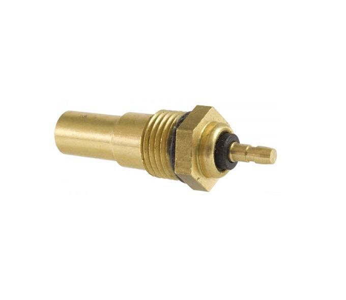

Quick question, which of these would be my coolant temp sensor, I’ve been looking at diagrams and none of them look like what’s depicted or what I got from rockauto. Also the clutch fork is about 4.75 inches or 120.65 mm from the front of the bell housing.
That green top thing in your hand is a Coolant Temperature Switch/sensor.  The Coolant Temperature Sensor for the temp gauge looks like this and uses the bullet connector.

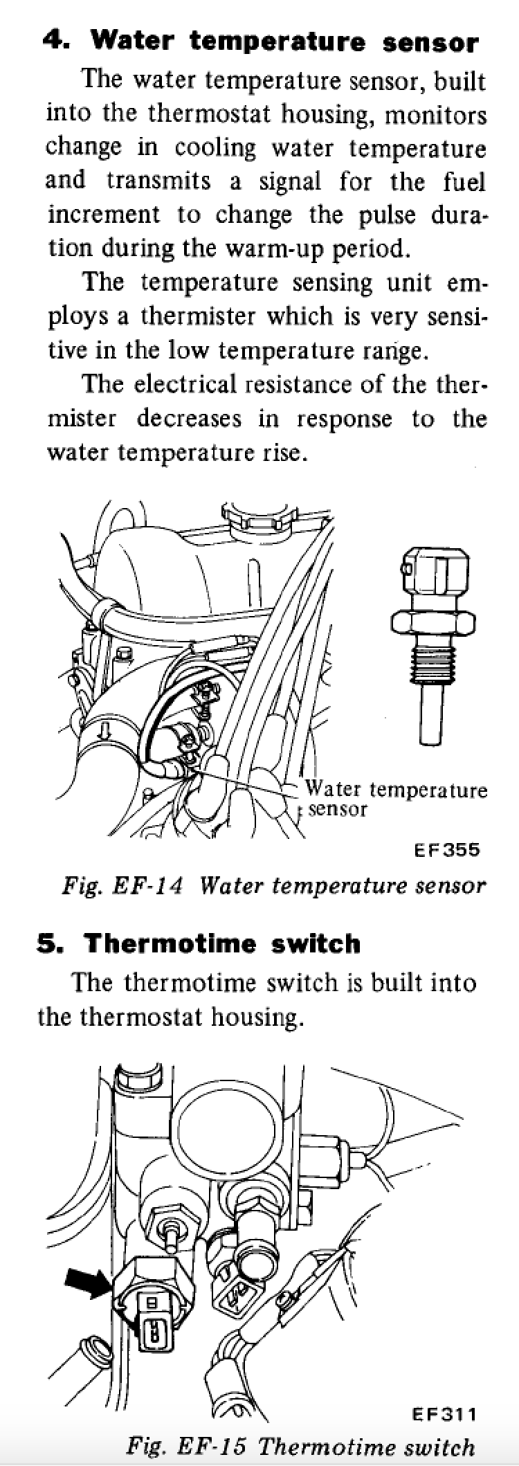

the green thing is the "water temp sensor" often mentioned as the CTS, it for the EFI, the single bullet connector item  is the "thermal transmitter", its for the gauge in the dash, nothing to do with the EFI.
I am using the descriptions from the FSM.
The "water temp switch" is a NC switch that opens at about 160f has different functions, on my 75 it controls the EGR activation (EGR not active until the motor warms up). On others it changes distributor timing of the spark module. Perhaps use other places but NOT part of the EFI. You did not picture it but its got TWO leads that come out of it (the only device that has leads) that are terminated with bullet connectors.
there is also a "thermo time switch" This one is both a heater and switch. the switch only closes at temps generally less than about 65f, and when active will only stay closed for about 9 seconds regardless of temps (the internal heater prevents it from staying closed too long). Its function is to add enrichment of fuel for cold starting. Not tied into the ECU its operated solely by the ignition switch. It is the largest of the sensor, mounts on the front of the housing. The sub harness for connecting the CTS and the Thermotime are color coded, but can be interchanged. IF they are not connected properly the EFI will not work as designed. Its important to make sure those two are connected to the right sub harness and that the sub harness bullet leads are connected to the main harness correctly as well. The sub harness has color coded tape near the bullet leads that match the main harness color coded tape. the ends of the harness that plug into the sensors have slightly different colors, perhaps they were more pronounced when new but they are different. I presume they matched with the plastic color of the OE sensors.

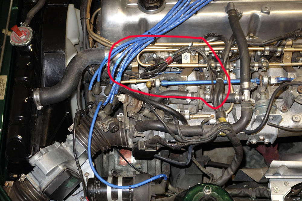

Here’s another angle, it looks like my water temp sensor isn’t connected to anything as you can see the wire with exposed bullet connector just hanging. I don’t see any wires around it that would connect to it but something tells me this might be why I’m running rich. Any idea as to where the wiring to the temp sensor originates?
The sensor with the bullet connector is the one for the temp gauge. Those sensors mounted in the thermostat housing connect to the harness on top of the intake manifold here.DSC01375 circle.jpg
Here is a little more explanation from the FSM in the EFI sectionScreen Shot 2019-07-13 at 10.10.57 PM.png
