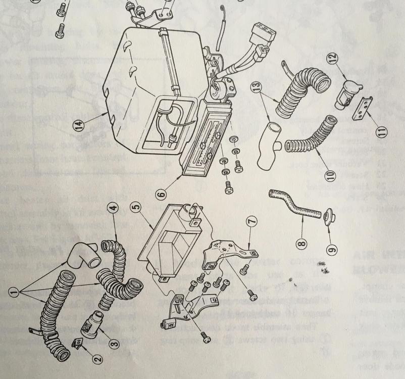

Thanks again!  This diagram looks a bit different than my memory, but then again my memory is not always accurate.  It would be reference #4 or #10.  Not sure if your 1975 is identical to my 1978 but many of the illustrated parts look very similar.  Is that the factory parts illustration you have?  I was using CARPARTSMANUAL, especially when I was working on our 1968 2000 roadster for parts illustrations and numbers but on my last check on that website it came up with some CRITICAL ERROR ALERT and was not able to access the website which also had the Z cars, 510, and some other Datsun vintage vehicles.  I am quite a computer dummy when it comes to navigating, downloading, etc.  I guess I am a dinosaur and still prefer a paper copy in hand.  Thanks again, John.  I will be researching and tracking down those part # you provided if time permits today.

3 hours ago, captahole said:
What is part #3? I seem to be missing that
Good question, I don't remember seeing that before, I'm guessing #3 and #12 are the same part.
You won't find those on an early, but my 260Z has those outlets. (had. I have them but they're not currently installed) and my son's '76 280Z has them. Both are factory A/C cars. I don't think those are installed on Bob's '75 280Z museum car. It doesn't have factory A/C.
