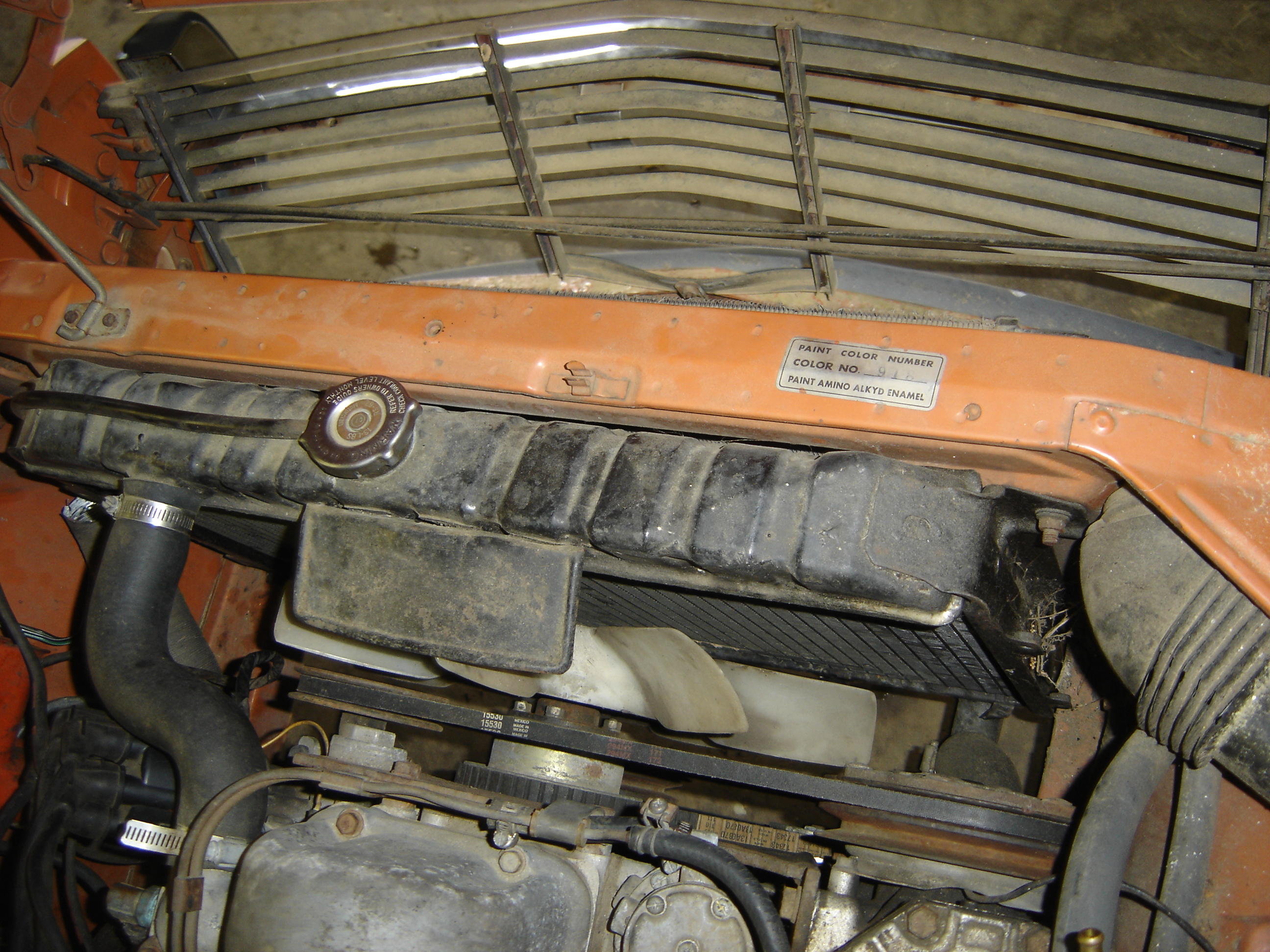

Below are a couple pictures under the hood.  The first one shows the passenger side area.  I see the Freon hoses that jfa mentioned.  Shouldn’t the compressor be in this area?
The next one shows the upper pulleys.  There is not a belt that engages either one of those upper pulleys???
Thanks again for all your help!!  Tom

Go back to @siteunseen pics.  The top one shows the typical single idler pulley, the second shows the York compressor - its difficult to make out the bracket but its there.  For reasons unknown, your car has a second idler pulley close to the fuel pump but the bracket and compressor are gone.  Belt and suspenders???  As Cliff says, it makes no difference because the tin-can fuel pump would prohibit installation of the York mounting bracket.  Recommendation: remove the two idler pulleys from  your engine and start with a clean install of a late model A/C system - you really need it down in H-town.  Just my $0.02 worth.
PS - good looking engine compartment!
