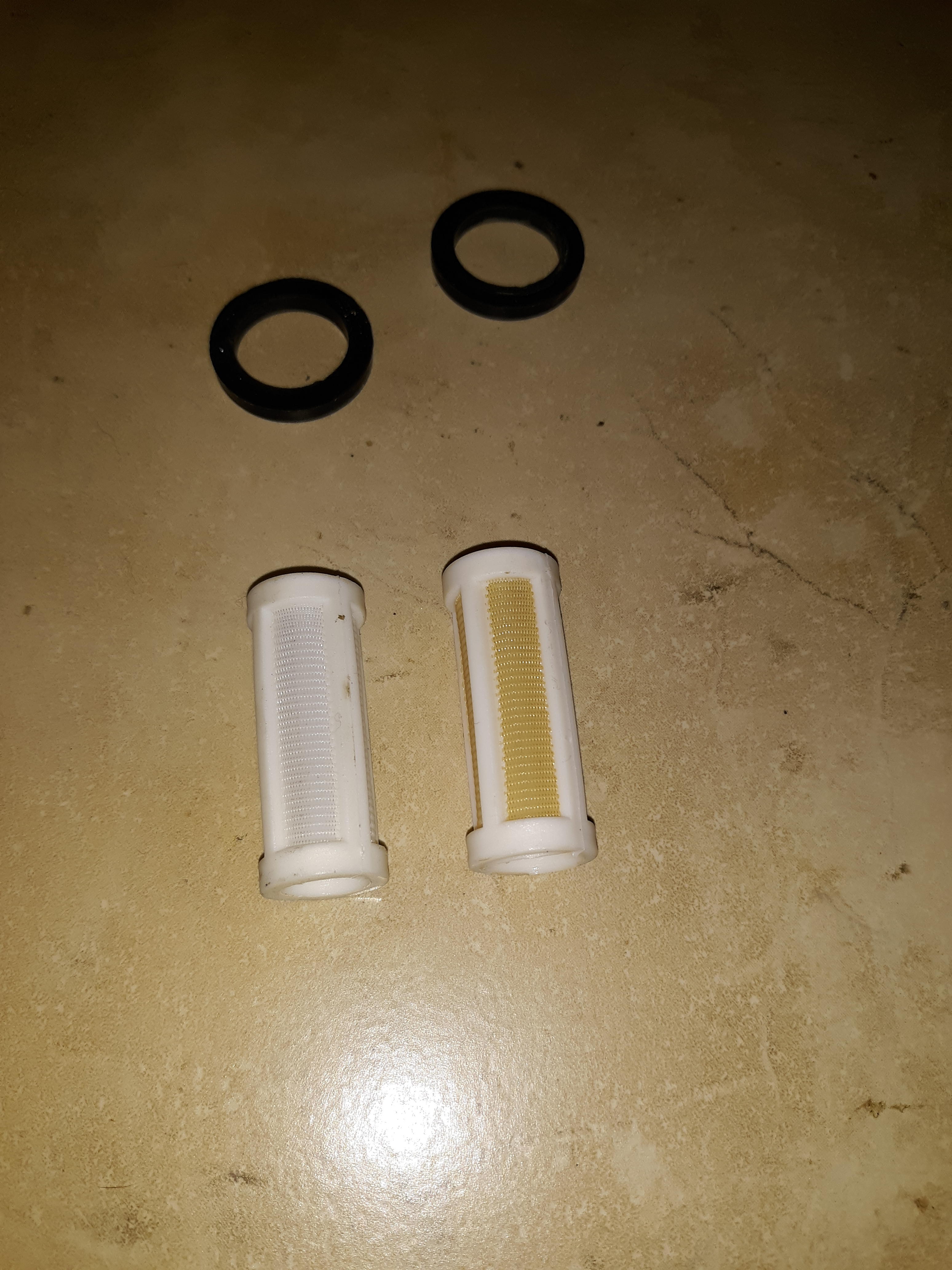

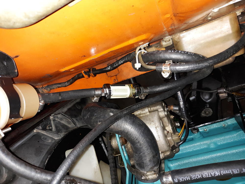

Posted June 20, 20196 yr comment_578070 In 2015 I cleaned then coated the fuel tank on my 240. Today I put a new screen in the low pressure glass filter that I use. Nothing even close to pink from the Red-Kote, yea for me! Link to comment https://www.classiczcars.com/forums/topic/62364-glass-filterred-kote-results/ Share on other sites More sharing options...
June 20, 20196 yr comment_578080 On 6/20/2019 at 8:43 PM, siteunseen said: Today I put a new screen in the low pressure glass filter that I use. Cliff, remind me to tell you some day how I almost burned my car to the ground because of one of those stupid glass filters. Throw it in the garbage where it belongs. Link to comment https://www.classiczcars.com/forums/topic/62364-glass-filterred-kote-results/#findComment-578080 Share on other sites More sharing options...
June 21, 20196 yr comment_578104 They don't filter for squat either. On 6/20/2019 at 10:41 PM, grannyknot said: Throw it in the garbage where it belongs. What he said. Link to comment https://www.classiczcars.com/forums/topic/62364-glass-filterred-kote-results/#findComment-578104 Share on other sites More sharing options...

June 21, 20196 yr Author comment_578129 On 6/21/2019 at 2:40 PM, jonathanrussell said: My tank hasn't been restored though so not sure I would use a filter if it had. I'm kinda weird I guess but I like to see the fuel to make sure it's not colored any shade of red from the tank lining. My car sits for months without being cranked much less moved to slosh the fuel around inside the tank. I have a Fram G2 out of the tank, the glass one then the OE mounted on the inside fender. Another neat thing about those glass filters, when my float levels were off that thing was never completely full. After a painstaking week of getting the floats right that filter has always been completely full. If I see it's not full and filling itself up as the car runs I will revisit the float levels. Link to comment https://www.classiczcars.com/forums/topic/62364-glass-filterred-kote-results/#findComment-578129 Share on other sites More sharing options...
